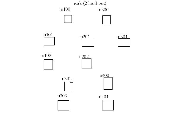

I don't have the schematic for the 800.4 but the 800a4 should be close enough. If they're the same, the first ICs in the signal line are U100, U200, U300 and U400. If you have no way to listen to the signal (signal tracer) or view the signal (oscilloscope), you can check each one to see if any one of the 4 is running hotter than the others.
If you have a test tone generator or a test tone disc, you could drive that into the amp and measure the AC voltage on the outputs of each of the op-amps (U100-400). You'd need to set the amp to full range, set the bass boost to the minimum and the gain to the maximum. You'd need to drive signal into all of the inputs at the same time or determine which op-amp is fed by each of the inputs.
You could also try measuring the DC voltage on each of the pins of the op-amps to determine if any appeared to be damaged. You would do this with no signal input. If you want to try this first, post a list of the DC voltages on each of the 8 pins of the op-amps. Place the black meter lead on the shield of the RCA jacks for this test. You would need to do it for all 4 op-amps. Look up the datasheet for the ICs (TL072) if you don't know the pin numbering scheme.

ok i have the amp reopened , and im lost....lol
i looked inside and found only oe thing that i think you want me to test the dc voltage on its a tl494c 16 pin.
i found a few 8 pins (4 pins on each side) but there are 11 of them near the rca's and no markings on them at all.
would it help if i took a picture and maybe you could guide me as to what i need to test.
i want to thank you so far for your reply!!
ok relooked and found the marking on the chips , they are the TL IC chips you said.
i could not find a U200 but i did find a u202 and u201???
also i have a crude drawing i did so that you could guide me in what i need to test.
here it is
also i ahve a ton of pics if those will help also.
thank you all for your time.
