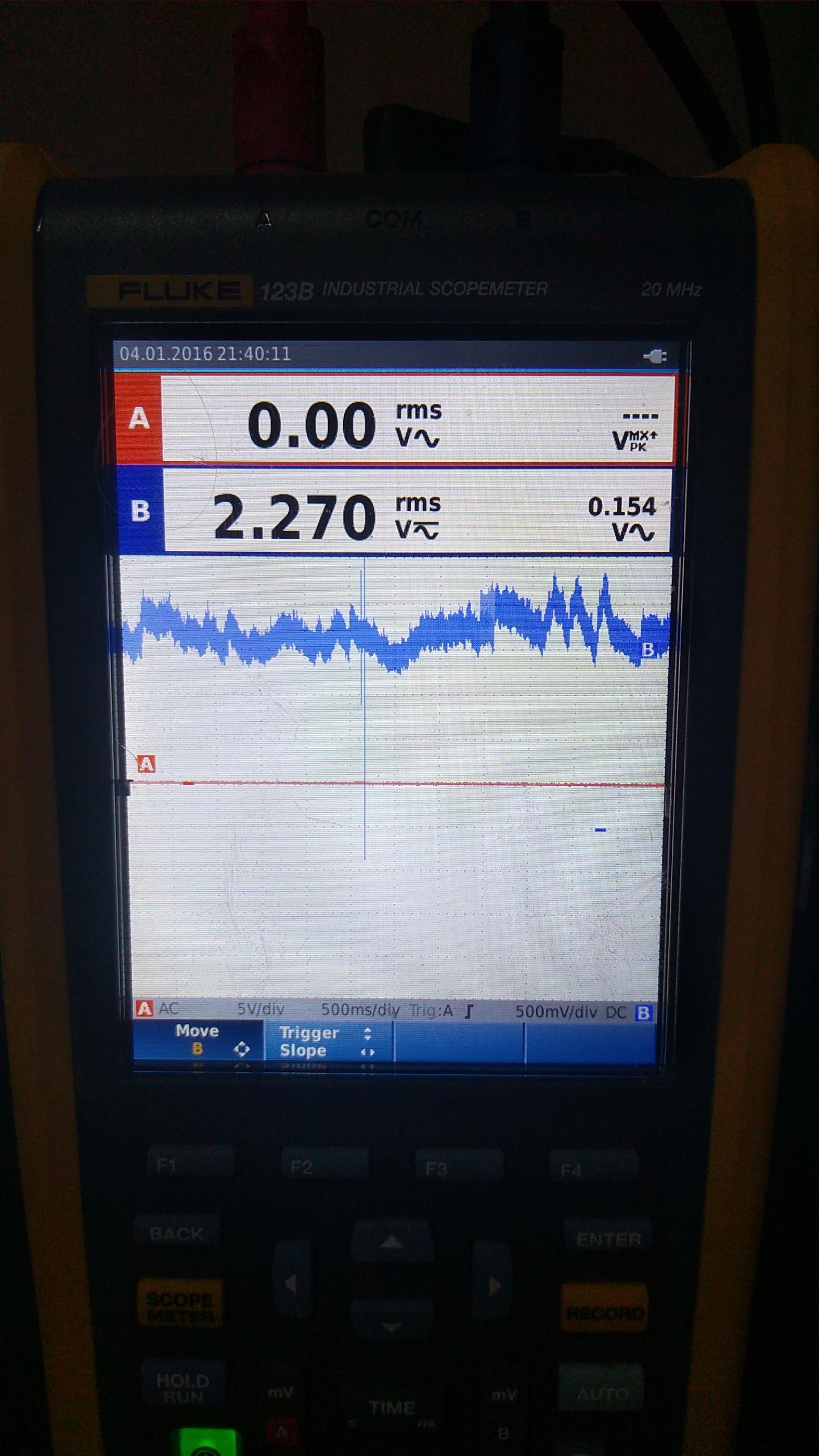

Ok, had a little time to get some tests in. The issue is indeed load dependent. No load, everything look fine. Bigger conductance, earlier issue appearance. It also seems to be frequency dependent as well. The monster comes out above about a volt RMS on the left - terminal at 8 ohms in multiples of about 55-65 hz. Not dependent on input signal vs gain knob.

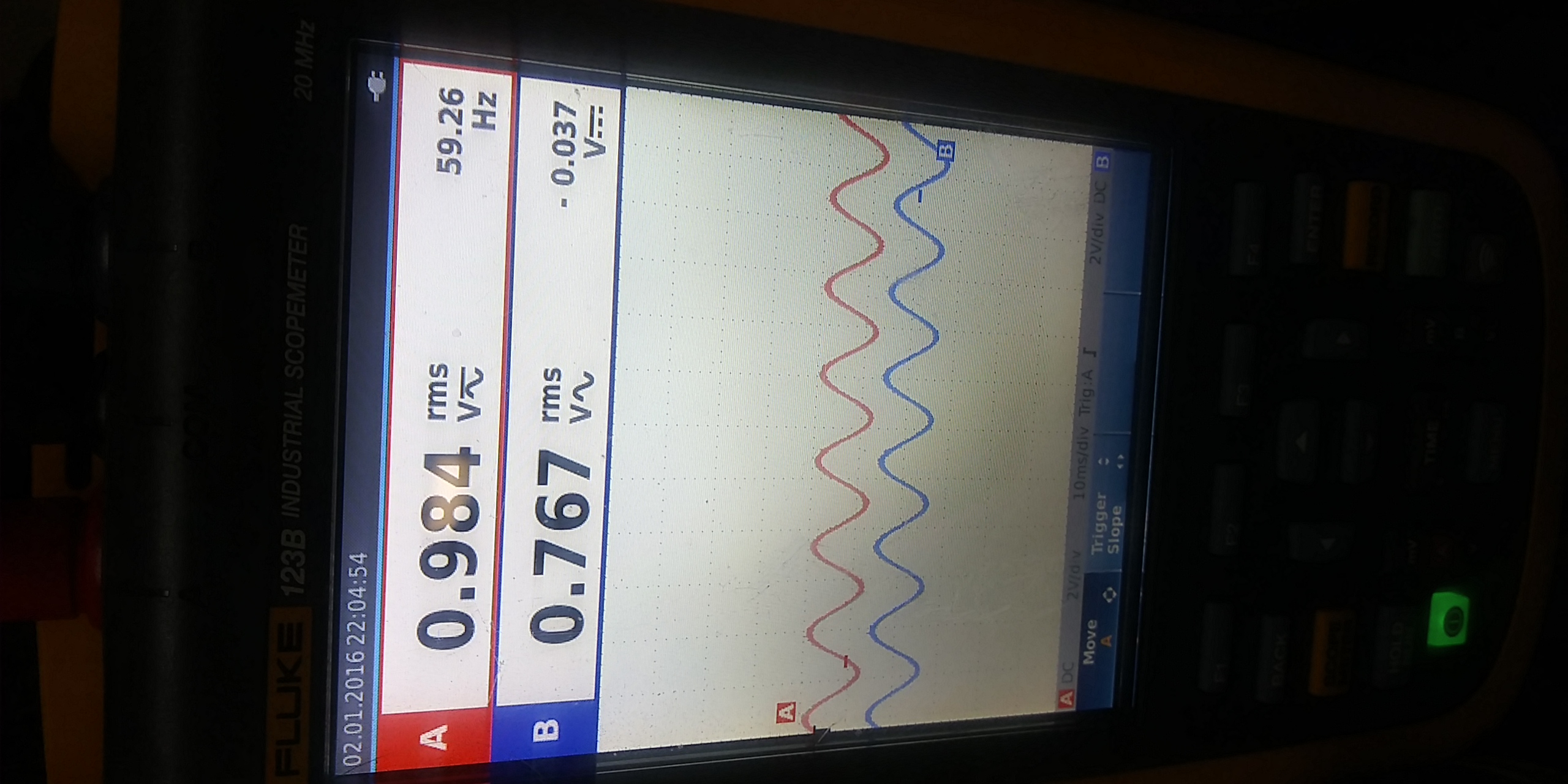

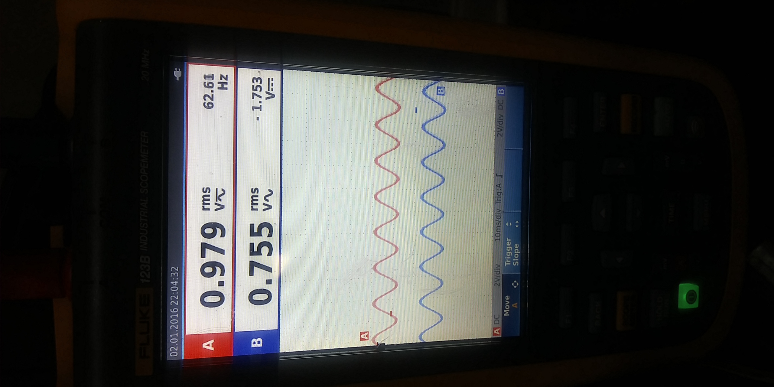

So tracing signal, I found that the LF_CORE signal stays clean at the preamp side no matter what. This can be seen at the C114 side of R163. On the other side of R163, mayhem. Following the Q111 side of the circuit.
I'm assuming that you're comparing the 100 and 200 series circuits.
Try driving the signal into the 100 and 300 series channels. How do the signals compare on the cap side of the resistor?
The 100 and 300 series channels are a better comparison because both are inverting channels.
On the 100 series channel, try lifting D101 and D102 to see if that makes a difference.
Have you confirmed that all of the source resistors in the 100 series channel are within tolerance?

Trying out the rear bank, I discovered that the schematic is lying! 300 is right rear and 400 is left rear. On the coupling cap side of the resistor, audio signals look good. Shot pics of both sides of the cap and resistor for each channel.
Lifting the diodes gained me some threshold, but the issue still punches through about 5 volts RMS on the output.

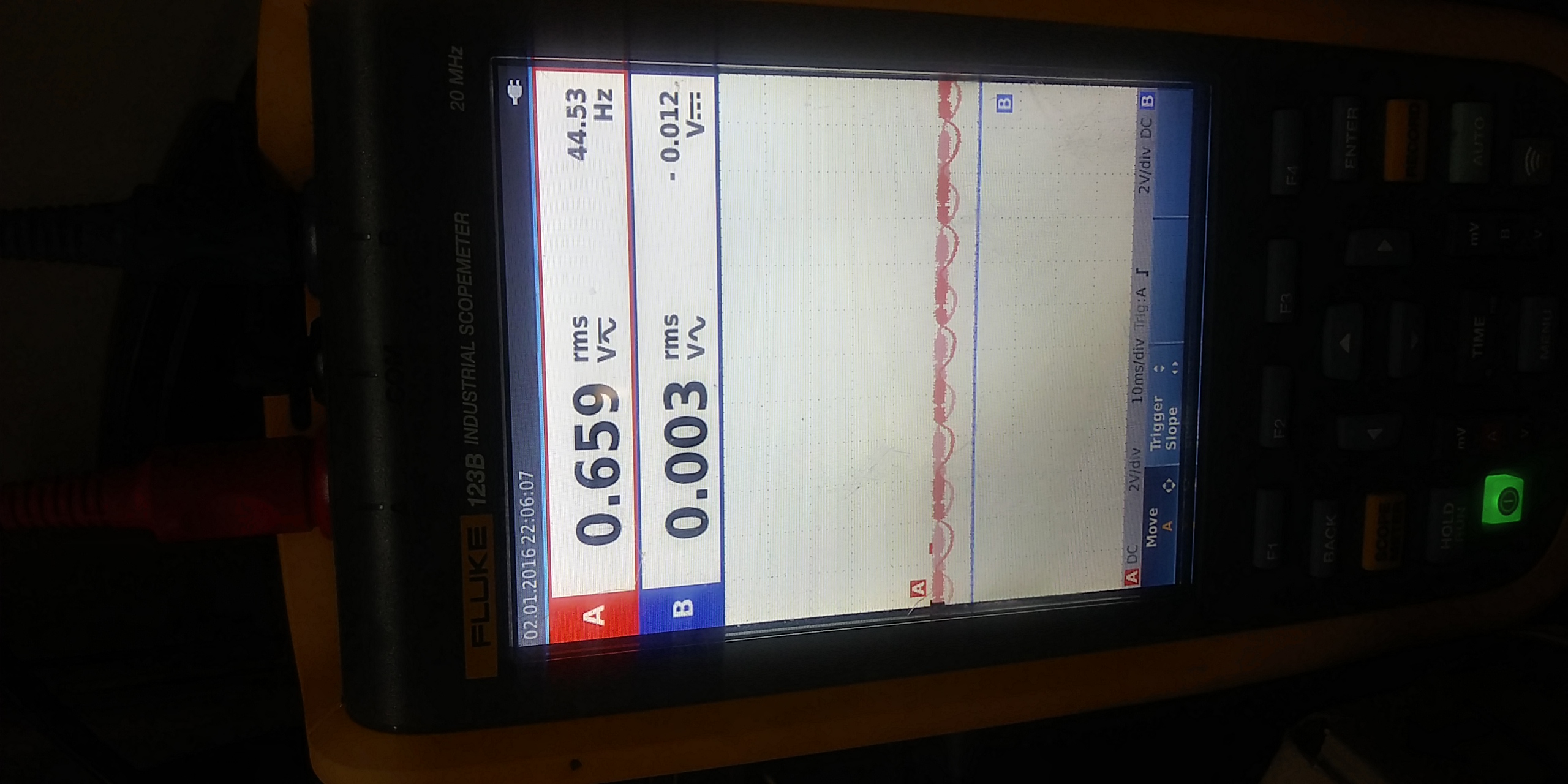

Ok so I went back through the 100 channel and measured all kinds of components and signals and supplies. The power supply rails are good. Little low because I'm running this amp from an atx power supply, and it's rock steady at about 11.8 VDC. HV rails are +-26 VDC, 17 volt rails are 13.6v and -13.1V. Touched up some questionable solder joints and such.
Double checking the lifted diodes, I found that D102 wasn't fully free. So my previous observation was incorrect. Then I lifted D102. Now, when I power up the amp, I have positive voltage on the output lead ( left front -). It's wandering around between 1.5 and 3 volts. See attached picture. Q111 is getting warm as well.

The audio circuit functions without D101/102 in the circuit. They clamp the audio in case of over-current through the output stage.
For the regulated voltage, confirm that the voltage measured from output to adjust is 1.25v. If it is, the voltage is likely OK.
What is the measured value of R149 and R136?
Are R137, 138, 150, 151 within tolerance? You will have to desolder one leg of the source resistors to confirm.
