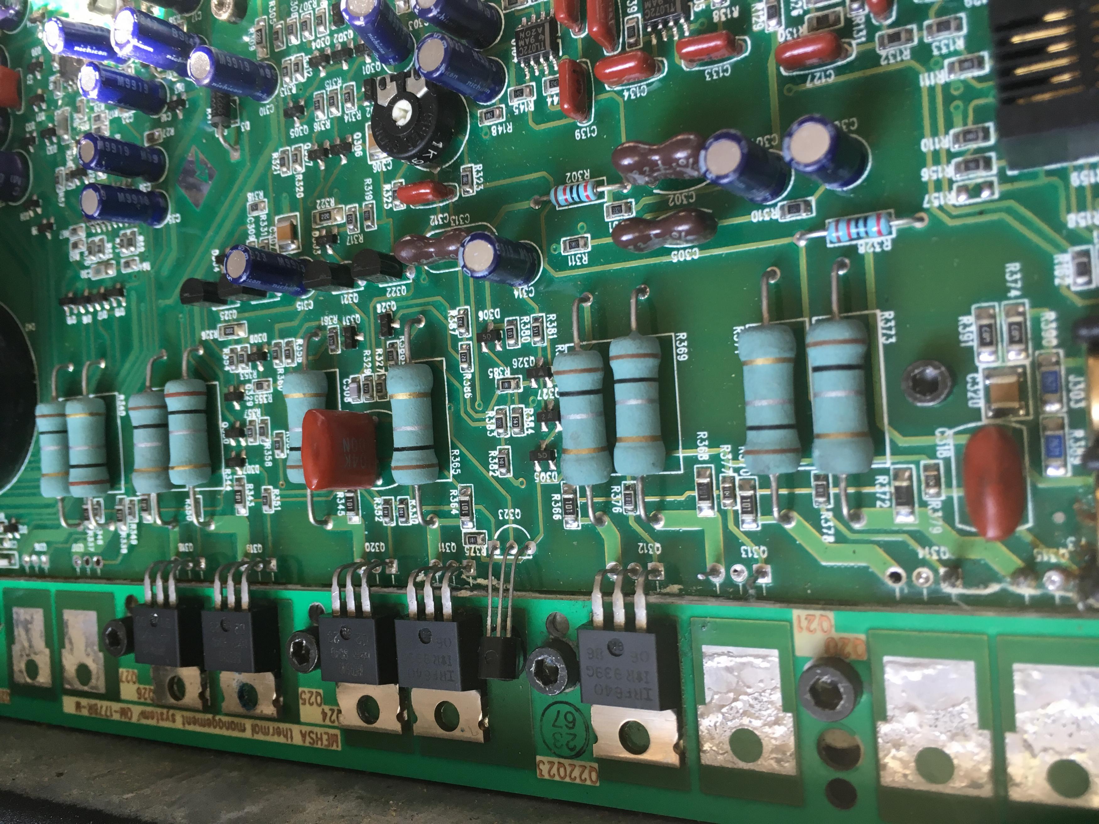

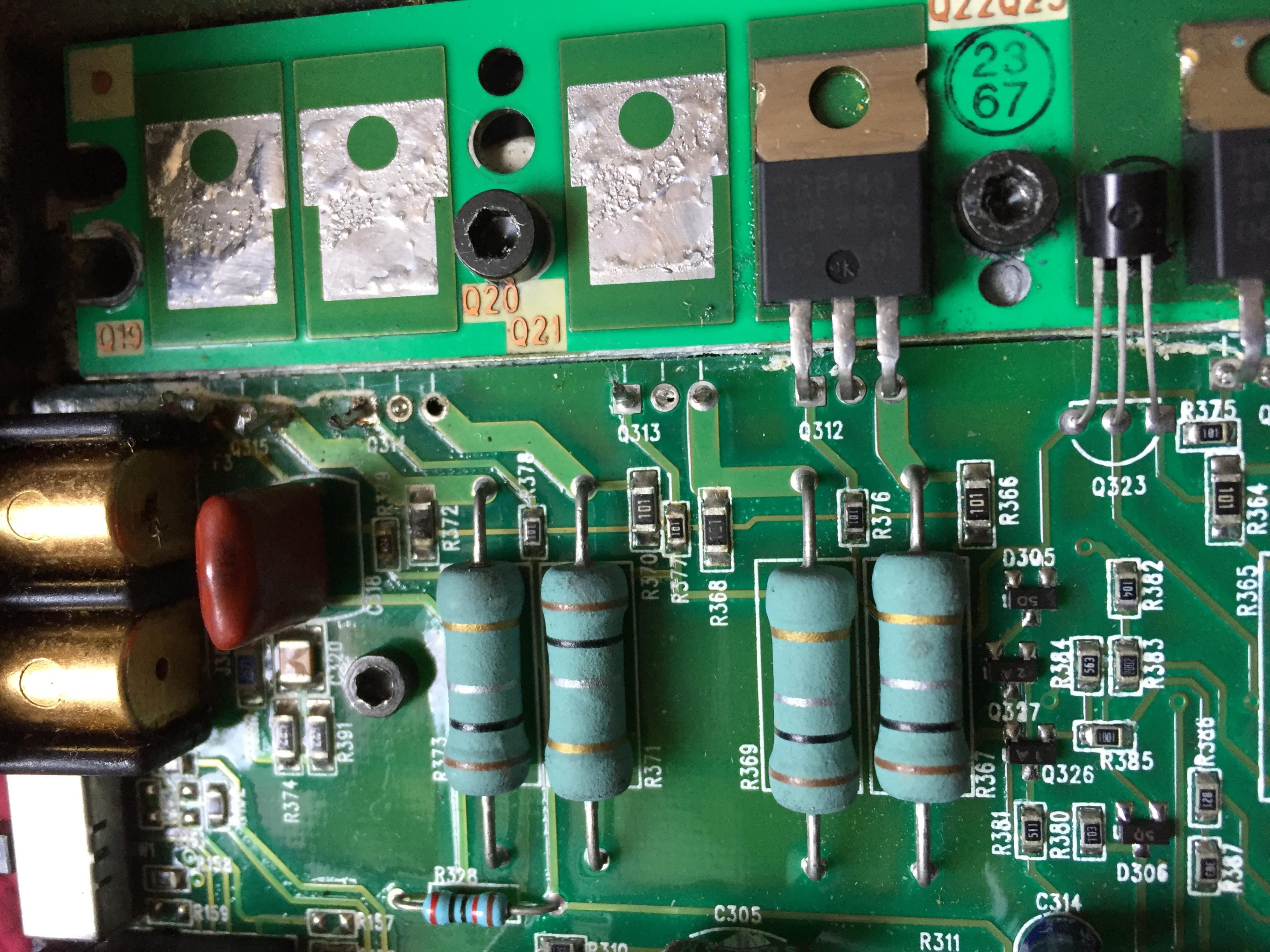

I have a 1000a2 with one channel that was shorted. I removed some parts that were causing the amp to blow fuses. Now it turns on and plays audio clear from both channels. Any way I plan to replace all source resistors and output fets. What size would R368, R370 & R372 and so on be? There's ten I need to replace as well others that may be out of tolerance. If anyone can tell me ohm and size of resistor case and where to buy. Thanks any help greatly appreciated!

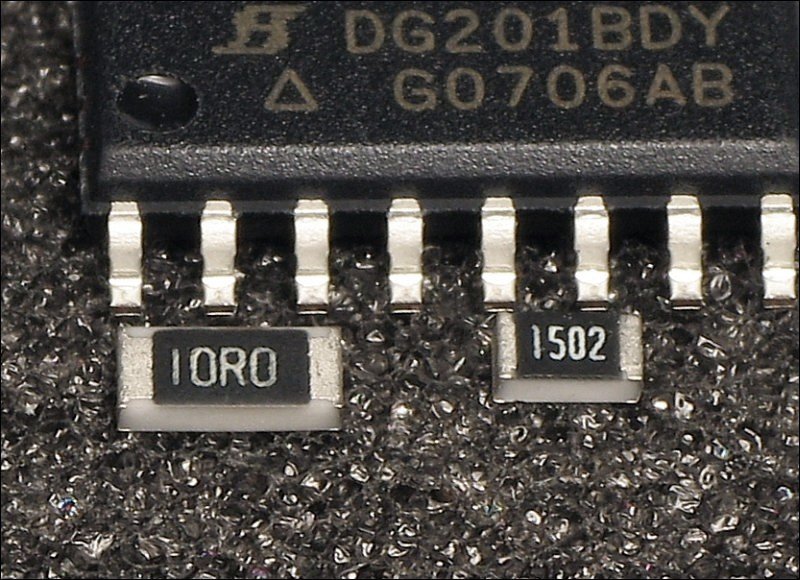

You need to buy a dial caliper. You can estimate by placing the resistor next to an SMD IC. The larger is 1206. The spacing between terminals is 0.050"
The smaller ones on your board are 0805. The next size up are 1206.
