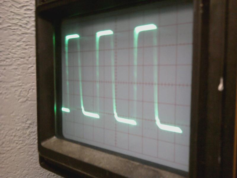

So can i lift the legs of the STRP15's to see if the current draw is from the power supply or output section?
Is the diagram you sent the one Rockford sent you? It's not the same board number.
Connect only remote and ground. What do the pulses on the power supply FET gates look like?
Yes its the one Rockford sent me i told them the board number and i also told them the serial number off the board..
And they told me its the same schematic for all the Punch 800A2's
I have to find a camera since mine is broken and ill get back to you..
Set the trace (no input to the scope) to one major division from the bottom of the display. Set the coupling to DC instead of AC and post another image of the waveform. Unless there is a good reason to use AC coupling, you should always use DC coupling. Try to take the photo at less of an angle.
