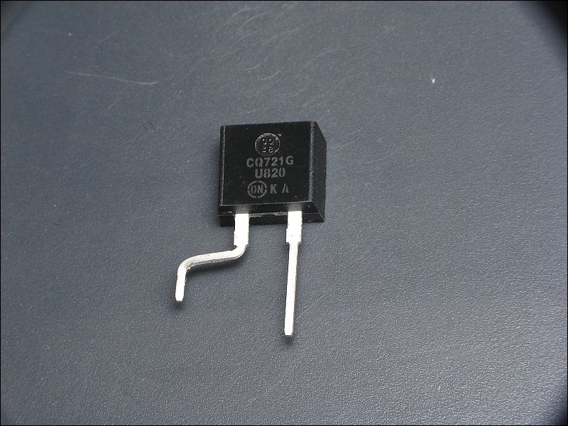

The diode is marked 28-150 its gray with a black stripe.
Wondering can i use a cross for this diode??

That's a BYV28-150 and is difficult to match (for durability) with anything of a comparable size. If you're not going to use an exact replacement, I'd suggest using something like an MUR820 bent similar to the one in the following image. The left leg in the photo would be the same as the striped end of the original diode. If you use this as a replacement and the tab has to be cut off (for clearance), do so before you install it.
well i had to order the original part. I order 10 of them from newark since i didnt have either one in stock. Plus wanna try to keep it original since its a customers amp
