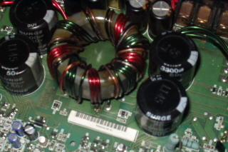

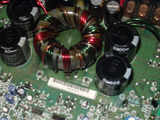

Further checking in this amp it looks like the torriod got hot at one time and melted the coating off one of the leads.
So wondering where do i go from here?

Looks like the torriod got hot at one point it melted the coating off one of the leads.
Wondering where do i go from here

Is only one turn damaged or do you have multiple turns damaged on the transformer?
Can you post a photo of it?
I can't see enough detail on the transformer.
If only 1 winding (the terminal winding) is shorted, you may be able to desolder it and insulate it with heatshrink tubing or Kapton tape to prevent it from shorting. If there is more significant damage, you will have to get a replacement transformer from Rockford or rewind the one you have.
