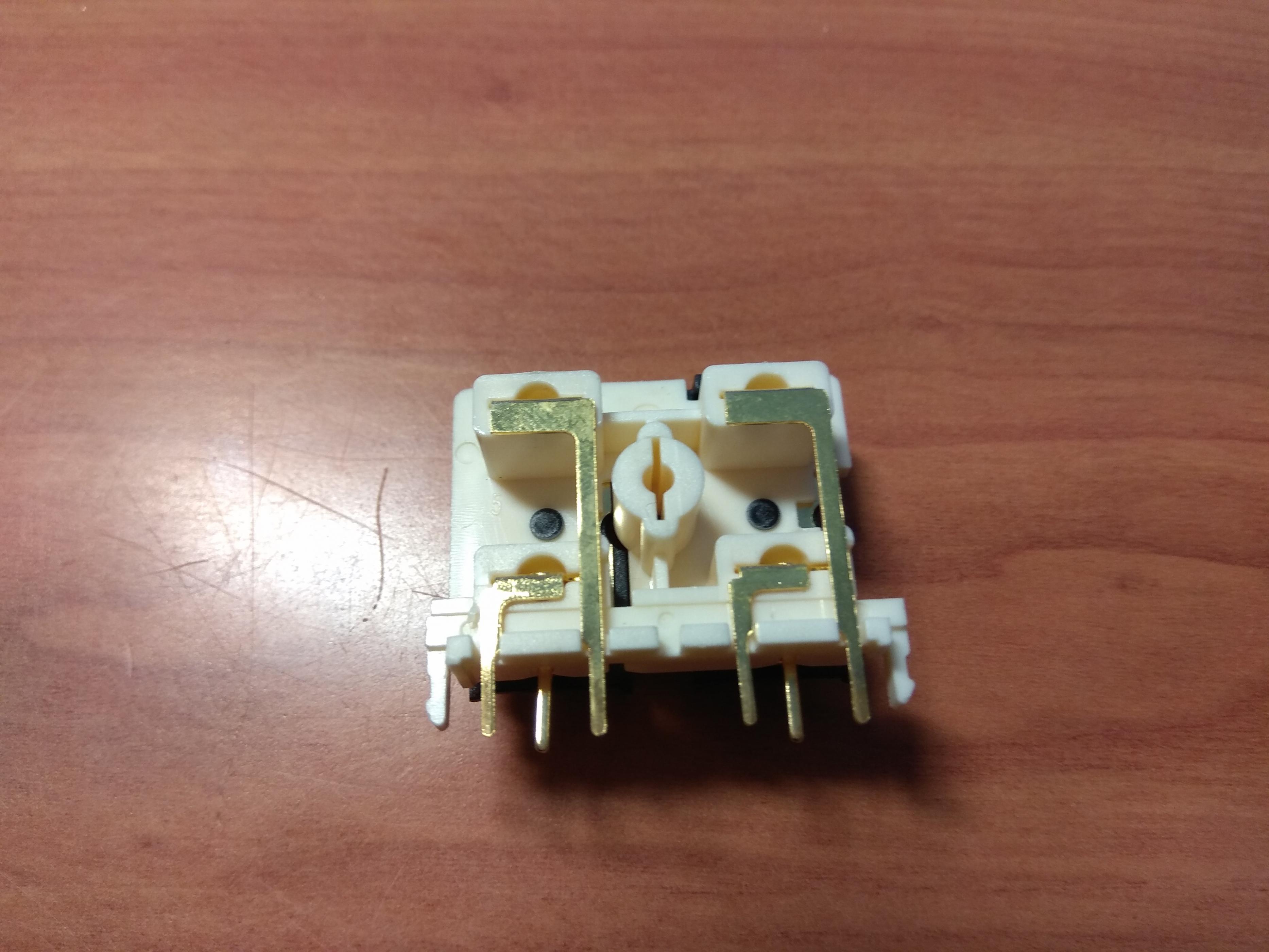

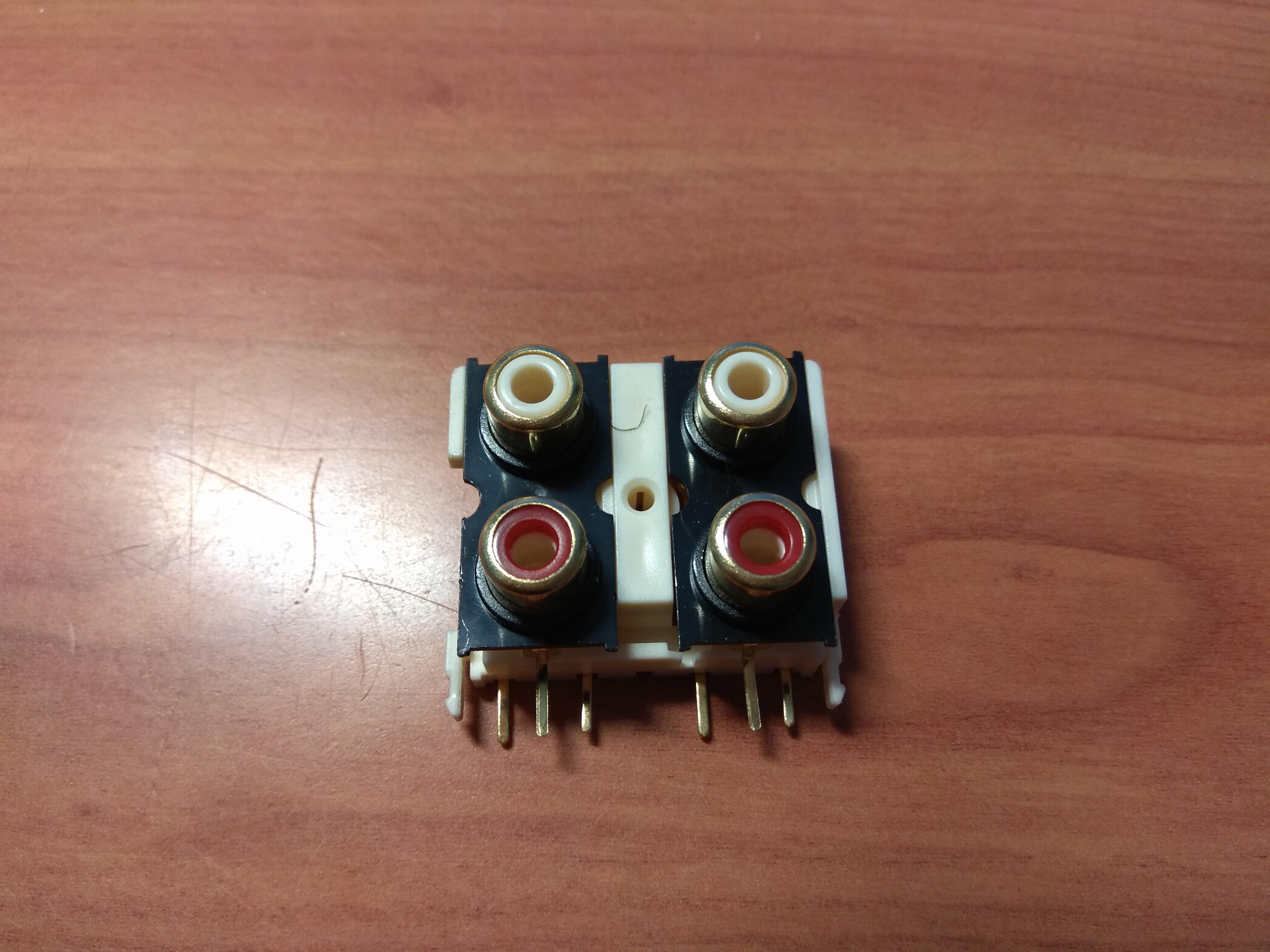

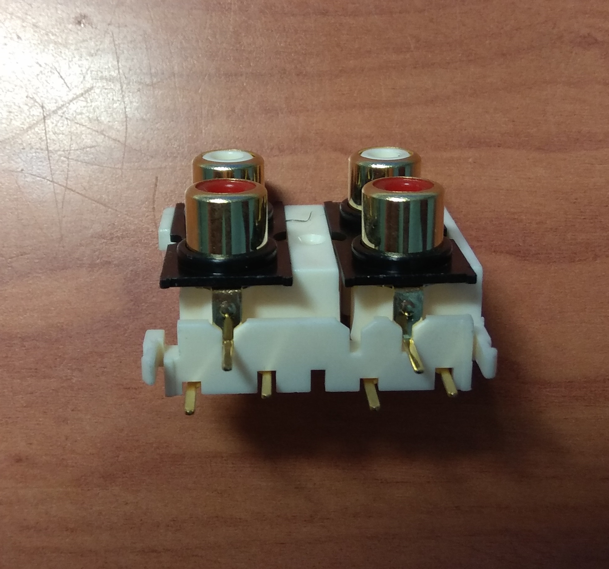

yes, mines does not have ground pins. your part has soldered pins.
there´s no soldering on original part, maybe has been just spring loaded connection
last person who soldered rca part ripped board.
i think i´ll be just fine fixing rca part
The RCA connections are all soldered. There are no spring loaded connections. All RCAs have ground pins soldered into the board.
what is so strange for you? the 2 GND legs are ripped away. both of them was there place but after long time and use of the rca cable connectors they ripped out.
you can take leg of resistor or diode and solder it to the point it ripped and you have "brand new RCA socket"
Yeah have to fix thru-holes cause connections between sides are gone and after i solder that pin there is atleast trace left from soldering
You can jump the shield grounds on the bottom of the board. Do the other two traces go anywhere on the top of the board?
