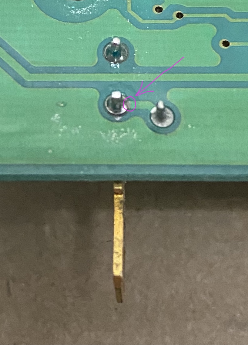

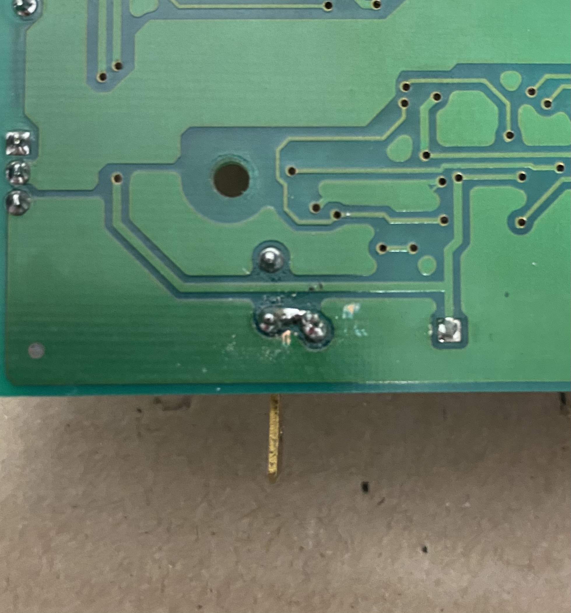

I have a Rockford Fosgate 240x4 that will not power up. I have checked all the outputs and powersupply fets are good. Amp seemed in decent shape. However, the U1610 and U1620R had burn marks and were missing the 2.7ohm resistors. I have applied power to the remote connection and connected the ground and only have about 0.412 vdc on the powersupply center legs.
Perry I just found my problem working the schematic backwards for vcc voltage. I starting to lose my eyesight thank goodness for magnifying glass and zoom. I had a broken trace at the remote connection.
