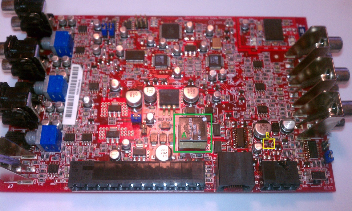

I have two Rockford 3sixty.2 modules that had separate problems. One of which I have successfully repaired but the other one needs a few parts replaced, two of which I cannot find part numbers for.
If anyone can help me find replacement components I would be very grateful.
The first and most important component, labeled "A" in the attached pictures, I believe is a transformer but not positive. I cannot find anything when searching for part number TSD-2083 and I do not know what else to search for. I damaged it while running a test and my probe slipped.

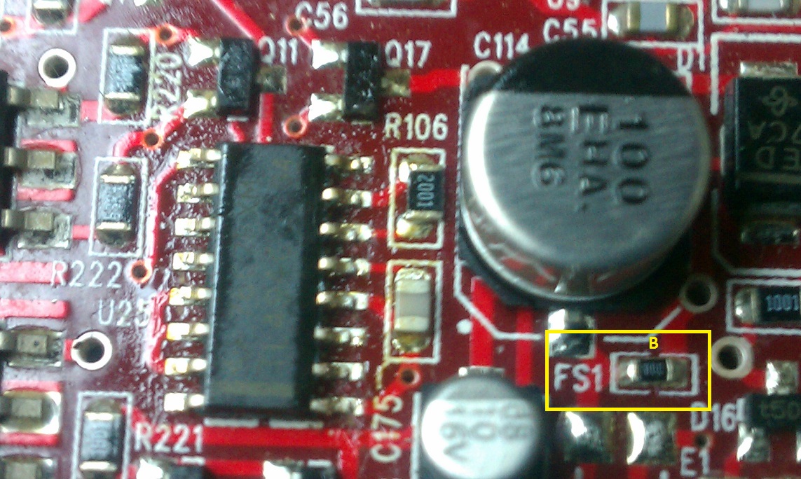

The second component, labeled "B", I am unsure what it technically is. It is a 0.0 ohm resistor that breaks (permanently) when voltage is applied backwards, like a protection device. I can solder a wire between the contacts and this part will work but that will put the expensive board at risk. Also the component is only about 1 to 1.4 mm in length (for reference).

Rockford may stock the transformer. Check with them.
The zero ohm resistor appears to be a 0603 sized component. Any electronics distributor that sells SMD parts should have that in stock. Confirm size before ordering.
I called Rockford and it sounded like they have the parts, but of course I'm not aloud to buy them because they are still doing in-house repairs on this unit and won't sell them until they stop running production. Any other suggestions for where I might find a replacement?
After a little more probing around, I don't think the transformer is bad. Since I have a working 3sixty to reference while I probe, I am going to try to replace a few other components that gave funky readings, most of which I have found good replacements for from Mouser, however the two components shown in the picture I am clueless on what to look for.
MMBT3904
MMBT3906
These are the components you have in the picture on the left. I cant see the numbers on the right picture.
You could also use....
MMBTA56
MMBTA06
I can get the transformer for you, but currently I am out of stock.
MMBT3906
MMBTA56
MMBTA06
Thank you very much. The ones on the right are the same as the left. I will get these ordered and installed and report back.
