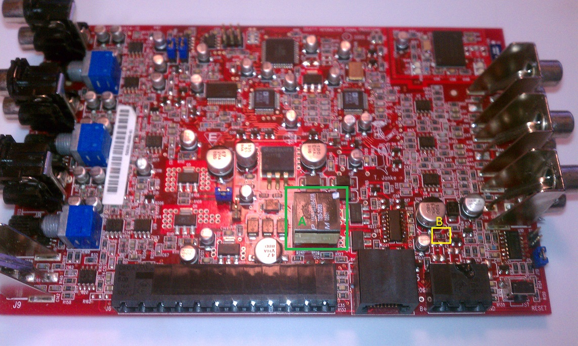

I have a Rockford Fosgate 3sixty.2 that is part of the stereo system in my crazy custom coffee table... ya you heard it (two 10's, amps, car radio, battery, capacitor, and much more done proffesionally) .. However, during an experiment the battery was hooked up backwards (on purpose). Unaware that the 3sixty was still hooked up to the system, it got a little zap and now the 3sixty wont turn on. It worked great prior to this
All the fuses are ok, circuit boad is clean and visually undamaged/cracked/burned, and there is power on the board itself on the input terminals (no red lights or action though). holding the reset button and connecting the power wires together did nothing.

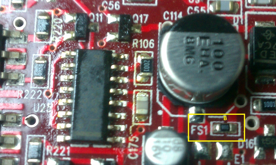

After receiving a second broken 3sixty from a friend, I was able to compare the two and figure out the problem. Rockford uses a protection circuit that is basically a 0.0 ohm resistor that breaks when voltage gets applied in the wrong direction. I do not know what the technical name for this component is, but I switched the one from the working board and it fixed the problem. See figure "B" in the attached pictures.
