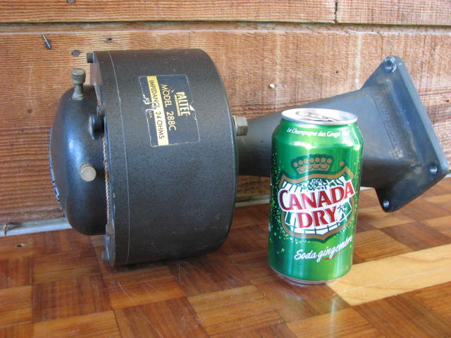

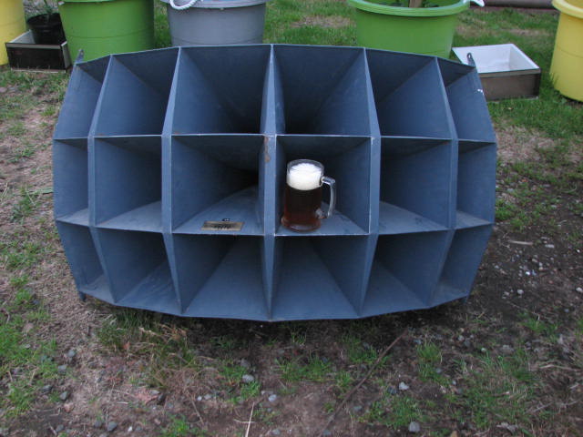

Tweeters for rock? Horns. Like these.
They need great big metal domes to work. Like those.
Now, let's rock!

Rock and roll, and dome, don't belong in the same sentence.
Beat me to it! 😉 From piezo to titanium horns, so plenty of price points between the two.
Regardless, the D25AG has an alum. diaphragm, so at least pays 'lip service' to the Altec horns that most music was mastered on through the '80s and having chosen them over a bunch of other types in a blind test when it first came out it seems a reasonable choice.
If more recent music, then titanium and if too harsh/strident, then damp by misting on cheap lacquer hairspray or if you have access to an airbrush, layer of super thinned Dammar as required.
