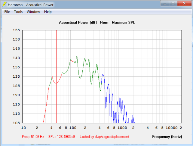

That said, here are the Hornresp sims:

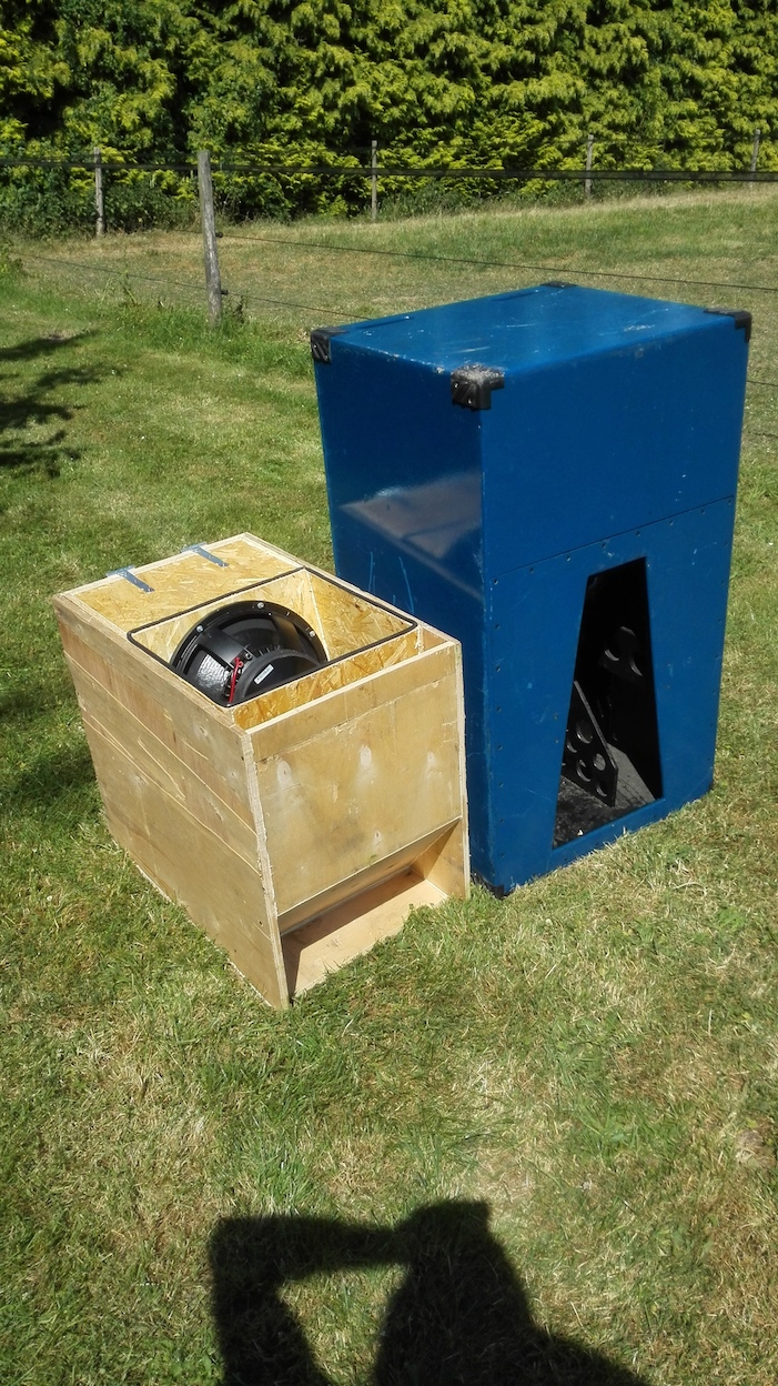

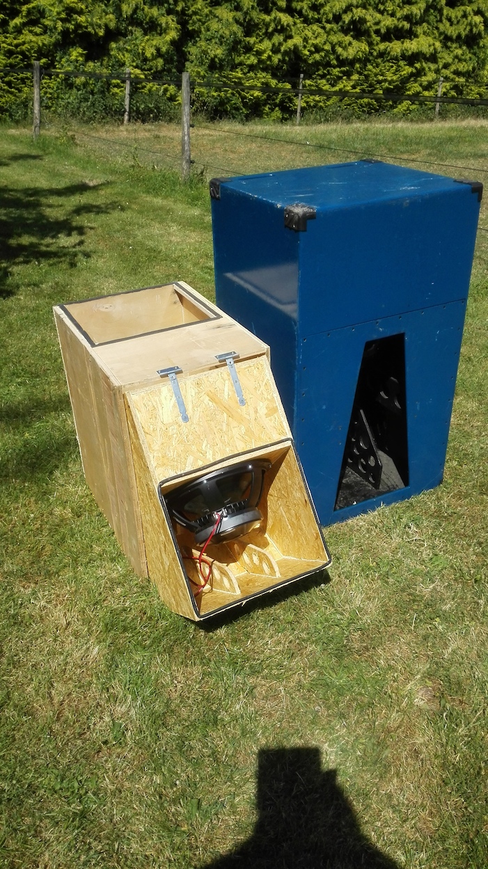

Based on this I designed a foldable prototype, measuring 76x66.5x48 cm (30x26x19 inch) on the outside.

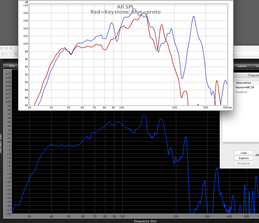

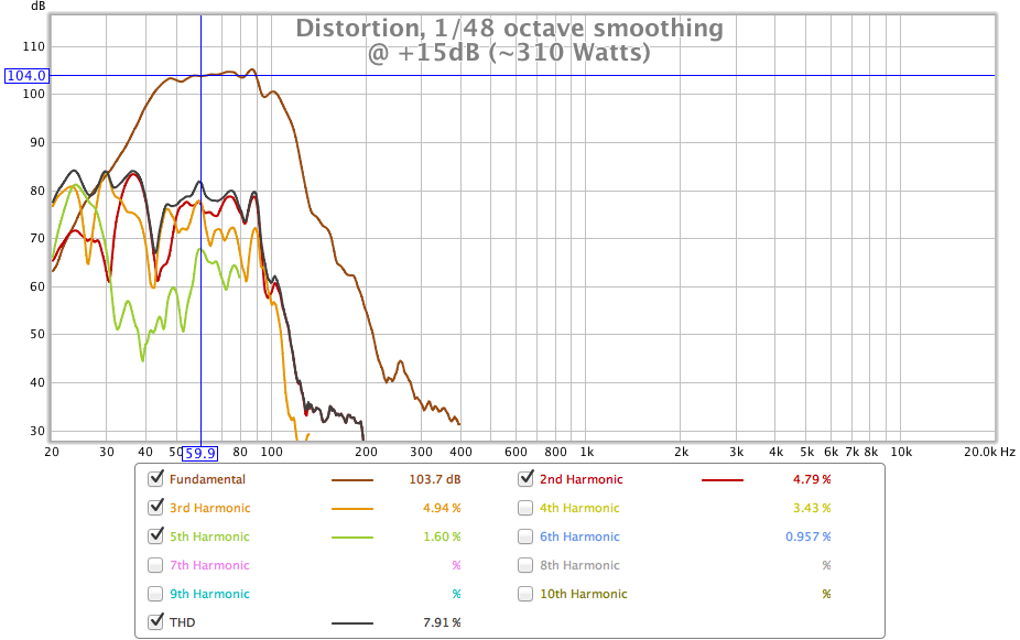

And here are the measurements:
This is taken together with my Keystone loaded with an 18TBW100-8 for reference. Mind the 15TBX100-4 in my prototype is 4 ohms, effectively getting double the amount of watts. So no free lunch. But not bad either, right?
I'm not sure where the 52Hz dip is coming from. It was a ground plane measurement in open air on grass with no real buildings closer than 100 meters.

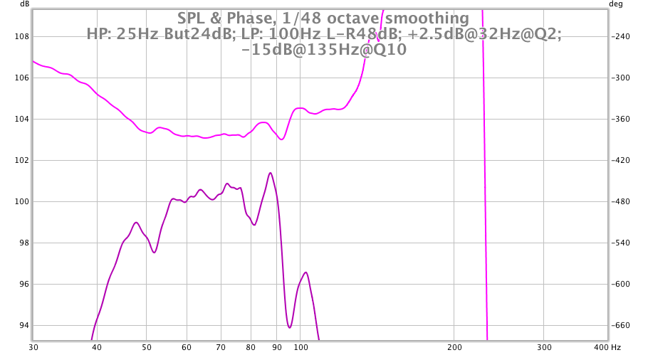

(some quick EQ I did based on measurements done inside combined with listening tests)
(Measured at 10 meters with limited power, otherwise my measurement system would clip)
This is just a prototype, built with some C class plywood/leftovers, so I expect this to be a worst case version...

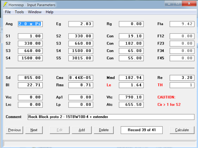

So I’ve been thinking about ways to slim down my hornloaded subwoofers. Since most of a horn consists of air, there surely must be a way to take advantage of this. I’ve tried a few approaches, but nothing really satisfying came out and I didn’t even want to post about it. But now I think I could be onto something and to be honest I am just wondering what you guys think 🙂. So here goes…
Design name: Rock Block
Design purpose: “small" form factor subwoofer for use with band/live sound
Design goals:
- Small pack space
- Loud
- Capable of at least 50Hz, preferably lower
- Longer setup time
- Louder instead of lower
- Not a run-of-the-mill design

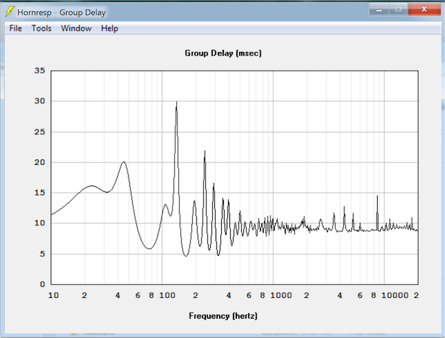

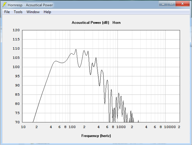

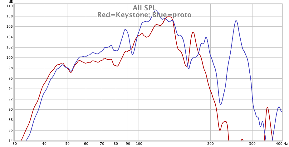

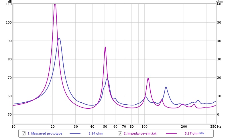

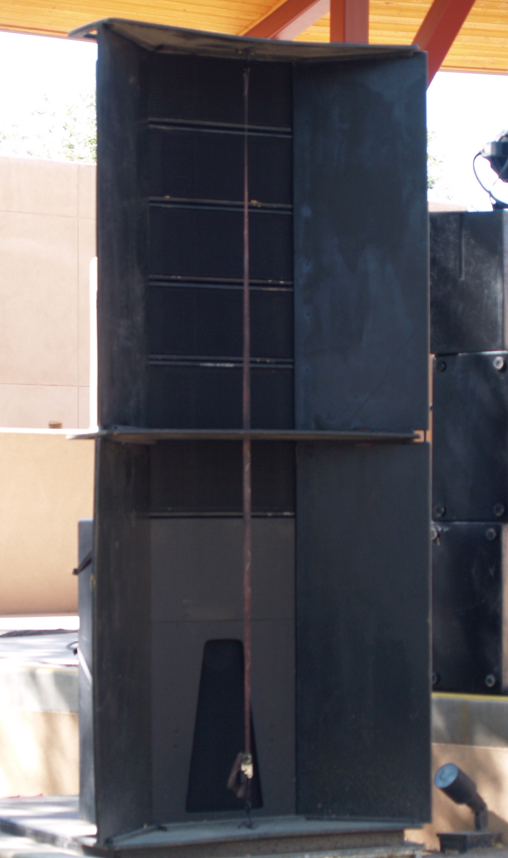

BTW -
Is you Keystone accurate to Art's original plans?
I'll have to dig up the old graphs, (maybe I'm remembering wrong) but that LF response seems a bit shaky, even with a 15" driver.
Now that's some thinking outside the box..!
Very interesting idea. And I actually like the use of the hinges - should make setup time a little easier, amongst other things.

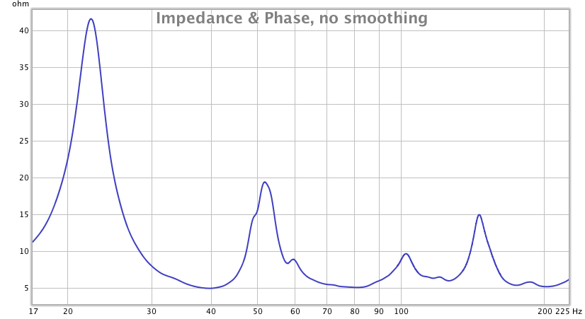

The hornresp sim should probably be set to use PAR not CON segments for a little more accuracy, and if that's a 15" driver, Vtc should probably be a little higher (Vtc should include the volume contained within driver's cone as well as the volume between it and S2).

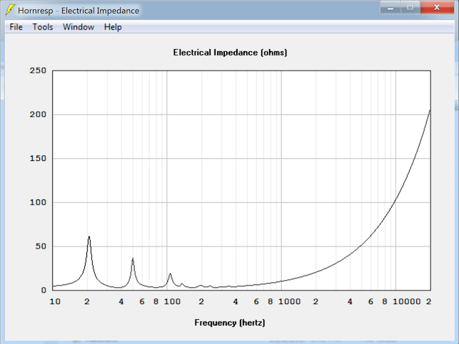

Export the impedance data from Hornresp and use REW to compare the measured impedance against the predicted one - that should give you a pretty good idea of how close the build is to the sim.

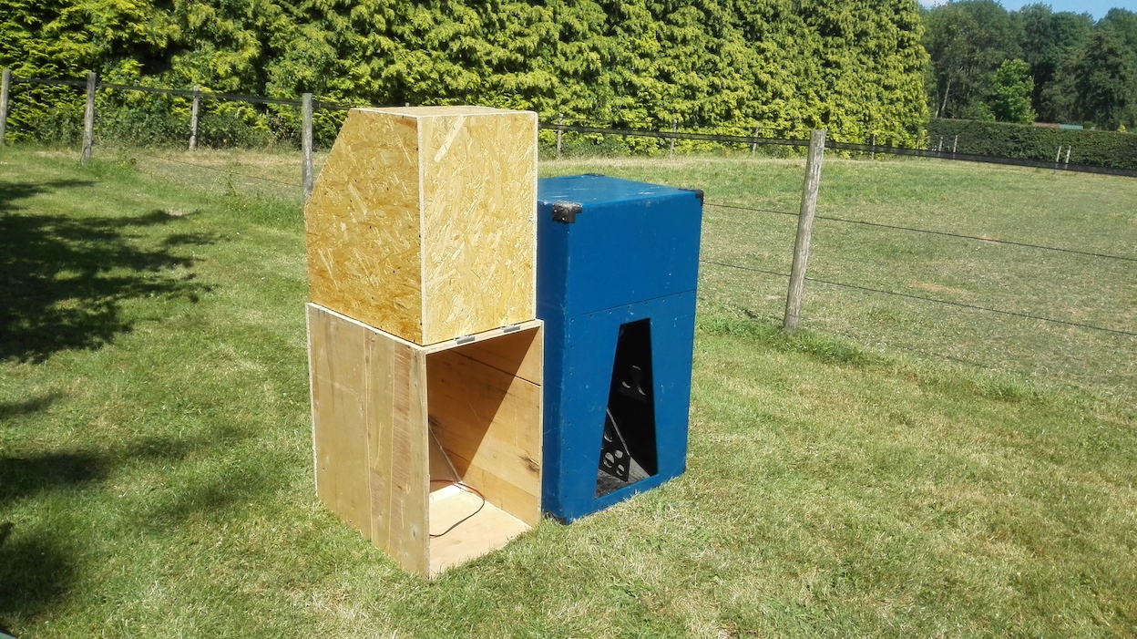

The main issue is likely to be panel flex and stability, as the bottom section isn't properly braced. Any squiggles or smooshed sections in the measured impedance curve that don't have analogues in the predicted curve are signs of panel flex affecting the output of the system. You could use impedance curve measurements as a "guide" to finding the optimal locations for clamps (to clamp the top section to the bottom section) and maybe a removable cross brace (for the bottom section).

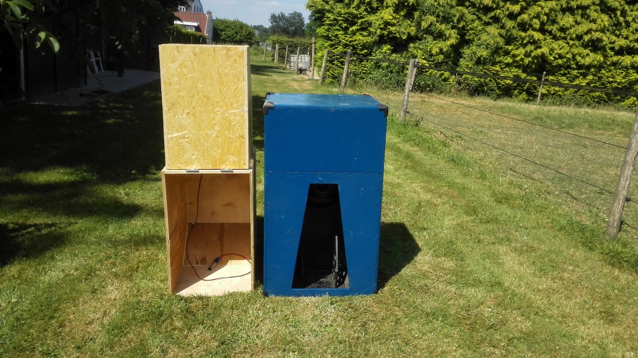

Did you do the FR measurements with the horns side by side like that? If so, that could affect the measurements and might explain that 52 Hz dip.

Yes, original plans, adapted for 12mm birch ply with LOTS of bracing, loaded with the B&C 18TBW100-8 (18", not 15").BTW -

I've implemented cone correction. If you leave it out, the sim is quite worse. Haven't built a proto without cone correction though...The hornresp sim should probably be set to use PAR not CON segments for a little more accuracy, and if that's a 15" driver, Vtc should probably be a little higher (Vtc should include the volume contained within driver's cone as well as the volume between it and S2).
True that! At the mouth panel flex is about a cm each way at 2000 watts 😱. I've clamped it down at the mouth with two times two opposing clamps (so basically I created two braces) and what it mainly does is bring THD down (by quite a lot, I must add), especially second order, but it doesn't really alter the frequency curve by much. Just listening to the difference I would say it plays louder WITHOUT the braces, that's probably due to the second order harmonics.The main issue is likely to be panel flex and stability, as the bottom section isn't properly braced. Any squiggles or smooshed sections in the measured impedance curve that don't have analogues in the predicted curve are signs of panel flex affecting the output of the system. You could use impedance curve measurements as a "guide" to finding the optimal locations for clamps (to clamp the top section to the bottom section) and maybe a removable cross brace (for the bottom section).
I'm still thinking about the best solution for this. Maybe some sort of broomstick with bolts on both ends and a sunken metal dish in the sides of the mouth... Of course any bracing should be quickly installable and removable. That's kind of a challenge!

No. The Keystone was about 3m back with it's mouth to the ground.Did you do the FR measurements with the horns side by side like that? If so, that could affect the measurements and might explain that 52 Hz dip.
I have been thinking of a similar idea for a much smaller blue tooth connected full range sound system for beach usage. I never would have thought of trying for a horn, I was more thinking of 3-4 telescoping tubes that could screw or lock somehow into expanded position. I like the hinge idea. Do you have wing nuts or the like to lock it together in the expanded configuration?
My first ideas were based on telescoping tubes, but in practice (I've built a proto) it proved too cumbersome. You would need to use a very rigid sliding solution AND come up with a decent way to seal the whole thing airtight when extended AND how to keep it all in place.
The hinges makes it really fast to 'unfold' the internal/top part and position it exactly right. But they must be very sturdy. I've used el cheapo ones and they just bend...
No, I don't have any locking implemented between the two parts yet. The top part holds the speaker and proved heavy enough to press down on the double weatherstripping to prevent any airleaks, good enough for a prototype. But indeed some sort of butterfly lock will need to be implemented.
Thijs666,Yes, there are a few 'compromises', but for now I think it's a reasonable start. Excited for comments.
Prototype seems to work well, especially considering the "C class plywood" ;^) !
Your BC18TBW100-8 loaded Keystone appears to roll off about 1/3 octave below my BC18SW115-4 loaded original version.
That said, using a BC18TBW100-4 in the "B-Low" version also did not perform as well as simulations predicted in the low end..
Back to the "Rock Block", other than the impedance response suggesting the horn being a bit shorter than the sim, it looks pretty close to the Hornresp sim.

One or two flat panels that span the width of the mouth and a few butterfly screws might do it... 🙂
Thanks. I just tried this and (luckily) there is hardly any difference. Nothing worthy of posting.The hornresp sim should probably be set to use PAR not CON segments for a little more accuracy.
Sadly I don't have the funds to buy the SW115 just to try it out 😎. I would love to be able to check this. Or be able to measure a well-known industry sub side to side, just as a sanity check for my measurements.
I thought the sensitivity was quite a bit lower than predicted. Hopefully this is mostly due to losses due to the bad plywood and a final version with proper plywood will improve this a bit. As I said, I guess this is a worst case scenario.
Thanks 🙂. Nah, this is just a proto. The OSB is really bad as cabinet material. It isn't even plywood. And it splinters badly 😡. I was thinking to use Baltic Birch 12mm for the outside of the top part, poplar for the inside with a lot of bracing (to keep it light, as you will have to lift this part) and use 22 or 25 mm BB or douglas fir plywood for the bottom part, as there will be no internal bracing possible (only the front will probably be braced). But maybe glueing two different sorts of wood together isn't the greatest idea? 😕Well done, very nice concept and execution.
