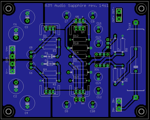

The Sapphire desktop headphone amp is a two stage, voltage gain + current gain design, with a 4 transistor diamond buffer typically running open loop as the output stage. Typically about 10 mWpc of class A output, 1-2 Wpc class B output, and a total quiescent dissipation of 6-7 W stereo. The board revision is 14s1. BOM and info attached, or see the Sapphire web page and RJM Audio products page for more information.
The kit consists of a pair of boards and all the parts for the boards. Volume control, chassis hardware, transformer(s), rectifiers, are not included.

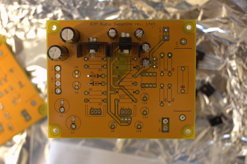

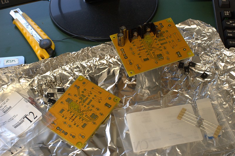

Spiffy yellow Sapphire boards arrived this afternoon.
I'll be putting a set together shortly just to double check everything works as it should.
A quick check showed one minor mistake on the BOM: the heatsinks are a little too wide. I have ordered some of the smaller size and these will ship with the kit.
The correct Mouser pn for the heatsinks is 532-577002B00.
/r

And another mess-up in the BOM, now fixed.
The Mouser pn for R10,11 was for a 330k ohm resistor, not a 300 ohm one. One letter difference in the part code.
Sheesh.
Everything else checks good. Using the R10,11 salvaged from the prototype, I'm listening to the new boards as I type this. The output bias current is about 3x more, within 20% of my calculated value. No quantum change in the sound over the prototype version. Right now it seems slightly heavier, warmer sounding, but the filter caps are haven't run in yet so it's too early to make a proper assessment.
