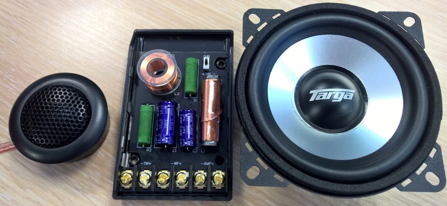

For the front, I needed 4" components, and finding that is quite a task here in SA (for a budget). I considered Orion CO400C, and I still can't decide if I made the right choice, but I decided against them because they only have a HPF for the tweeter, and I don't trust midranges without a crossover. I could then decide between Targa TG-4020ZC (cheap stuff available here, but very good results) and a Starsound component system. I've had great results with Starsound 6" splits, but the 4" just didn't inspire me. The Targa have 25mm silk tweeters and proper 12 dB crossovers. I went with Targa's.
Because I decided on Targa, I used the shop which sold them the cheapest (out of 2, coincidentally a shop I like, and R100 difference (almost 20%)). So I could then choose my rear speakers. I probably should have gone with Hertz, but the price with a mylar tweeter, and I'm not sure, and..... So my final choice was down to <R500 speakers. My shortlist was JBL GT5-402 and MTX TR40C. Same price, very difficult choice. I like JBL. I looked up some pictures, and the titanium laminate tweeter was something I wasn't too sure about. The build quality of the MTX looked better, and MTX is a top brand, so I went with them.

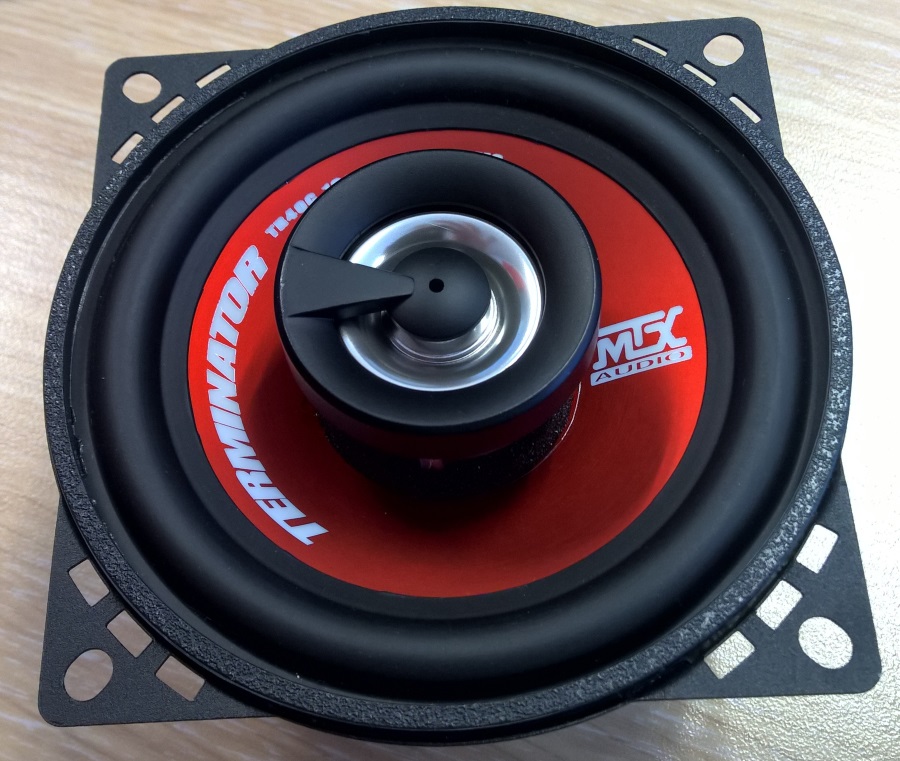

Thanks Bret burrill! I'll post my findings soon. I'm sure the MTX 2-ways will be an upgrade because at least I'm replacing a midrange with a 2-way. The Targa is a long shot.

I just wanted to add that the Targa has been a happy surprise so far, in terms of physical properties. It has a magnesium cone with what appears to be a low mechanical Q - it's really stiff! The basket and materials seem to be much better than the price. I think the manufacturing cost is where money was saved - there is a bit of glue showing where the dust cap meets the cone, and the magnets aren't perfectly aligned... But at least the cone moves freely and the magnet is vented. I believe the voice coil is on a kapton former. My main concern would be driver matching, but this is in a car, so that's not all that important...

Ok, so I've done initial listening tests. As expected, the mylar tweeters sound like mylar tweeters. Continuing with the MTX, although there is a little ringing in the tweeters, it's not prominent. The MTX will almost 100% certainly be an upgrade for the rear speakers. Distortion appears to be much lower than expected. Very happy with bang for buck; I'm really impressed.
The Targa have some good qualities and some bad. Distortion is quite bad in two narrow bands in the low midrange. The tweeters are as good as I hoped. Other than the mentioned distortion, they sound nice. If they don't improve stock, I'm going to put them into a Bluetooth project I've been wanting to do. So far, no ugly surprises.

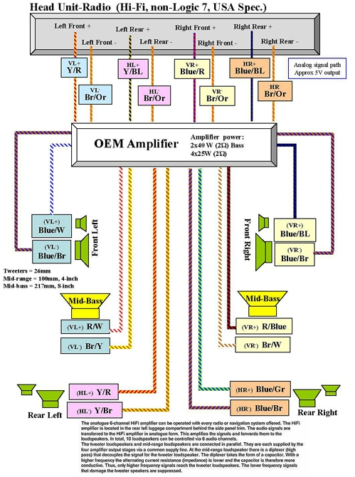

I have a question. I have read that the mids get an equalized and crossed over signal from 110~150Hz from the amplifier. Regardless of this, I would like to fit a proper amplifier for the front and rear speakers (4-ch). How do I get the proper unequalized signal? As far as I know, the signal is on a MOST bus. Can one not obtain a BMW MOST to analog converter?
Perhaps I'm lucky and my car's audio signals are analog already. I have read some evidence of this. If this is indeed the case, I have a use for my 4-ch amplifier I already have! And after Saturday, I can get to installing the 2-ch I already have, and power the existing woofers with that. Awesome! I just hope the ydidn't use the optic connection in the LCI.
I've put in a sub before, but it takes up space and tumbles around too much, so I abandoned the idea. Here's the wiring diagram I used (but it was long ago, so I forgot, and I tapped the rears, not the input signal). It's going to help me a lot here!

The MTX speakers are excellent! A definite big upgrade over the stock speakers. The Targa splits have very low sensitivity, but at least they do level out the midrange peak that was prevalent in the stock speakers. Treble is very well defined. So I think I'll stay with the Targa's.
