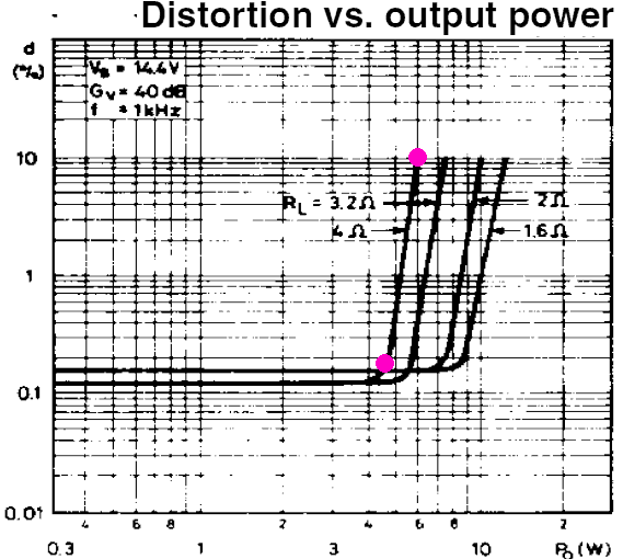

TDA200x are 10% distortion at “rated power”, which is actually driven WAY into clipping. Non clipping power is some 30% less. Simply supply voltage limited, you just have to understand how many real watts you can get off 12 volts. Backed off like it should be it’s about 0.2 %. Not wonderful, but useful for what it is.

TDA200x are 10% distortion at “rated power”, which is actually driven WAY into clipping. Non clipping power is some 30% less. Simply supply voltage limited, you just have to understand how many real watts you can get off 12 volts. Backed off like it should be it’s about 0.2 %.......
