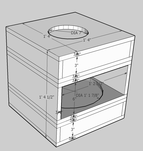

I have researched the Ripole Model, I can't offer much to help with the EE Math, as this is not my skill set, and I would get help with this.
I can offer advice on the Housing and have attached a information I downloaded of a Housing Drawing Plan,
for Dimensions of a Double Ripole using 15" Bass Drivers.

A Ripole with a 15" driver will have a resonance at around 150Hz-200Hz. The resonance will be sharp/peaky because the cavity of the Ripole is deeper than it is wide. This makes the Q of the resonance high, and you must make sure to EQ this down properly. I would not recommend trying to use the Ripole above about 0.75 times the frequency of the resonance. This limits it to no higher than 125-150 Hz.

From the page you linked above:
That figure of 200-300Hz is for the Ripole design using a 12" driver. In that case the depth of the cavity is a little over 12", enough to accommodate the frame plus an inch or two, e.g. 13"-14".Expect a chamber resonance of up to 20db to develop between 200hz-300hz
The resonance is a 1/4 wave resonance of the "slot" or "tunnel". The depth of the tunnel is what determines its resonance frequency. Of course a 15" driver requires a deeper tunnel to physically fit inside, so the resonance frequency will be lower than the 200Hz mentioned in the article. Around 150Hz is about right. It could be slightly higher.
I have no idea how you calculated your numbers, but figuring out the resonance frequency is relatively easy. It's
0.25*c/d
where c=345m/s (the speed of sound) and d is the depth in meters. One meter is about 40 inches.
For a depth of 14" this comes out to 245Hz
For a depth of 17" this comes out to 202Hz
That's the frequency of the peak, and I find it can be a little optimistic (it's often slightly lower, maybe the air adjacent to the opening is part of it, like what happens with a flush port). The response will be sharply rising up to the peak for a Ripole and it is hard to EQ properly, so you just cross over low enough to suppress the peak.
