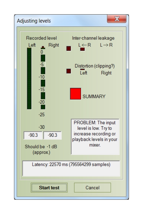

I tried running in compatibility mode for XP & Vista. Same problem.
My Win 7 OS is 64 bit.

Thanks, that would be great. I've been researching this every now and then for a year. I did uninstall the old version and install the latest version. Same problem.
That's what happens when you increase system font size. Just a display issue, seen that for ages.
Wow, you are a genius, thanks sgrossklass.
I did not realize that Win7 defaults to 125% font size on this laptop. Sure enough though that's what it was set for.
Changed to 100%, all ok now.
Genius is not required - just the kick-*** vision of your average bat. 😉
Probably you have a fairly high-DPI screen there.
Anyway, at least it's just annoying and doesn't break anything. The MS Keyboard Layout Creator tool refuses to show the keyboard then, which is pretty stupid. I created an extra user with a 100% system font size so I could use that one properly.
