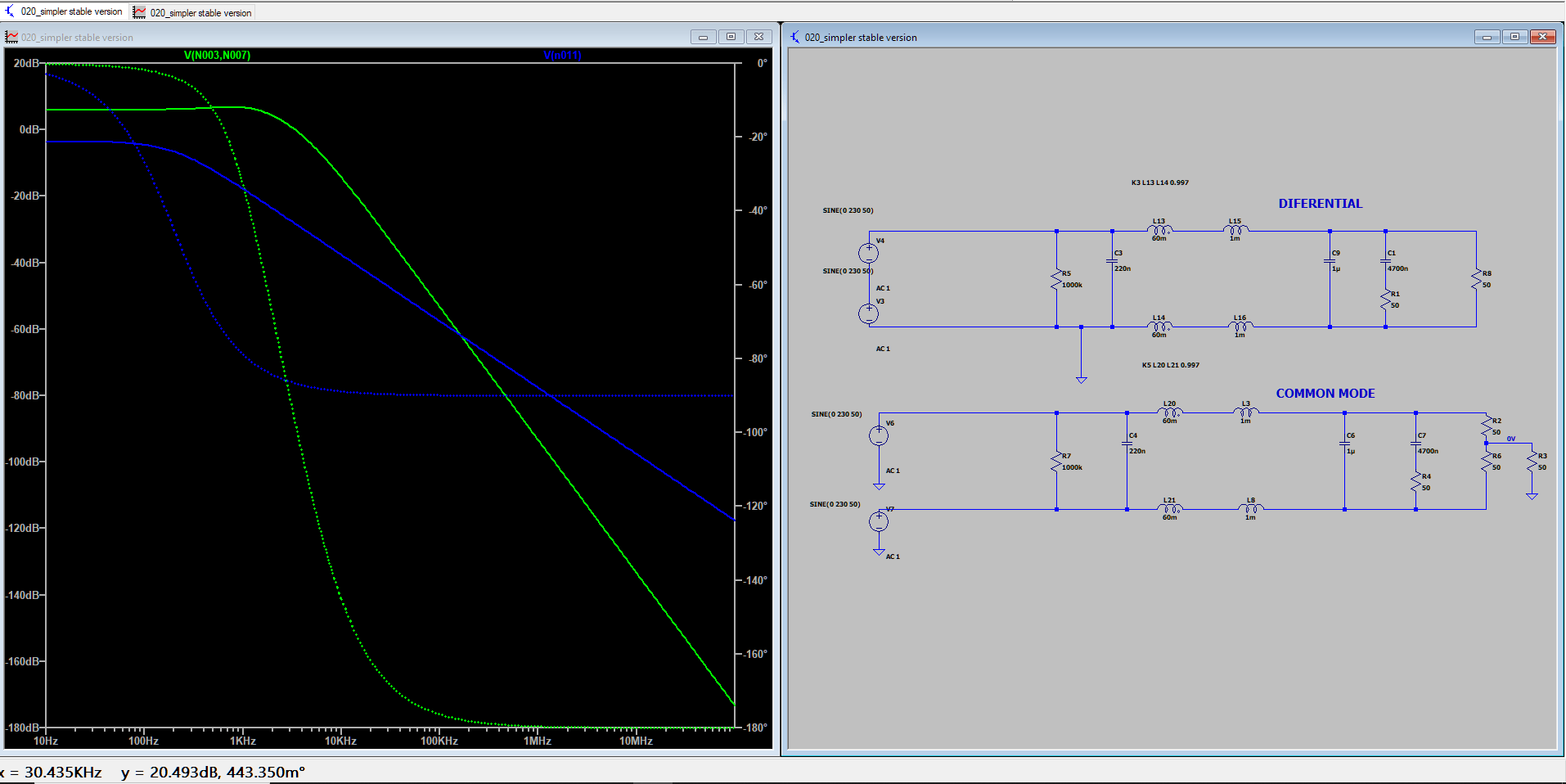

I was just trying to simulate the EMI filter now considering the Brookes Stability criterion had considered the values for the common choke with about 60mH.
Now was just doubtful about that is it right way to do the simulation with the loads. As I see differential version seems fine but common mode which is bottom circuit is something Im doubtful about.
the green curve is the differential mode output measured across R8 in the top circuit
the blue curve is the common mode output measured between the mid point of R2 and R6
