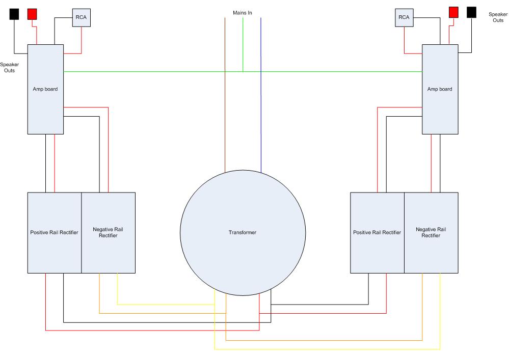

And yet another question when I am at it. I have a Aleph J amp that I want to get up running and I have a 300 VA transformer with 2 x 18 volt secondaries. Whould following be an acceptable solution if I don't want to buy another transformer and run the amplifier as double mono?? I already know that I risk humming but 300 VA transformers are not for free so I thought this seemed to be a neat solution using one transformer and in this case I presume it is crucial to separate right/left positive and negative rail using the two different secondaries to avoid humming according to diagram that I found on the web.

The peak of 9Vrms is 9*1.414= 12.7V. You will lose a Volt in rectifier, 11.7V. You can't really get away with less than 3V drop in the regulator unless the reg is fed from a regulated source. So 11.3-3= 8.7V each side.
BTW: many-many "+/-15V" circuits will run fine on +/-8V. That's enough to support a 3.5V line level which is enough to push almost any line input.
