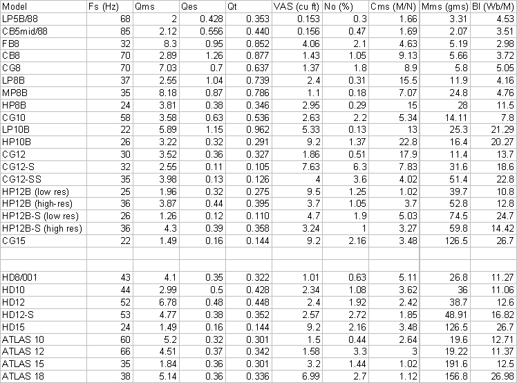

According to data I received a couple of years ago from RA, the HP12B Super came in two versions, a low-resonance model and a high resonance model. The data is attached.

I bought a couple of the ordinary HP12B drivers last year (not the -Super version), but I've not yet measured their TS parameters to see how they match the data in the table.
I use their excellent HP8B units, two in 34 litre sealed boxes, and another two in 62 litre transmission-line enclosures. Both work extremely well.
I have measured the HP8B TS parameters, (though I don't have them at hand), and the Fs was very different from the published data. I remember that I measured an average of 33Hz across four units, compared with the published 24Hz. I really ought to re-check the units in the sealed box speakers, as these are the ones I use every day, and see if regular use has dropped the Fs.

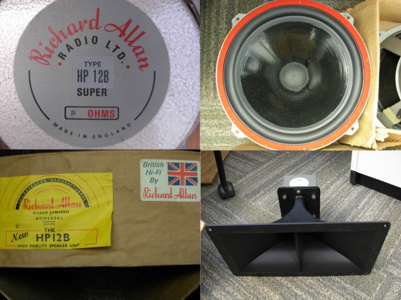

I add fews pictures of my treasure.
Nice, thankyou
I love that label...I remember that RichardAllan drivers had a peculiar smell, kind of tarr like...if its the coating or the glue I dont know
I have only seen the 12" with harmonium surround(yellow?)...is it rubber or foam ?
All the RA drivers I have (HP8B, LP8B and HP12B) have high-quality rubber roll surrpounds that don't seem to deteriote much with age. The red felt outer ring is simply a mounting gasket if you want to mount the unit to the rear of a baffle board.

I've measured one of my HP12B units using the LIMP program (part of ARTA) using the added mass method.
(I hadn't realised how difficult it is to get consistent results on a large heavy-coned speaker using the added-mass method!)
Anyway, once I had positioned the speaker so that I was getting consistent measurements I got:
Fs 28.8Hz
Qts 0.36
VAS 138 litres
Mms 80g
Qes 0.42
Qms 2.26
Rms 6.5 kg/S
Cms 0.4mm/N.
I was using an added mass of 25.4 grammes, comprised of a toroid of Blu-Tak pressed onto the cone around the dust cap.
This was with an HP12B (not the -super) unit that has been in storage for a few years, so really I should run it in with an LF signal for an hour or two so that the suspension can get the sleep out of its eyes!
