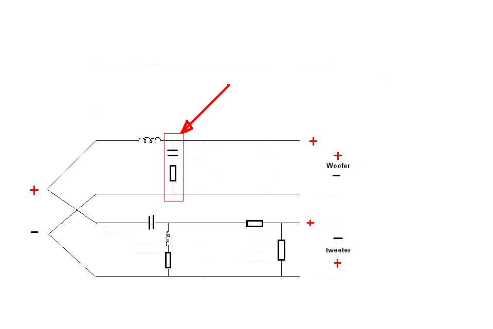

Ok, but dont forget a cap/resistor impedance correction 😉
Huh? where?
I'm waiting for the woofer to arrive and I'll run an impedance curve on it. I was going to decide then if a zibel was needed or not. I take you've already come to that conclusion for that driver?

Regarding zobel on woofer
Its needed on all
Its just a matter of the values needed
And, any paralel component might be used just to adjust phase
You need to realise that 6db doesnt really exist in real life
Well, might be possible with a wide range driver
Modern xo design is based on how response looks on the acoustic side
Which means you have to consider a drivers own natural roll off
Older books may suggest to use 6db/18db
But in reality they never knew what was actually happening
Its very common to use 12db/18db with no tweeter offset
But in reality its probably 24db/24db on the acoustic side, or as close as you can get
Though it is possible to fiddle with component values to obtain other slopes, like say 10db
Or maybe softer slopes that starts out as 12db and ends with 24db, or more
