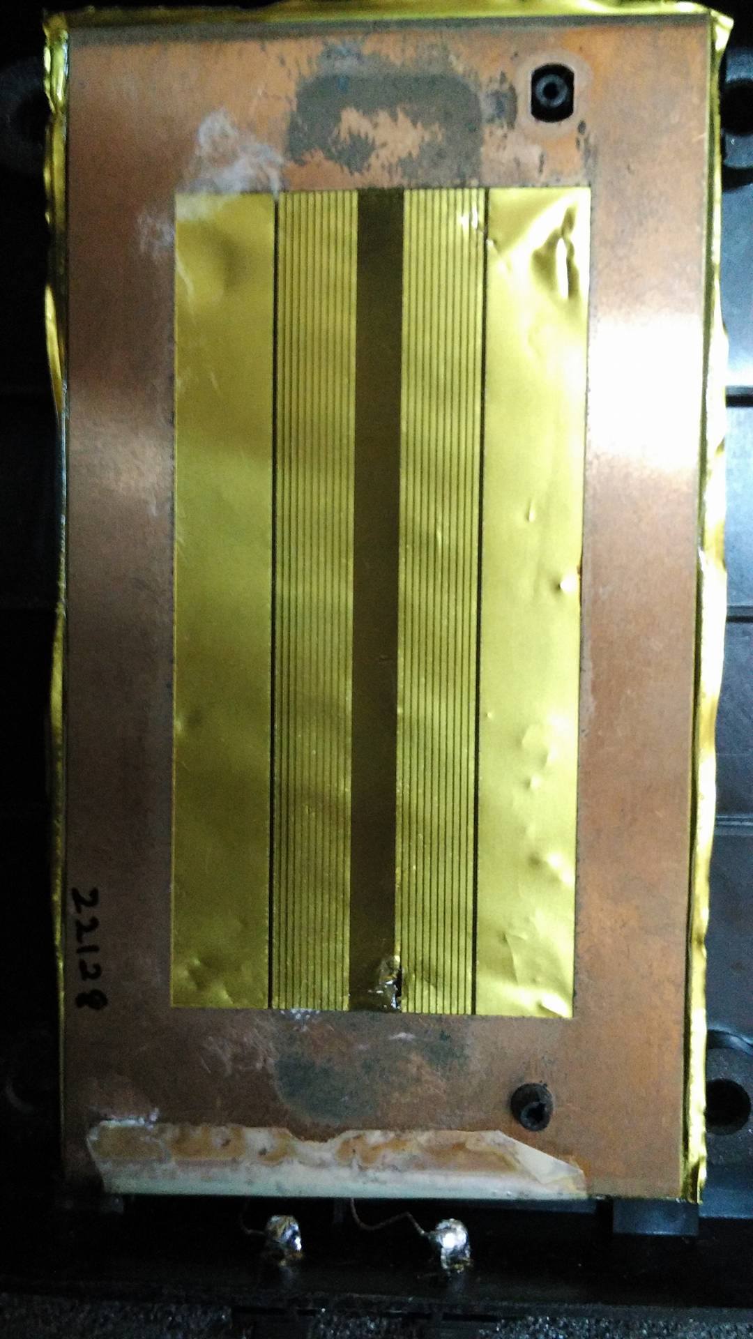

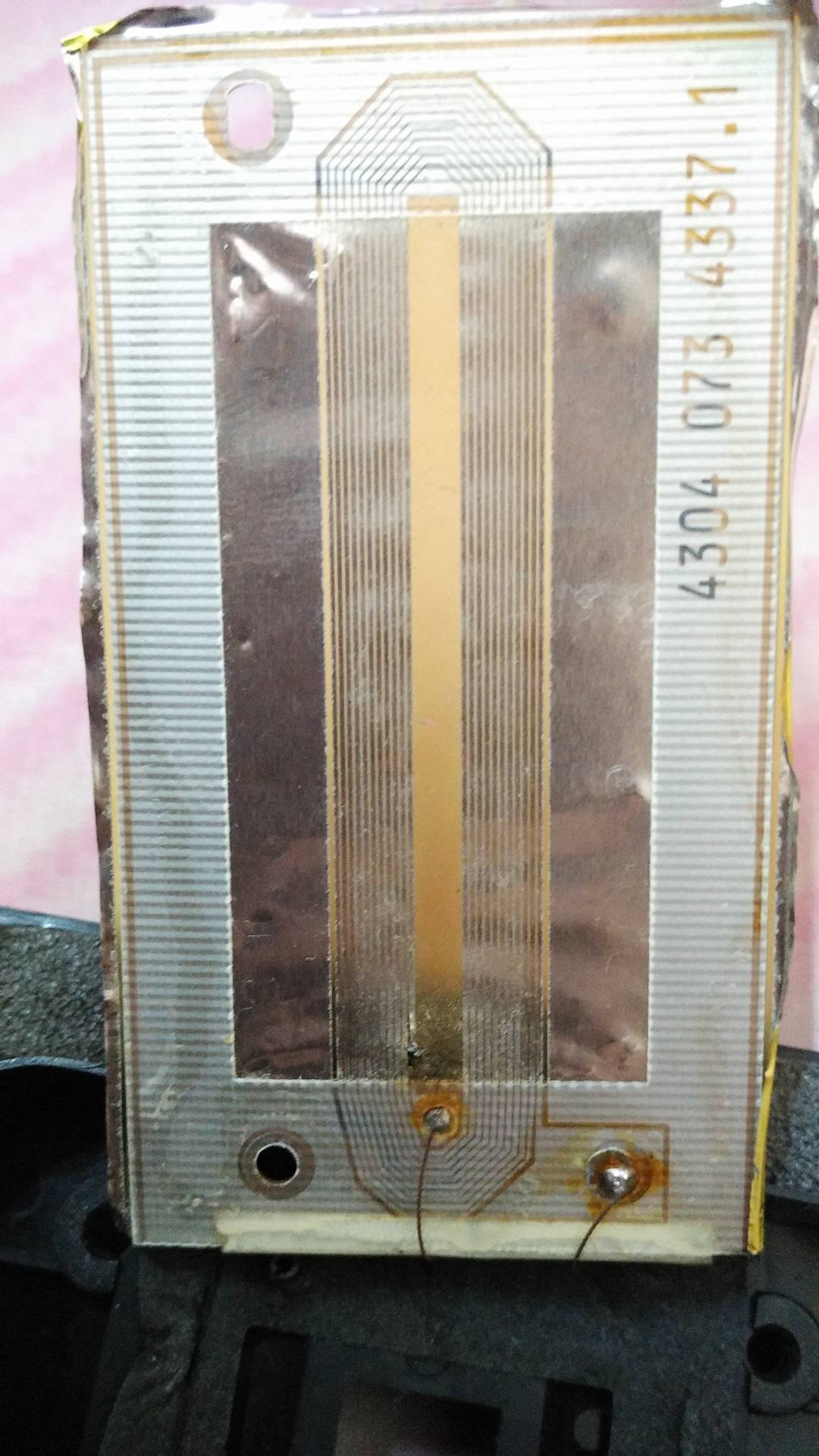

Hi, I'm new here and im not sure if i'm posting at the right place, but I have a faulty ribbon tweeter. Is there any way i can repair it? It's a AD21601/rt8 from a Philips FB821 speaker. Here are some pictures.. Thanks!
You can repair this. How long the repair will last is linked to how you plan on using this driver.
There is something called conductive epoxy.
https://www.google.ca/webhp?sourcei...spv=2&ie=UTF-8#q=conductive epoxy circuit pen
That and a possible aluminum foil bridge over areas that are nuked will get you back up and running.
You will need steady hands and patience, but it can be done. I've done it quite a few times myself. And I have rather large hands.
