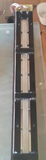

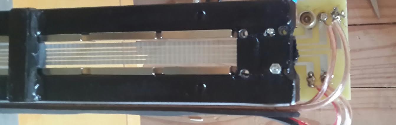

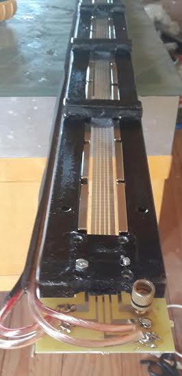

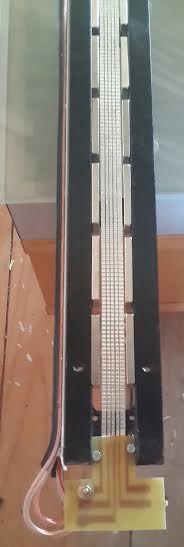

I see you've got multiple conductors looping through the gap. Will impedance be high enough that you can do without a transformer?
Dan
Dan
Very cool, Africa. If you can, please share info/pictures on the materials and procedures. If impedance is posing a problem, it shouldn't be very expensive to add a ready-made transformer.
Hello, the impedance measures about 6 ohms so there is no need for a transformer.
I cut my ribbons with a rotary cutter laminated with mylar using 3m 77 to laminate.
