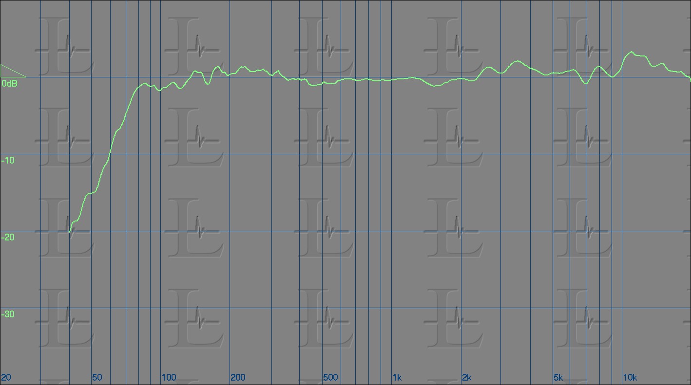

I'm just getting into this DIY ribbon business and as of now I have a few ribbon prototypes up and running. My main focus right now is pushing the bass response of the ribbons as low as possible. Whats the lowest anyone here has gotten their ribbon to go? Is there a practical limit that everyone has conceded to (given the ribbon width vs resistance limitations)? Obviously I could make a 3-inch wide ribbon but it would be prohibitively long and thus require a huge number of magnets.

I have been building full range planars for 20 years now from large ones 7' high to my latest smallest design using 23 micron mylar A. 60 x 40 cms which go down to 20 Hz. I don't know if this is of any interest to you?.😎

Yes, the ribbon width being so much smaller than a wavelength and inability to seal the air path around the sides of the ribbon, allowing air movement between the front and back of the ribbon which cancels instead of propagating. If you put a sealing suspension on those sides, then it is called a planar dynamic.

Planer dynamic is magnets behind perforated plate , ribbon magnets on the side , front and back open.
You can make a PP ribbon ( magnets front and back no plate/ use bars ) as per Yankee ribbon or PP planer magnetic ( plates and magnets front and back) . The best planer magnetic bass driver has to be from apogge much better than magnapan, difficult to do , but worth the effort IMO.

Tried the push pull design on my full range magnetic planars and I found it wasn't worth the extra magnets or the extra work so abandoned this approach. The secret of higher sensitivity is the weight of the membrane the lighter the better. I built speakers 7' high but it wasn't worth the effort. Especially compared to my 60 x 40 mm sized latest design using 4.5 mm wide foil and 23 um mylar. To improve it even further I may have to reduce the width of the foil and use 6 um mylar, but this would be a lot more difficult, and it may not make much difference to the finished speaker and it would definitely be more fragile. I have not yet decided if this is worth the hours of work. Especially at my age.
