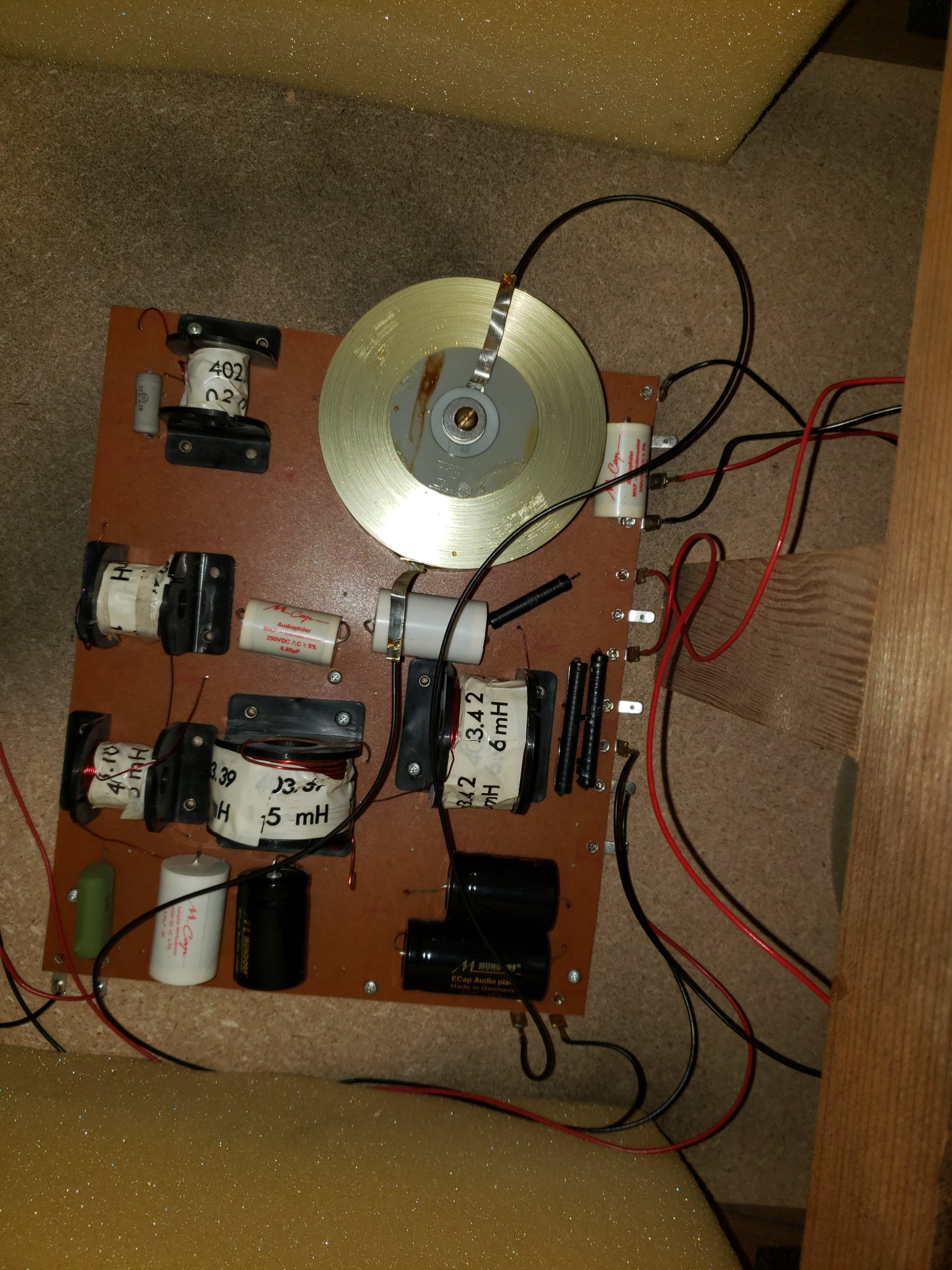

I was looking for he
lp with regards to connecting a ribbon coil to my crossover.Should the coil be connected from the inner foil to the post positive or the outer foil to post positive? as you see in this photo the inner wire is connected on the left side and outer is connected on the right side. does it make a difference? the speaker crossovers were connected opposite.the positive speaker post goes to the left side. thanks for any help.
Inductors aren't polarized. I'd have a slight preference for the inner being the hot terminal to reduce stray capacitance, but its pretty marginal.
