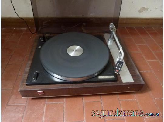

Here is a photo of a turntable like mine, but this isn´t my turntable.
It's a fine idea to build the moving magnet phono stage into the turntable, Osvaldo. I managed it with a (Thorens TD160) turntable like yours with a simple toroid power supply, 15V voltage regulators and a power switch and LED indicator. I built a balanced input amp using NE5532 opamps on veroboard IIRC. Quite sophisticated really, and I do know a bit about common-mode, but don't fret too much about the actual opamps. 🙂
The benefit was I could mount the amp at the base of the tonearm, and get rid of the pesky 0.5m of 100 ohm phono cable with it's 200 pF capacitance due to the mismatch with a 47K load. I recall Stanton and Grado made the best low inductance MM cartridges which gave you the sweet top end.
For all that, moving coil and high mass tonearm is where it's at with vinyl, it simply works better, mainly because everything is matched around 100 ohms. If anyone doubts that MM needs some help, just wire up some 1K resistors on the hot outputs of a MM cartridge, and listen for a dramatic improvement in sweetness in the top end over an admittedly increased noise floor. 😎
