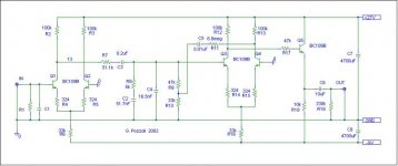

I'm having some trouble with the RIAA on a project I've been assembling. Everything works as it should but the bass is down. It uses a passive RIAA network and while there are a lot of online calculators, I really need some help to know which RIAA components (R7, R8, C2 or C4) to change and whether to increase or decrease.
I've attached the schematic and my RIAA plot.

Not an easy circuit to analyse, but it appears that LF boost depends on the input impedance of the second stage, which depends on the current gain of Q3. R9 is boostrapped so that will not contribute very much to input loading. As BJT current gain is a very poorly controlled characteristic then in this sense it is quite a poor circuit.
Try putting a higher gain transistor for Q3.

Yes, I hadn't spotted that. Is R17 a stopper? It seems to have quite a high value.
This circuit, although dated 2002, looks more like something from 1972. Even with the right RIAA response it is likely to have significant distortion.

I forgot to mention that I used BC549 transistors instead of BC109. I measured the hfe of all the BC549's and got about hfe=600 for Q3. I could try a higher gain transistor but would dropping R7 cause my bass response to increase?

Just tried dropping R7 by 20% which resulted in about 1% drop in dB across the band upto 1khz. I ran out of time to try anything else but will look at again in a couple of days.
I am calculating ~ +13V on the collectors of the input LTP.

That would give about 2mA through the EF output stage.
The whole circuit runs at extremely low current.
Would it work better with some higher currents in each stage?

The bass boost is essentially set by the ratio of Q3 input impedance to R8, so you could try reducing R8 - but then you would need to change the RIAA capacitors too.

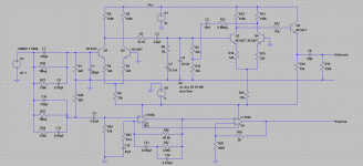

Hi Molly, I don't have a simulator. I'm interested in your first simulation and the rising bass. This is the opposite of what I'm getting. I wonder if it is due to c5 being 10mf in your Sim (vs 0.01mf in the original circuit).

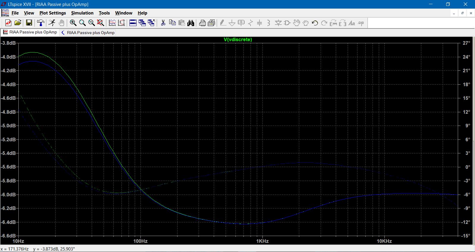

So here is C5 at 0.01uf and 10uf, both traces on the one chart. It makes virtually no difference.
Edit... C5 already was 0.01uf. I entered it as 10nf. You can see the value makes little difference here.

Oops my mistake while reading off my phone screen, sorry about that. I'm still at a loss as to why my measured bass is 3-4 dB down and your model is 4 dB up against the riaa standard. Something funny is going on somewhere....
