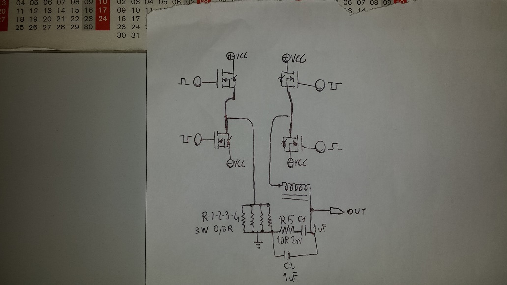

Looking at the circuit diagram of the t3000 and t2000, I realized that 2 banks of 4 output MOSFET bank, reach the battery ground, through some of SMD power resistors of 0,3ohm 3w.
Below, I have attached a diagram I drew a hand of person, just to let you know what I mean.

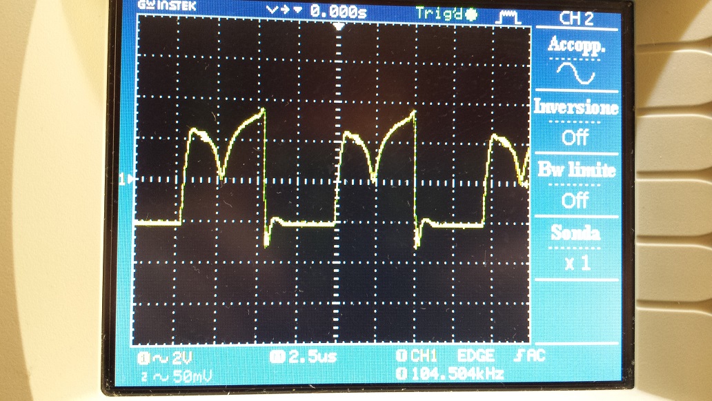

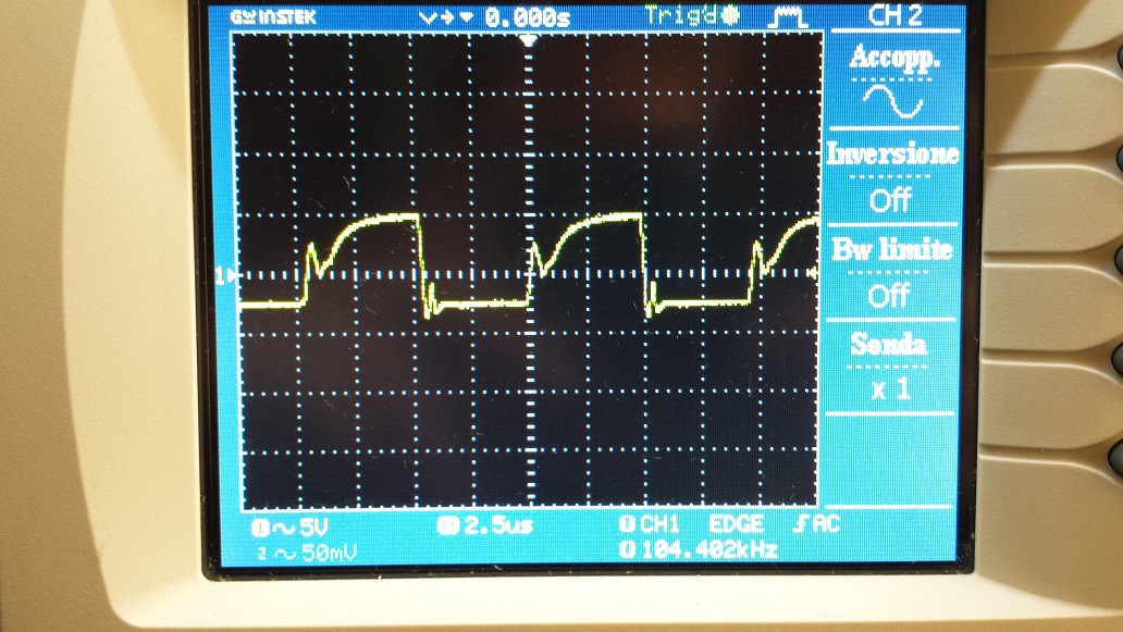

I would like to recreate this thread to explain some things.
I re-opened my t30001bd after so long that it was unused because now I would like to finally mount it in the car.
I'm really curious about this abnormal heating, so I decided to see what happens on the mosfet gate with my oscilloscope.
I would like to share these with you.
The first photo shows the signal on Q432-420-419-418 with a voltage of 3.4 volts.
The second photo shows the signal on Q433-429-428-427 with a voltage of 1.98volt.
The third picture shows the signal on Q431-413-412-411 with a voltage of 2.02 volts.[group that heat more quikly and strange]
The last photo shows the signal on Q430-410-405-404 with a 3.5 volt voltage.
All the signals were observed with the connected reference on the source of each group, even the voltages were detected by a multimeter with the black probe on the sources.
What do you think? Are these signals normal?

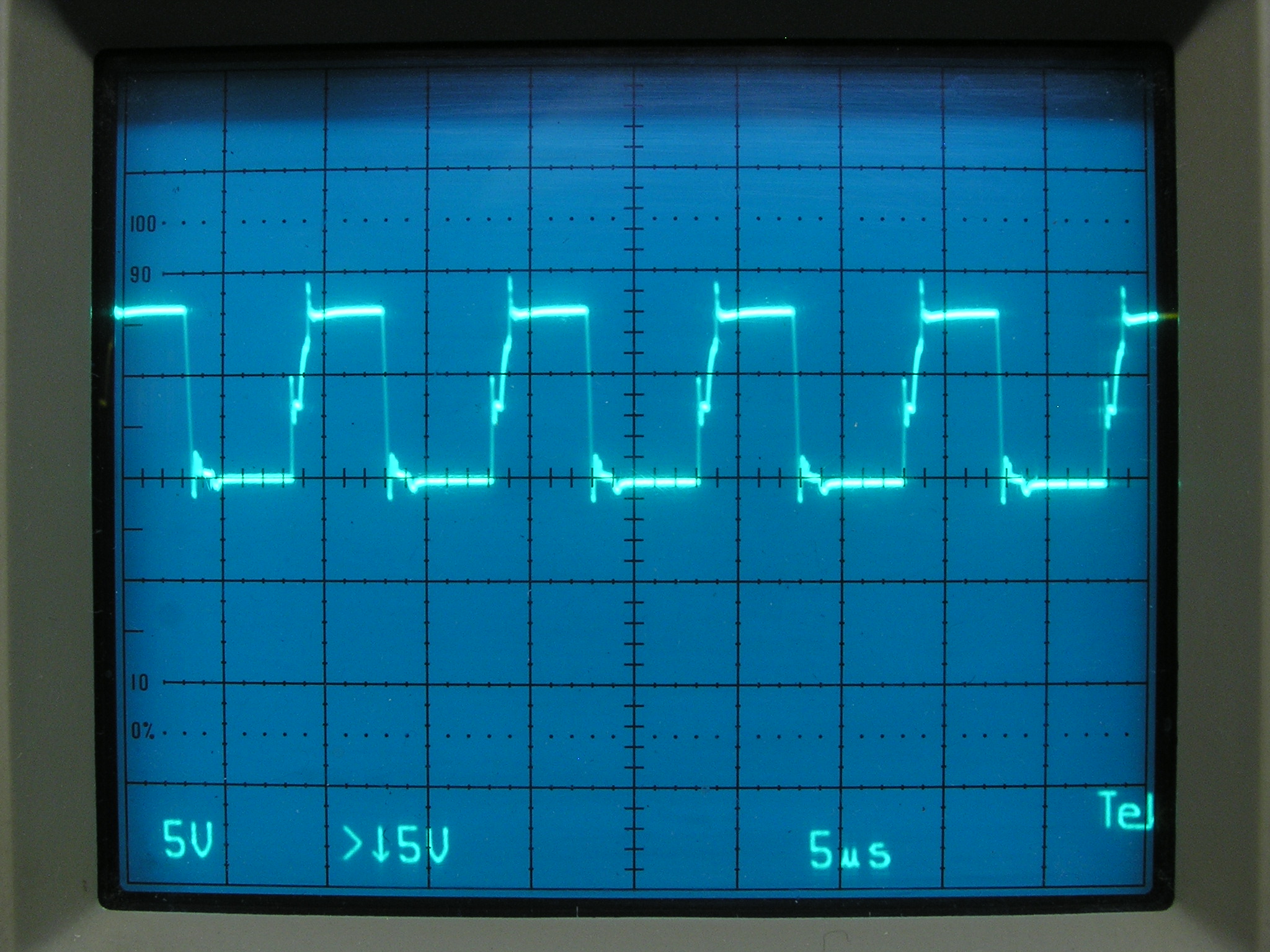

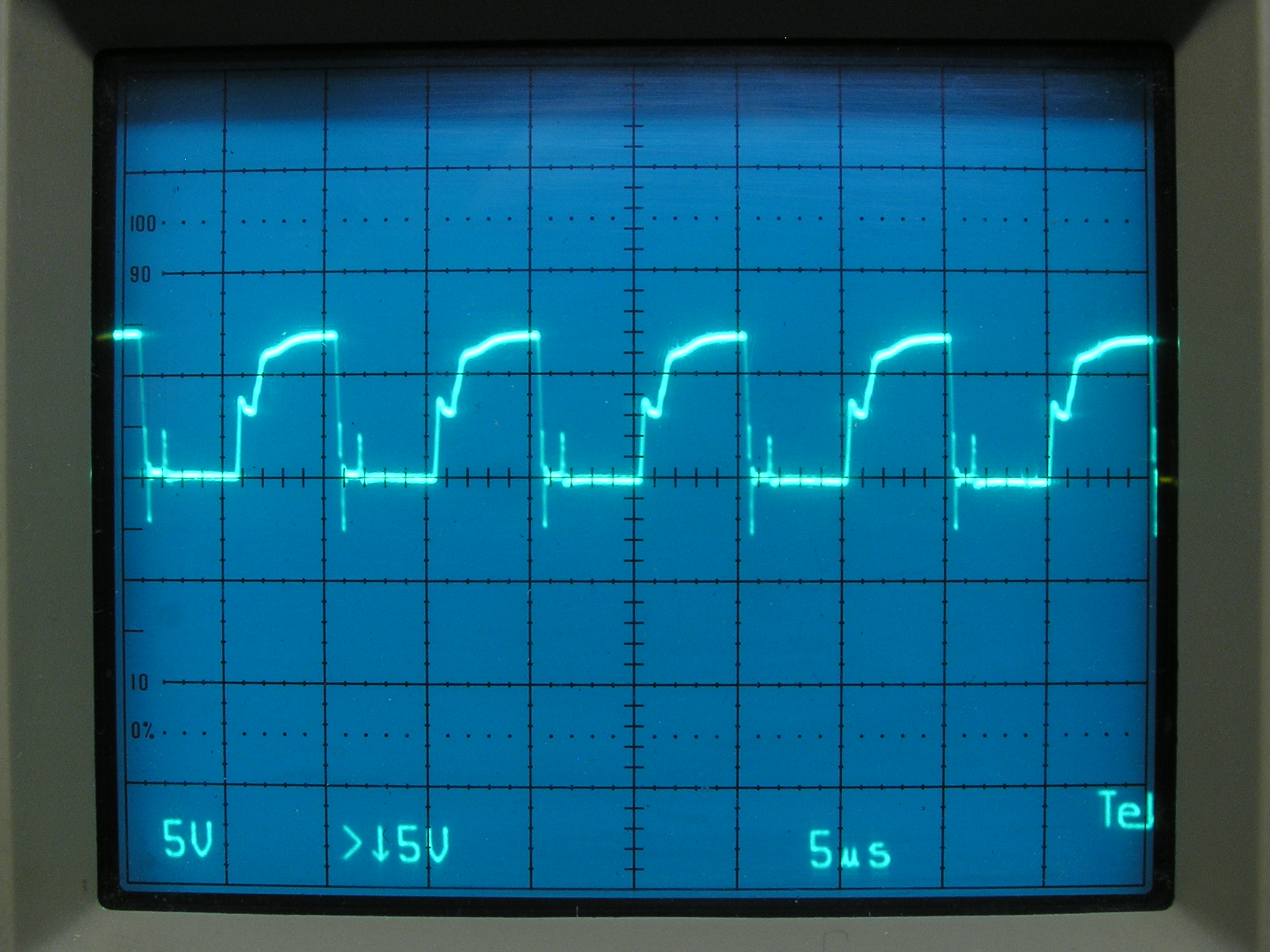

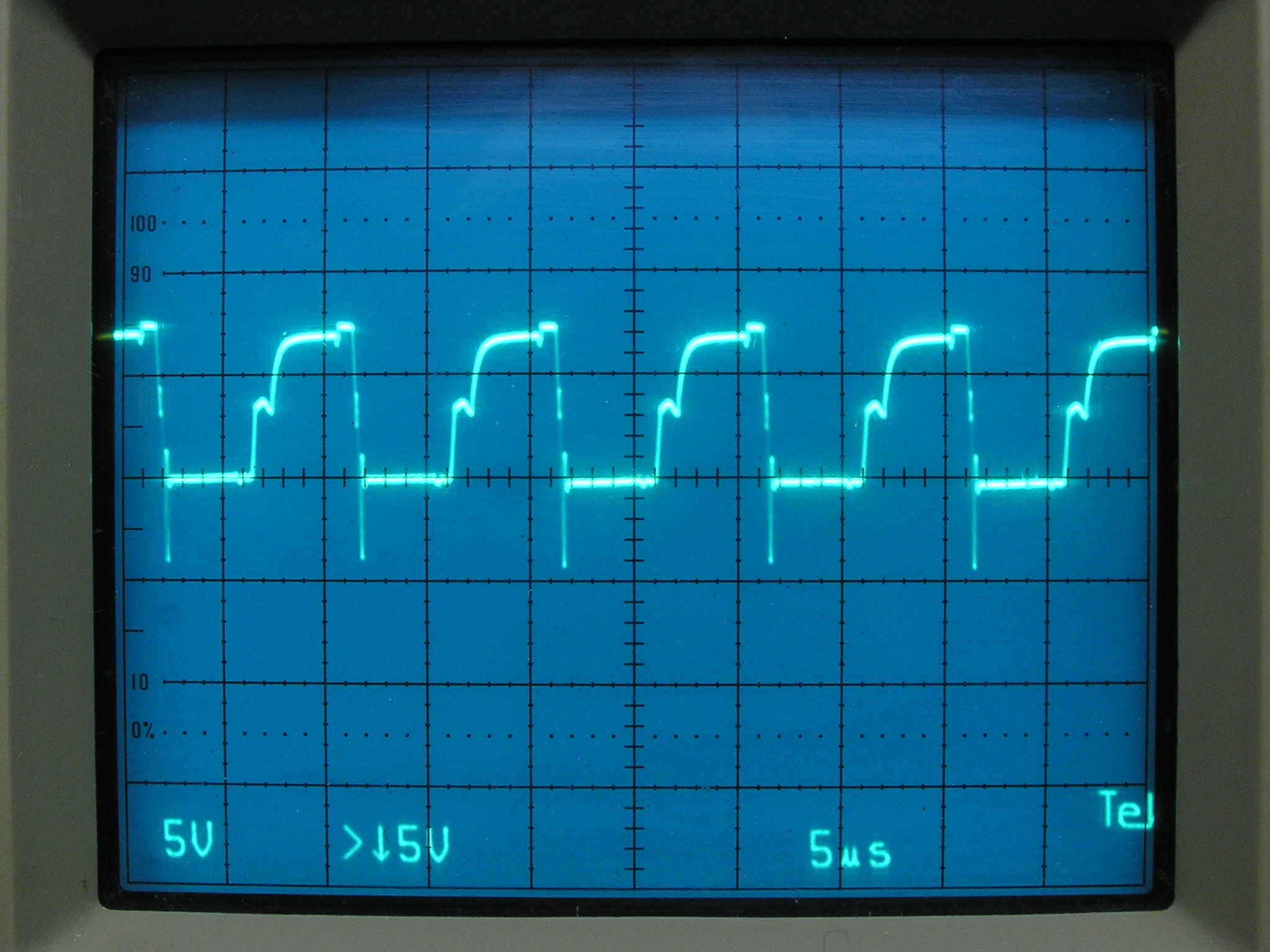

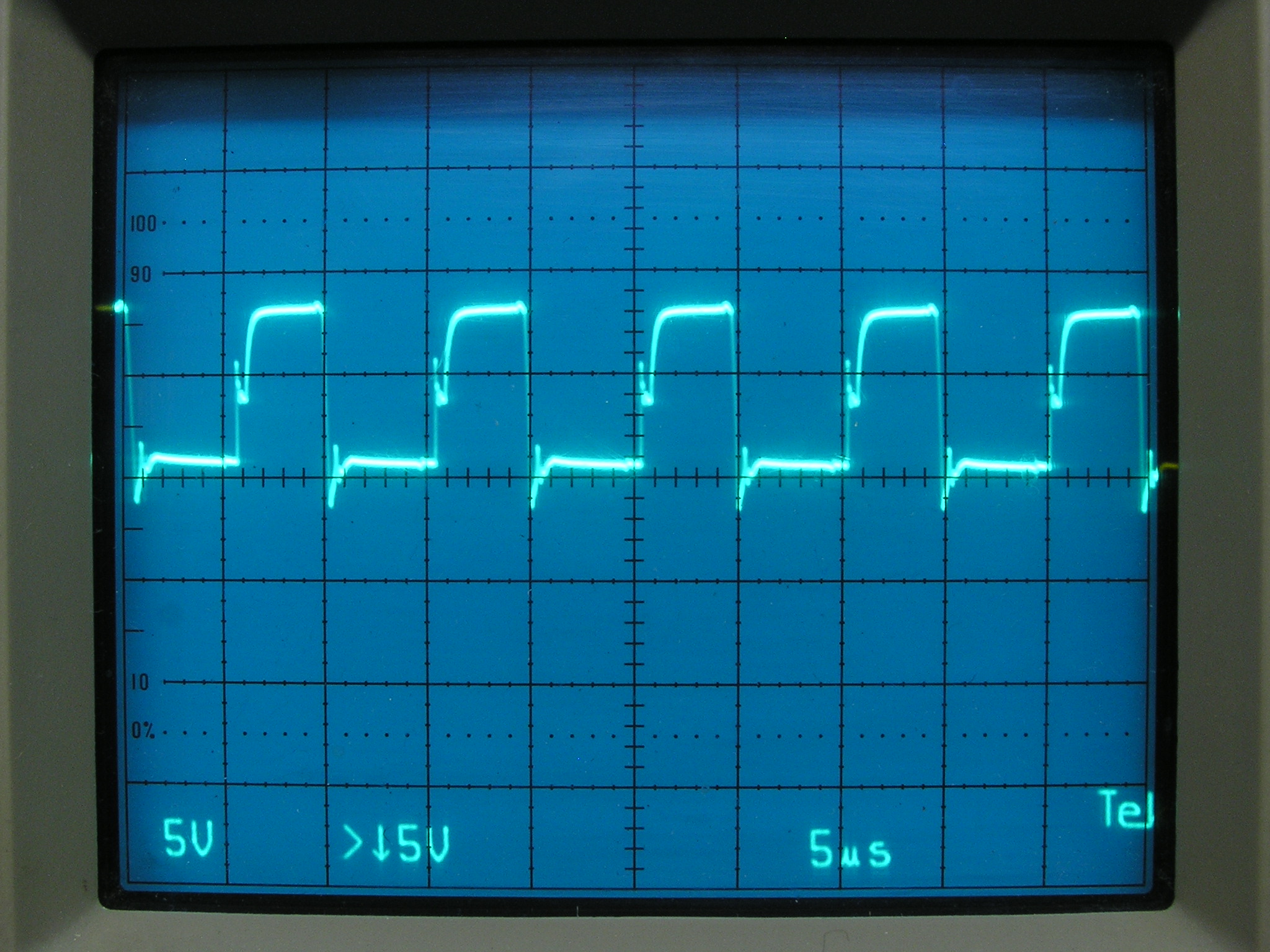

I don't have the waveforms for a 3000. The attached waveforms are from a 1000. Use the diagram to find the corresponding transistors. The file names of the photos indicate the output FET designation.
  • rockford - powerT10001bd-1405-51669-12.pdf

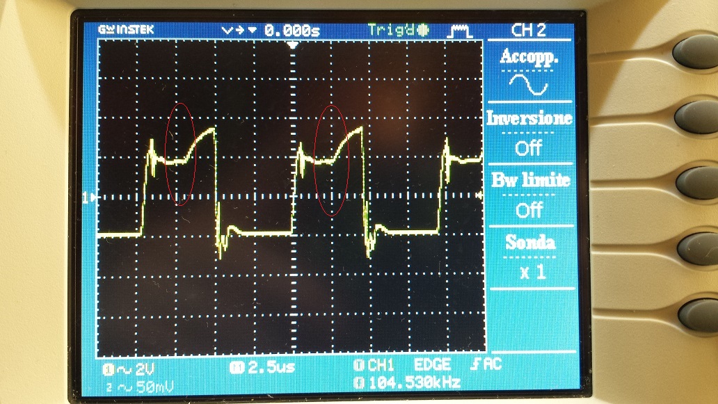

We admit that t10001bd is identical to t30001bd (with the only difference of having a higher number of power devices), it seems to me that the signals in Figure 2 and 3 are somewhat strange.
I put a red circle in the underlying images to highlight the strange fact in the signals that concern group 2 and 3.
I'm thinking of C415-C417-C419-C447 + C449-C435-C437-C439.
In both groups, these capacitors are uninsured to a 10ohm resistor, if only one of these condensers is in loss or damage, it can alter the signal of the whole group because they are all in parallel with each other.
Or, it's strange that the signal is altered on groups 2 and 3, both generate low side signal but at this point the problem (if it really is a problem) may depend on the driver (UC3706) but it would be really impossible for both of them to give the same problem, for this reason, the only thing that they share is the TOGGLE A and TOGGLE B signals.
What do you think?
