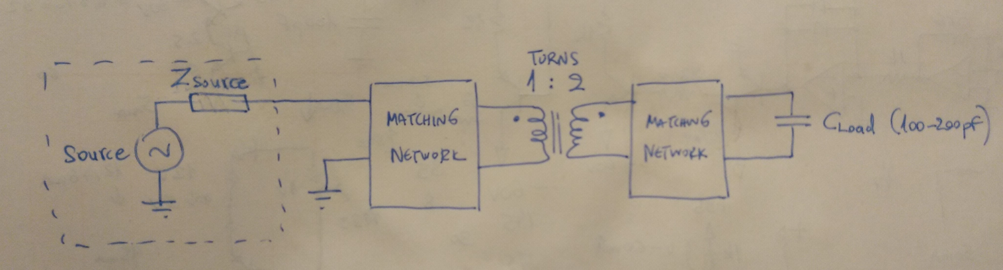

Can you post your simulation or your provisional schematic (even if it is embryonic or rudimentary)? It will serve as a concrete base for discussion, otherwise we are going to waste time in irrelevant generalities.
Note that simulators can simulate actual transmission lines, there is no need to resort to a lumped model.

Both for simulations and for hand calculations, you can either model a long cable as a transmission line or as a series of short lines that are all modelled as LC sections. Modelling it as a transmission line is usually easier, but do whatever you find more convenient.

The magnetizing inductance is in parallel with the transformed load impedance and the leakage inductance is in series with it, so ideally you want the impedance of the magnetizing inductance to be much greater than the transformed load impedance and the impedance of the leakage inductance to be much smaller than the transformed load impedance. Good transformers have a large ratio of the magnetizing inductance to the leakage inductance, but the ratio is always finite. When the ratio of the highest frequency of interest to the lowest frequency of interest is very large, it gets difficult to manufacture a transformer with high enough magnetizing inductance for the lowest frequency and low enough spreading inductance for the highest frequency - which is one of the reasons why good audio transformers are so expensive.
Here is the schematic.
The capacitive load could also be a piezo element (I know it has different model, and I would adjust the matching networks according to it).
I am not being lazy in simulations, I love them, and I will simulate a transformer once I have its data (for RF, they come in s-parameter form). I just want to know what to look for, the theoretical background, for obvious reasons. Maybe even if there is not something suitable in the market I could wind one on my own.
MarcelvdG: Then it is close to what I imagined, so maybe I would have to consider transformers with high-impedance primaries for my purpose (that is, low magnetizing inductance).
What I did not illustrate in the schematic is a coax cable going to the load, but I considered it part of the matching network as a block diagram, I hope it is not confusing.

As is often the case, the devil is in the detail, and your block diagram leaves many important (quantitative) details out.
For example, what importance has the fidelity: the transmission of the edges f.e., and how fast are the edges?
If you accept clean and soft edges of 100ns, when the original waveform has 10ns, you can use the leakage inductance constructively, in combination with other equalizing passives. If you need a perfect fidelity, things are going to be more complicated.
From the few elements you provided, I think that if your driver has a ~0 output impedance, you can probably get away with a directly driven transformer, followed by a 50 ohm resistor to drive the cable and the piezo transducer: the 50R should tackle the back reflections and tame resonances induced by the non-ideal Xformer parameters.
Of course, all of that depends on the actual, quantitative parameters.
Opting for a cable having having a Zo>50ohm could probably help: some less common types of of cables have a Zo in the hundreds of ohms.
You model the piezo element like a simple capacitor; that's OK if you operate it very far from its mechanical resonance, but it is completely wrong if you work at or near a resonance (electromechanical devices have many resonances).

For a 2:1 transformer, you can use a bifilar transformer wired as an autoformer: it will have a very low leakage, and a low voltage CM choke can be used. They are cheap, common and come in infinite varieties.
They do not tolerate DC component though (that will be the case with all transformers having a very large magnetizing/leakage inductance ratio)
If you put flesh (numbers) on the bones, we can help you select the right components.

As I mentioned in previous posts (but wasn't clear about it) I would like edges in the territory of 20ns, which means a 50-100 MHz bandwidth, and that is why I asked in the first place.. A little mistake could lead to unwanted response. So I need fidelity, yes.
About the load, I know the piezo model, I have used one in the past, and since my base frequency is at 2.5MHz and this one resonates at about 13MHz, possibly (haven't constructed the model yet, I have the measurements to do so and I will), I know I must properly model it and not as a capacitor. Eventually I will design the thing for the piezo, but I started from a cap, I know the difference is significant.
Its low frequency capacitance is around 70-75pF, that I know.
The waveform will be (at worse) sawtooth, meaning I will have a falling edge of 20ns (desired, if not better). And the amplitude will be 50-100Vpp at the load end, which could raise a question about selecting a proper transformer - or as you said, a choke. This seems a good idea since RF transformers found with ease are 0.25W max.
Why am I bringing this up? Charging a capacitor of 100pF with 50 in 2.5MHz sawtooth would not require more than mils of power (but current, yes, it will reach 300mA), so even though my RF transmitted power will be small, (a) I don't know if the field density will be within spec for such a current and (b) using low resistors for terminations could lead to a huge waste of power, so I would need to redesign the source to a high-power one.

As far as using a transformer or a common mode choke, is there a way of determining the appropriate values for the numbers I presented? I am currently working on extracting an RF transformer's model to gain a clue about the values of primary inductance that could be useful.
