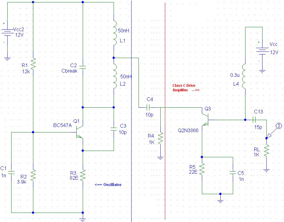

I have attached ckt diag of an FM oscillator coupled to something which i tend to call as an UNKNOWN TYPE of RF Amplifier..
I/p is provided to the collector, and o/p taken from the base.. Sounds bad, atleast to me.. I have used this part of the circuit in constructing my first FM Transmitter. The complete ckt consists of a final class C power amp (2n3866) with a stated o/p of around 1WATT, and is driven by the o/p available with the circuit that have attached with this post.
The device works, but not as completely as it should. I certainly get very little power o/p with a range of around 10-15 meters indoor, using a 100cm aerial. Clarity and freq stability is good.
I havent designed this circuit. Just tried to implement it for fun. Since it works below par, i m now trying to analyze it.
If anyone can help me to understand that "alien" class C dirve amp., then pls reply back.
Thanks in advance.
Regards, Prasanna Prithviraj.

I can't see as it can work?, and from what you say it doesn't work! - which isn't suprising!.
The range of just the oscillator part should be around 100m, basically it's probably just working with radiation directly from the oscillator section.

Agreed! I once built a 1W FM band 2 transmitter about 20 years ago, It could be received up to 4 miles away on a good day and in the direction that favoured good propagation!

Thanks for the reply. So, i have modified the amplification section be simply using a Class A emiiter follower. The AC power dissipated by the load RE is about 200 mW at 12 Volts Vcc. I have posted the complete circuit here.
However, the range has not improved at all. Is there a problem in the antenna coupling ckt. (i havent used much of it eighter)..?

An emitter follower gives no voltage gain, so you're not improving anything (apart from warming a resistor). It's usual to use a class C amplifier with a tuned collector loading coil, probably with a tap to match the impedance of the aerial.

Is 75cm a quarter wavelength antenna at your operating frequency? If so I take it you’re operating at approximately 400MHz. I hope your not doing this on a breadboard… For an FM system I think a Class-C amplifier will be the way to go [75% eff. Max]. When you design the input stage of your amplifier make sure it has an input impedance of at least 50-Ohms otherwise you could kill your oscillator by loading it down too hard. A 50-Ohm impedance matching band-pass filter on the output would also be wise.

Alright, I would use an LC tuned ckt for the final stage. But how can i approximately calculate the RF power that the final stage would provide, as i may require that during designing.
As one final question sir.. My receiver detects the transmitted information at about 3-4 different frequencies (even though the reception at all; expect my actual transmitting frequency would completely vanish if i move 4-5 mtrs away from the Tx). Is it due to my cheap BC547 having slightly less Ro, which destroys the Q factor of the LC tank..?

It's usual to specify the DC input to the output stage, you can measure the current and voltage simply with an ammeter and voltmeter.
If it's transmitting harmonics it may be over driven, but a second tuned RF stage will help to reduce that - but you should also try lowering the first stage, try adjusting the bias conditions.

There are too many problems surprising it does not work. the coupling cap between stages is missing secondly its an emitter follower no gain .
make the o/p class C do a google on veronica and other FM tx design they are proven and good.
Need to transform the O/P impedence to 50 ohms
O/P impedence V*V/2Po
Use LC ratio to match.
