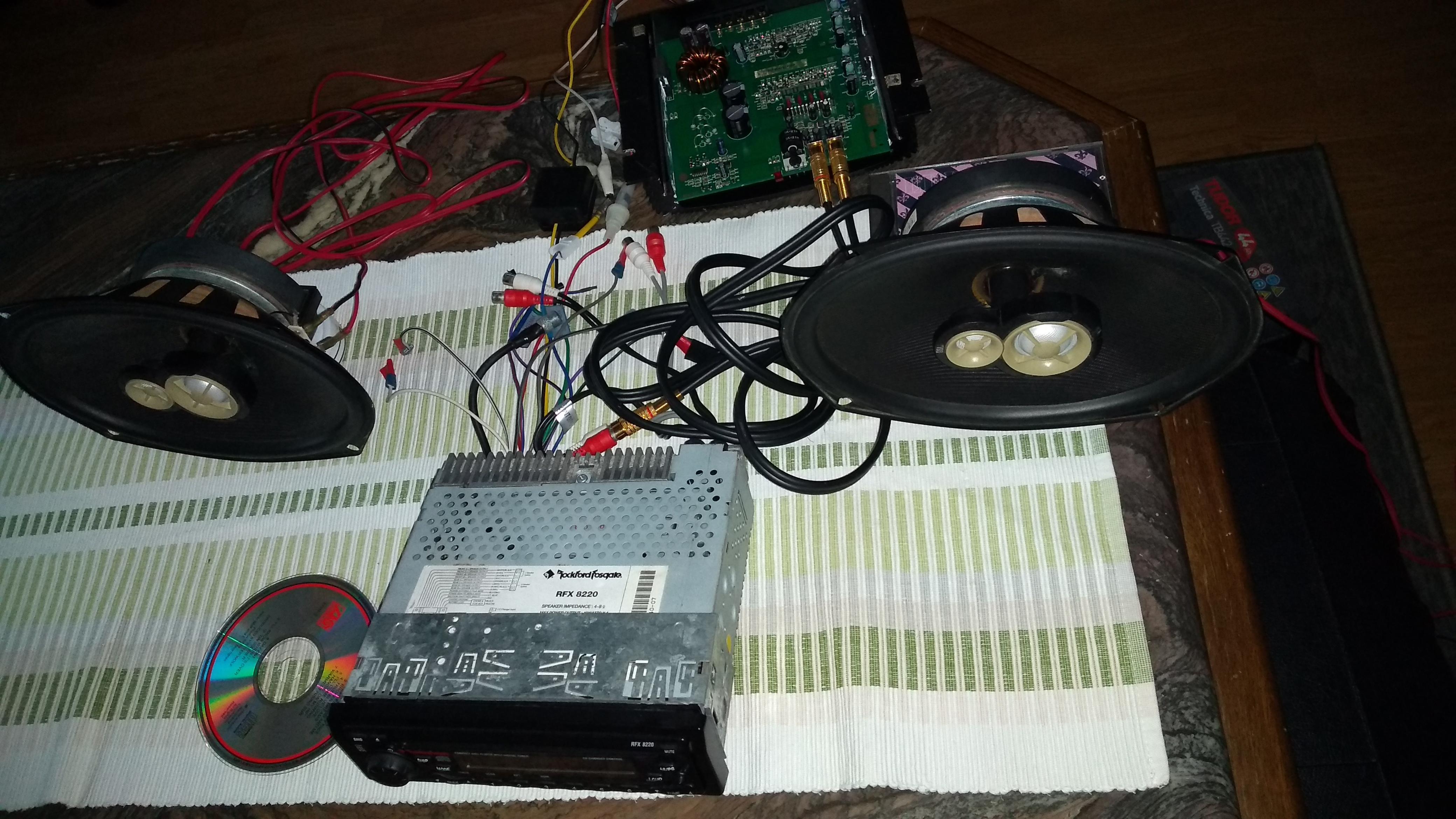

this is my temporary test equpment.speakers are jbl,and headunit rockford.this headunit i bought on a auction site and is was defective then i got it.i repaired myself,can i do a post like a guide how i did ,to give some back for all help and intresting things on this board.
