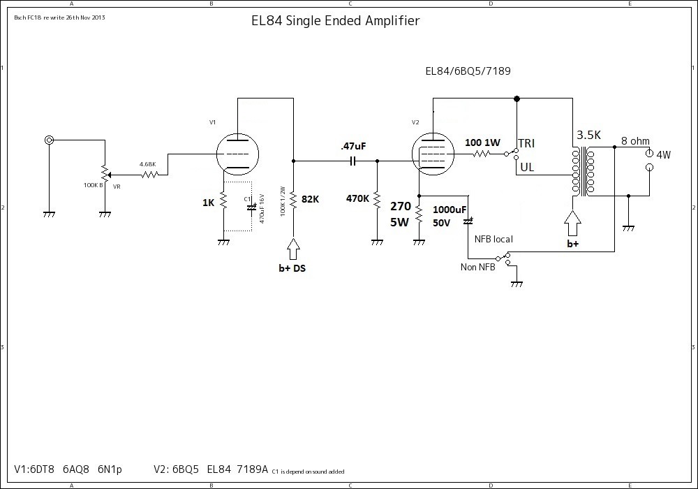

Greetings Friends. I've reworked the schematic for the SE EL84 project amp I posted a few weeks ago. Someone pointed out that the PT is under-rated for the current demands and might not have a long life. Looking at the EL84 datasheet, I see that the current demands of an EL84 wired in Triode mode are ~10-12mA lower than that of Pentode mode:
So I'm thinking I should swap some 270 ohm 5w resistors in there and rewire things til they look like this:
With the larger K resistors, I expect b+ to increase, and I will have to add a dropping resistor before the choke in the power supply. Should still have a margin of 15mA or so.

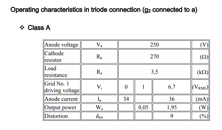

The datasheet shows the Load Resistance of the tube drops from 5k to 3.5k in triode mode. I do have a pair of Edcor GXSE10-3.5K I could swap in with a minimum of chassis rework, or just leave the 5k in there. And I still have the switch I could use to select between triode and UL if I really needed the extra volume.
I'd end up with something like the Decware triode amp. Whaddya think?

I'd leave the 5k in. Does your power transformer get very warm?
With 3k5 load, the distortion at least doubling (vs. 5k).
If you connect 1000uF to output (where did you see this .... ?) both the LF and HF behaviour will degrading.
Estimated power (even with 3k5 load) rather 1.5W than 4W (in A1 mode, in this operating point).
p.s. Which type of OPT do you want to use?

Yup, no way getting 4W in A1. 5K results in a slightly lower output power but lower distortion.Estimated power (even with 3k5 load) rather 1.5W than 4W (in A1 mode).
The trouble with these UL/triode option switches is that it take 2 or 3 flips to decide which is preferable and it's always the UL mode. The two modes really require two different OPT primary Z's. If you will do some research on UL you'll find that to get the most from it you need an OPT with 23% screen tap. You still need to rework the 6DJ8 operating point, too, instead of the starved condition you are trying to run it in. Your PT will drive a conventional amp with pentode mode and a 12AX7 with no problem, and you can use some GNFB, too.

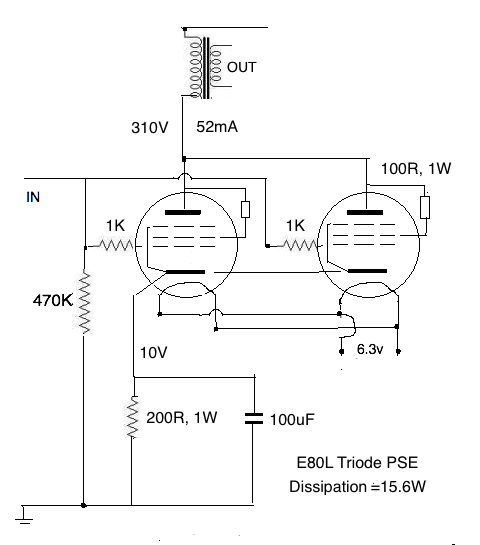

I'm putting together an EL84 triode type PSE amp, and you may decide that a couple in parallel would lower the Rp and give you a bit more power.
Since a pair will give me enough output I'm going to use E80L instead of EL84. That's a nice valve, different pinout, gold pins. Just one idea.

More B+ current from the same power transformer?
