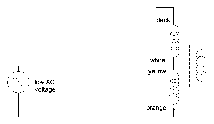

I´m trying to rewire a Presonus ADL 600 from 110v to 220v. I know the primary/secondary have to be in serial, but I´m not sure on the exact setup of this transformer, so I´m a bit lost.
Wire colors are white / black / Yellow / Orange
There is an 8ohm resistance between yellow/orange AND also between Black/white.
With black/white tied together (shorted) - the resistance between yellow/orange is 14ohm
Photos of wiring here:

The white-black winding is one half of the primary and the yellow-orange winding is the other half. You need to find out which is the start and which is the finish of each of these windings to ensure you connect them in correct phase.
Based on the above, I would expect that if you connected any of the following you would yield 16 ohms:

How do I find out which wire is the start of the winding ?
I actually got the amp to run with the black/white shorted and yellow/orange connected as before. That config gave me 110v on secondary.
I´ve also tried shorting the yellow/orange, that gave me 220v on the secondary, but (close to) 0v on the pcb board outputs, so I´m guessing that was out of phase. (amp did not run)

rewireyour tranfo as shown below ( dont forget to use low voltage supply anythimh from 5 to 60 volts will do ).
measure voltage between yellow & orange should be equual to your supply.
measure voltage between white & black should be equual to your supply.
measure voltage between black & orange must be twice your supply.
if twice your ok, if not reverse white & black and test again

build or get someone to build for you a Mains Light Bulb Tester.
The idea is that you plug in the mains light bulb in series with the unit to be tested.
If there is a wiring fault then then bulb lights up and drops almost all the mains voltage safely.
The little voltage and current that remains passes safety throught the equipment without causing major damage or blowing anything up.
It works especially well when trying to fathom out the phases of a twin primary transformer.
