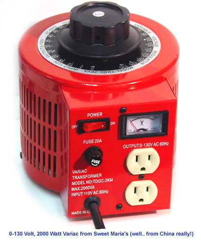

You can use a Variac, like the one shown in the photo below.
You can but they're not cheap.
If you have a large step-down transformer, but the output voltage is a little high, think about adding a "boost/buck" transformer.

The heating caused by faulty bias is a separate issue from the heating caused by excessive magnetising current, The bias will heat the heatsink the magnetising current will heat the transformer, make sure which problem you have first.
Variacs are often used by Japanese when overseas. Off the shelf 240 - 100V transformers are not common, they are usually supplied with a Japanese machine. As another poster mentioned bucking the voltage by 10V is easy enough and the transformer will be relatively cheap.
