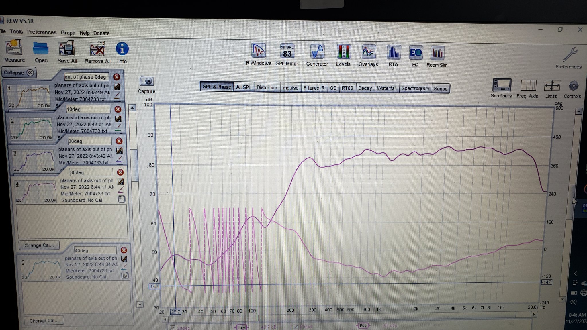

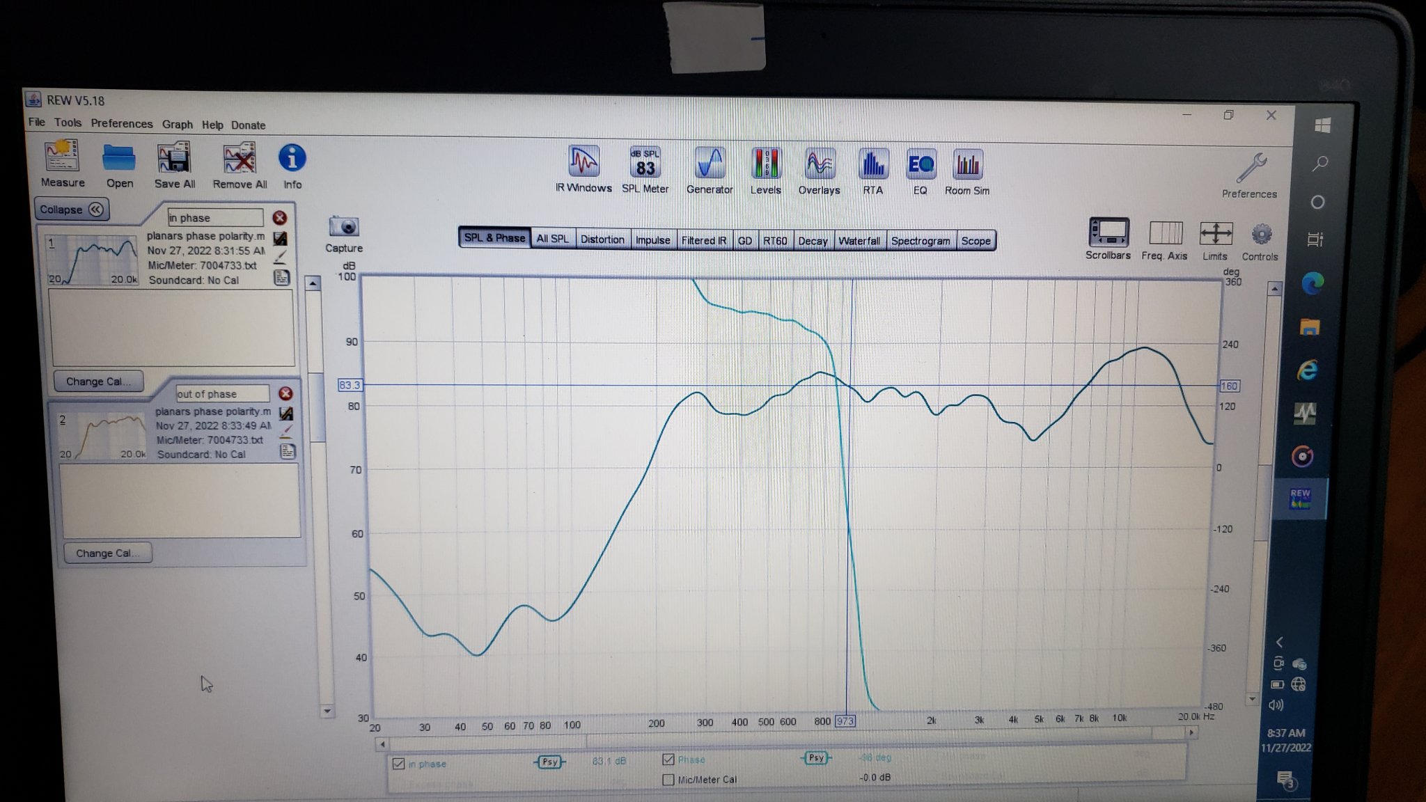

Do you think it is possible to visualize the phase difference between woofer and tweeter with REW?
if the answer is yes, how?
Just like fr response, phase is shown as a line from 20Hz to 20kHz, if you select it. You may select 2nd harmonic, 3rd and so on. Its totaly up to you.
Phase will typically deflect for the tweeter and woofer out of their optimum range. You may decide to 'unwrap' or 'wrap' the phase.
Have you read the instructions to REW? I guess not.
Midrange and tweeter, same polarity, phase goes to hell, plus the dip in crossover.

You really need something that can display a live IR to see phase and average it without using a vector…
Perhaps smaart or a dual ch fft box would do it.
REW will show you the measured phase at that one tiny tiny tiny tiny tiny spot…
If you want it to mean anything a few averages are necessary…
I use a 4 mic smaart rig with all TFs averaged around my head….
It works great .
