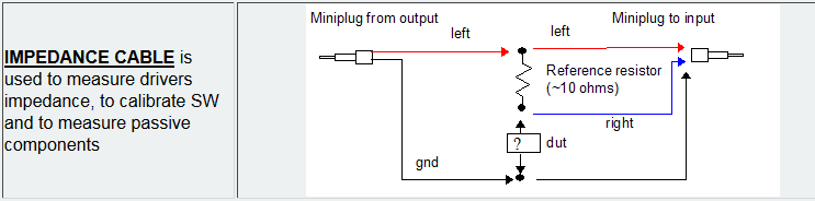

I'm not sure if this is the best sub-forum, but I have been having trouble getting my DIY Impedance Measurement rig to work.
I have followed the circuit/design here:
Using a Behringer UCA-202 and the Line Outputs (with a 1k Ohm Resistor) I get the calibration stage OK, Bypassing the resistor gives 100-Ohms as below.
Imp Rig Calibration by Robert Seymour, on Flickr
When I come to measure anything from a single 10-Ohm resistor or a speaker driver, it just comes up with a blank measurement for impedance and a solid waveform (180 Degree to -180 Degree) for the phase.
Imp Trace 1 by Robert Seymour, on Flickr
I have double checked all the wiring (and my other half too) and tested that which all seems fine.
I have read that the UCA-202 is not the best, and using the headphone output gives better results but I am getting confused why I am not getting anything at all...
Is there a setting I am missing in REW that would cause this?

It's basically the same as the circuit you linked to but I find Claudio Negro's diagram a bit more intuitive. Cables

Hi Robert:
You obviously have a good handle on this. You're using an audio interface with a very weak output (low current capability) that has a 400Ω resistor on its output to protect it. Mfg's place "current limiting" resistors of this type on outputs to protect the device from the worst case - a short to ground. Better interfaces have much lower output impedances, but you can do well with what you have in this application.
Just use a 1kΩ "reference" resistor in your impedance measurement jig. The REW manual states that you'll see high noise, but that is not true with good quality audio interfaces. It's possible that 1kΩ will be too noisy with yours - you'll just have to try it. I used 1kΩ resistors for years with excellent driver impedance measurement results.
I've attached a PDF of my notes back in the day when I used Smaart to make impedance measurements. I even tried a 50kΩ reference resistor to measure audio component input impedances, but found that 1kΩ worked well enough for that at lower noise, so I changed the function of the switch to deal with measuring Pin 2 and Pin 3 to ground of balanced interfaces.
