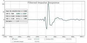

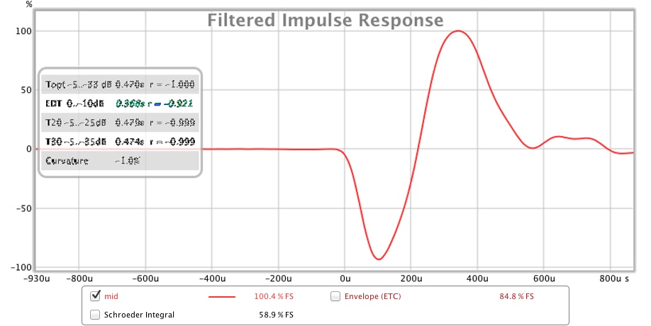

below is the impulse responses of the tweeter and the midrange (each driver measured separately using sweep 20-20k).
the time delay i must apply to the tweeter is the difference between the two peaks in ms? (295us)

I'd use about 60-75 us, then play both together in a sweep to verify the combined impulse response.
This time delay is equivalent to about 1 inch (2.54 cm) physical delay - does this sound correct? You're trying to get within 1/4 wavelength or less time offset at the center crossover frequency, then the time alignment will just fall into place.

yes this distance about 2.5cm sounds correct, but how do you calculate this time 60-75us? I thought that the two peaks must be at the same time (they are at 295us difference)
How the combined impulse response must like after the alignment?
