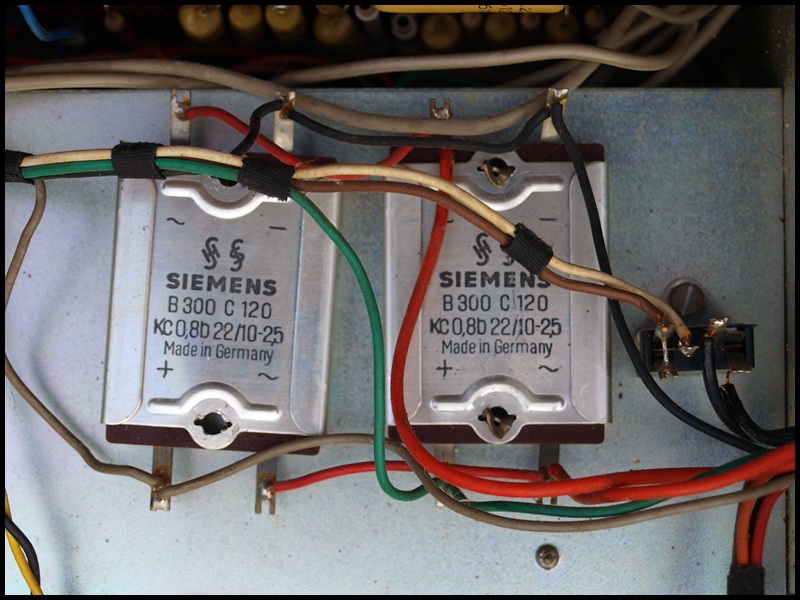

Hello all,

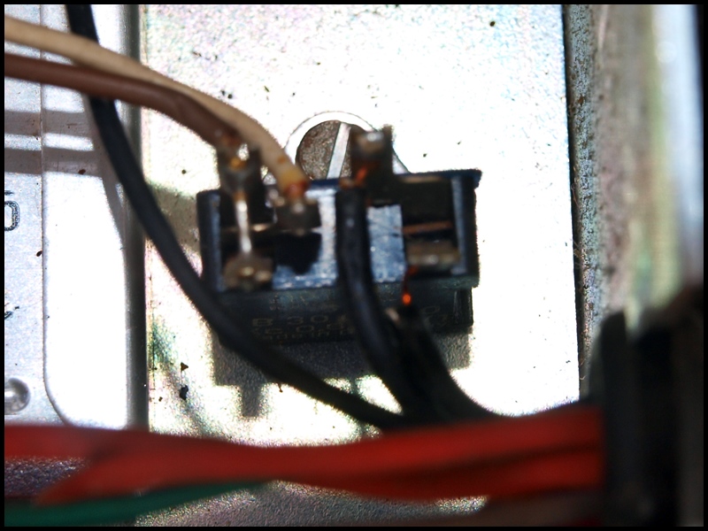

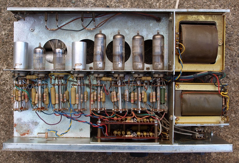

at long last I am making a start on my Revox Model 40 stereo amp. I've had the amp about 30 years but many many years ago it fizzed and popped so I put it in the loft thinking one day I would have it repaired.

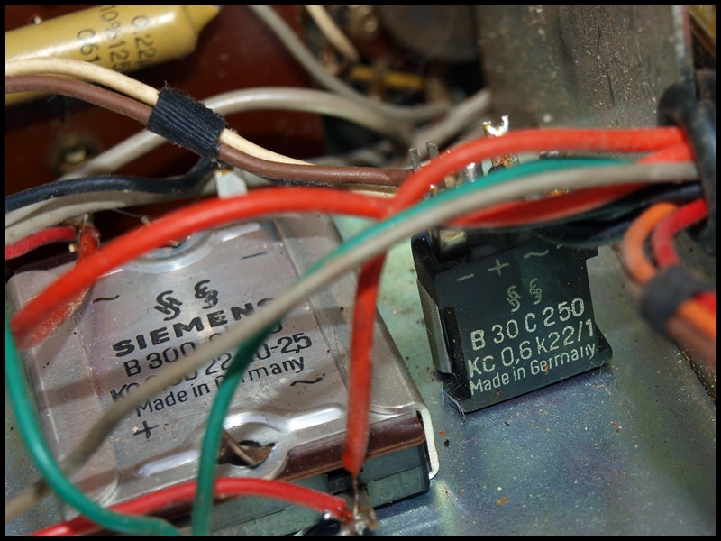

I think the fizz/pop probably came from the rectifiers as I believe they are prone to that and also they are bulged a little bit. So they are what I will do first followed by a re-cap.
I've uploaded a few pics so people know what I'm talking about.
Basically what I need to know is if the replacement rectifiers I have bought are suitable. I'm also puzzled by the smaller rectifier, it has five connections and I'm at a loss as to what to replace that with or should I just leave it alone? Two of the terminals are bridged if that helps.

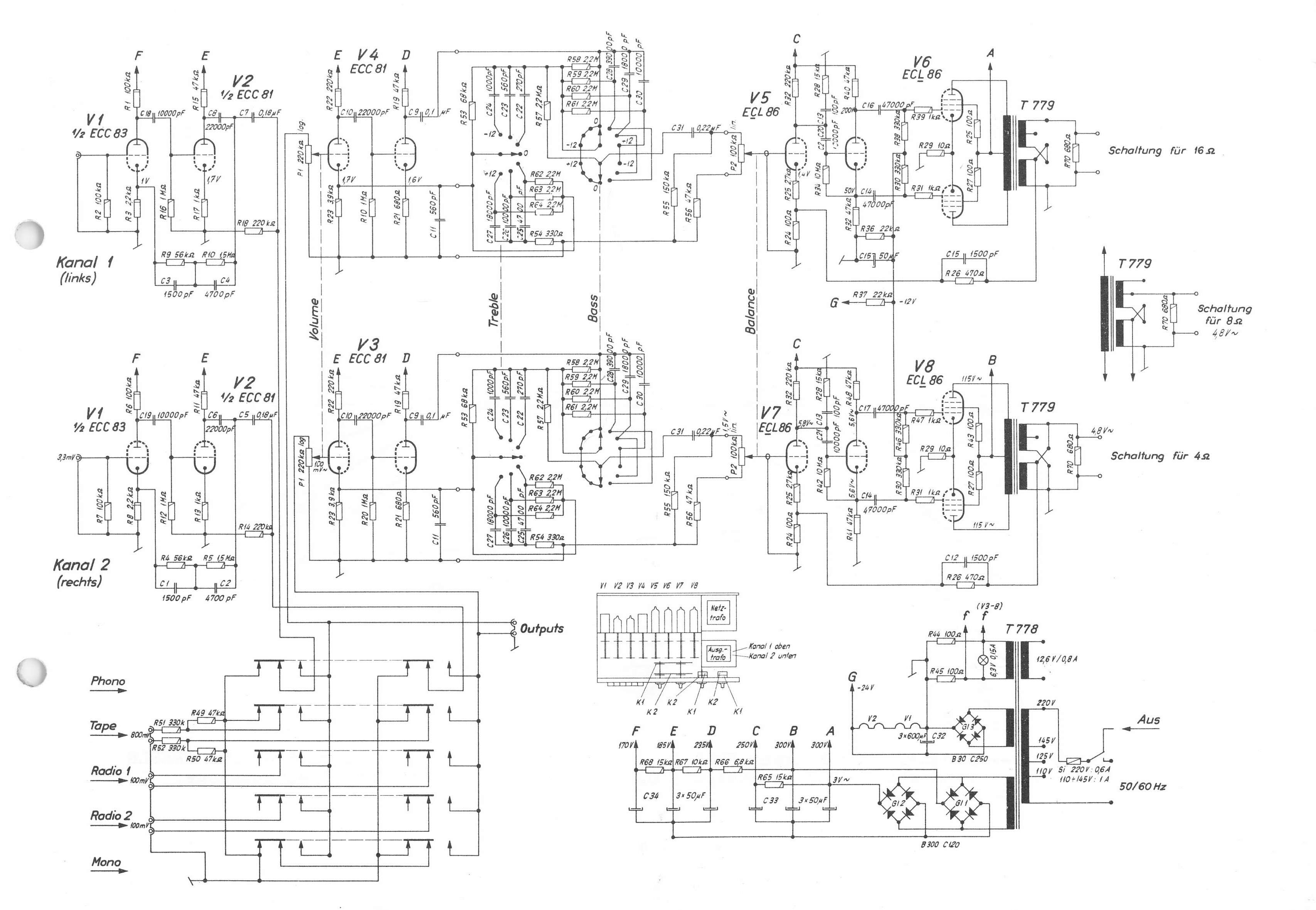

The two selenium rectifiers are wired in parallel and can be replaced with a single silicon bridge rectifier. Check the voltage rating on that rectifier - I tend to prefer higher voltage ratings. I'd recommend at least 800V or 1kV for the PIV rating even in relatively low voltage applications.
The filament rectifier can be replaced with a standard bridge with a 100piv rating or better at a couple of amps.

Thanks for the reply.The two selenium rectifiers are wired in parallel and can be replaced with a single silicon bridge rectifier. Check the voltage rating on that rectifier - I tend to prefer higher voltage ratings. I'd recommend at least 800V or 1kV for the PIV rating even in relatively low voltage applications.
Replace the electrolytic caps as well before powering up!
The bulb will work fine for protection, start with low wattage bulb. (25 - 40W)

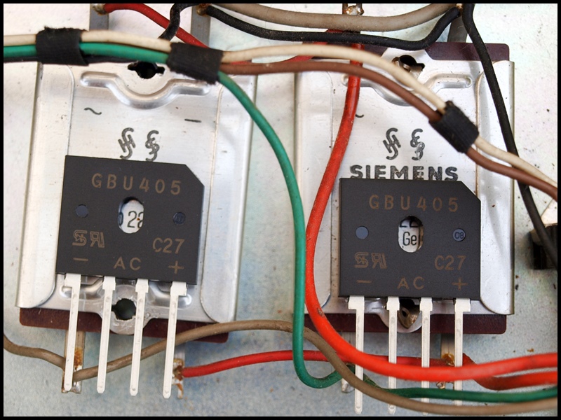

The new rectifiers I got are 4A 600V. I'd prefer to keep a pair of rectifiers if only to retain the original style/appearance.

Rectified voltages rate be higher using silicon, instead of selenium. Some additional resistances are likely needed.
The 6GW8/ECL86 is scarce. It will be difficult enough to source 4 specimens of the same brand, let alone a well matched quartet. The OEM schematic shows truly fixed bias. IMO/IME, that needs to change to a configuration with 4X bias trim pots., to deal with the reality of poorly matched O/P tubes.
Studer used the phono section heaters as resistors in the bias supply. I would bridge rectify the apparently unused 800 mA./12.6 V. winding with 4X 1 A./50 PIV Schottky diodes, cap. filter the resulting "raw" DC and regulate the rail with a 7812 3 terminal regulator, to obtain high quality DC for the phono section heaters. Isolate those heaters totally from the signal circuitry.

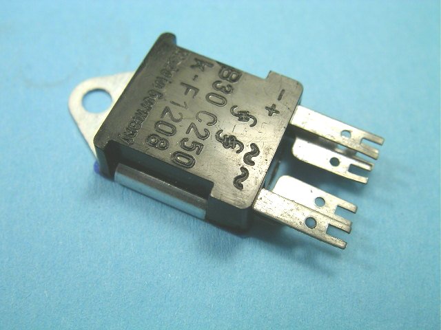

If I do go ahead what do you suggest I use to replace the G13 rectifier? It has five terminals although two are bridged.replace the GI 3 bridge too I think is a good idea too.

Selenium rectifiers are ticking, toxic, time bombs. It is a matter of routine to replace them with modern, silicon, parts.
As for the G13 bridge, 4X 1 A./100 PIV Schottky diodes will be a superior replacement. Unlike PN junction diodes, Schottky diodes don't exhibit a reverse recovery spike. Therefore, Schottky diodes are "noiseless".

Thanks for that. I understand how to connect the four diodes up but what about the fifth connection? That's the part that has me stumped.Selenium rectifiers are ticking, toxic, time bombs. It is a matter of routine to replace them with modern, silicon, parts.
Ian.
Mihgt be the fifth is a shield connected to earth? I replaced it long ago, no memories left
Thanks for your reply.Mihgt be the fifth is a shield connected to earth? I replaced it long ago, no memories left
The fifth terminal is unmarked but the wire bridges across to the - terminal so I wonder if they both make up the - side of the rectifier. There are only 4 wires attached so hopefully a modern four terminal rectifier will be the same. Detailed information (in a language a simple northern lad like me understands) about the B30C250 is hard to find but here is a picture I found where you can just make out the fifth terminal.
Ian.
Thank you. That's exactly what I needed to know.You can safely ignore the 5th terminal.
