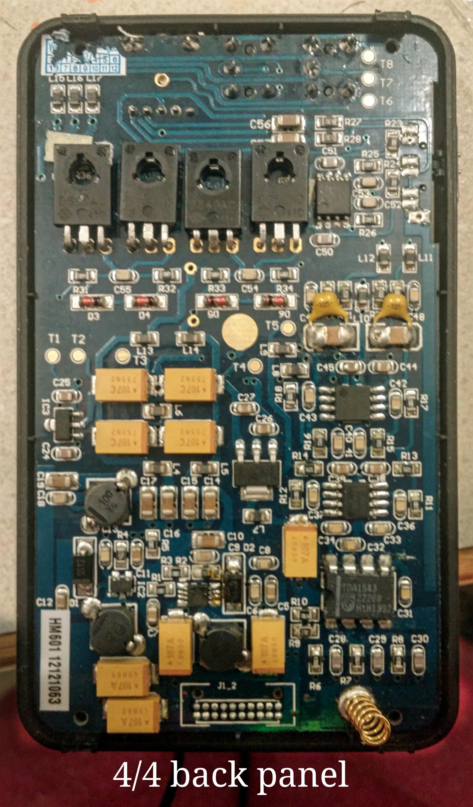

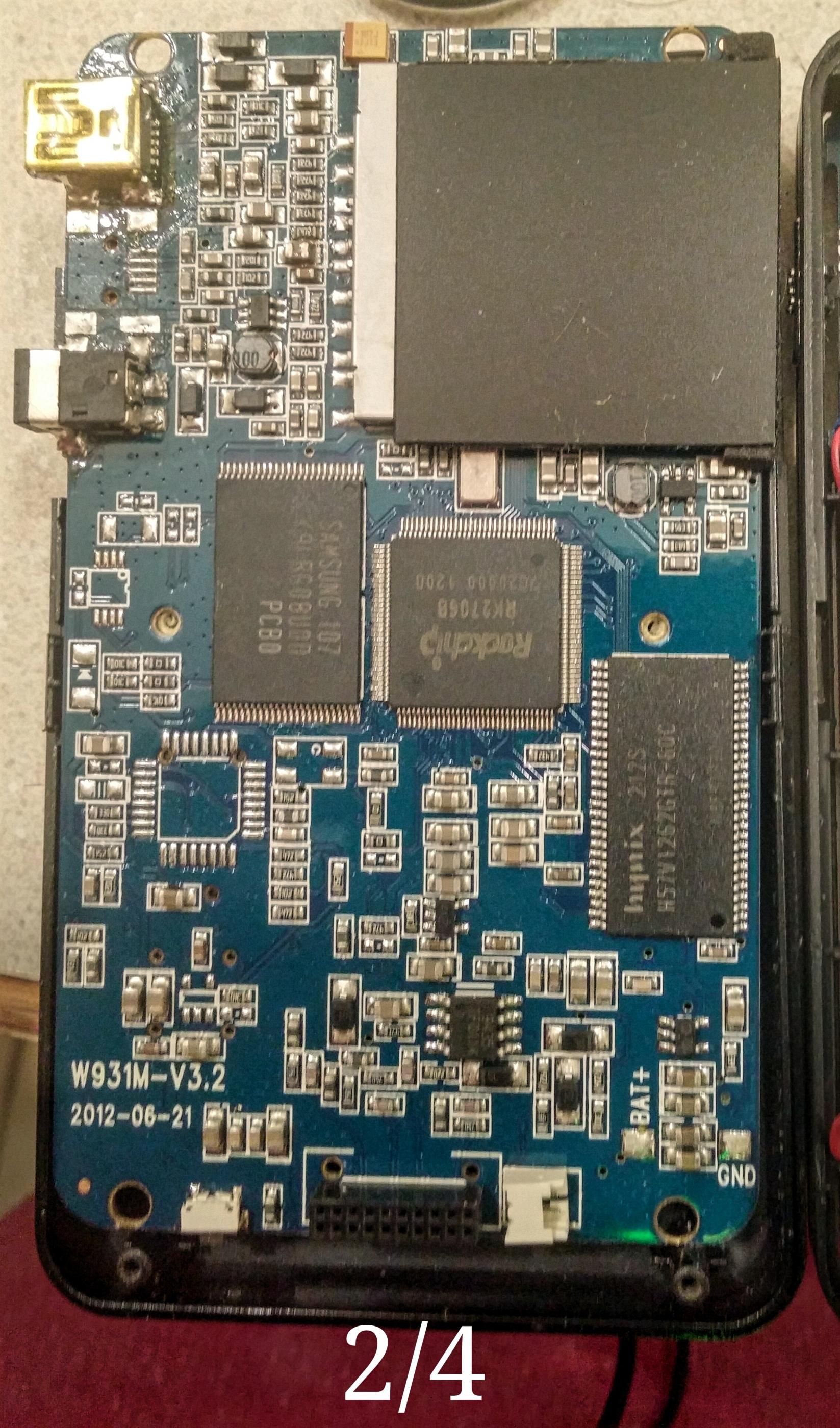

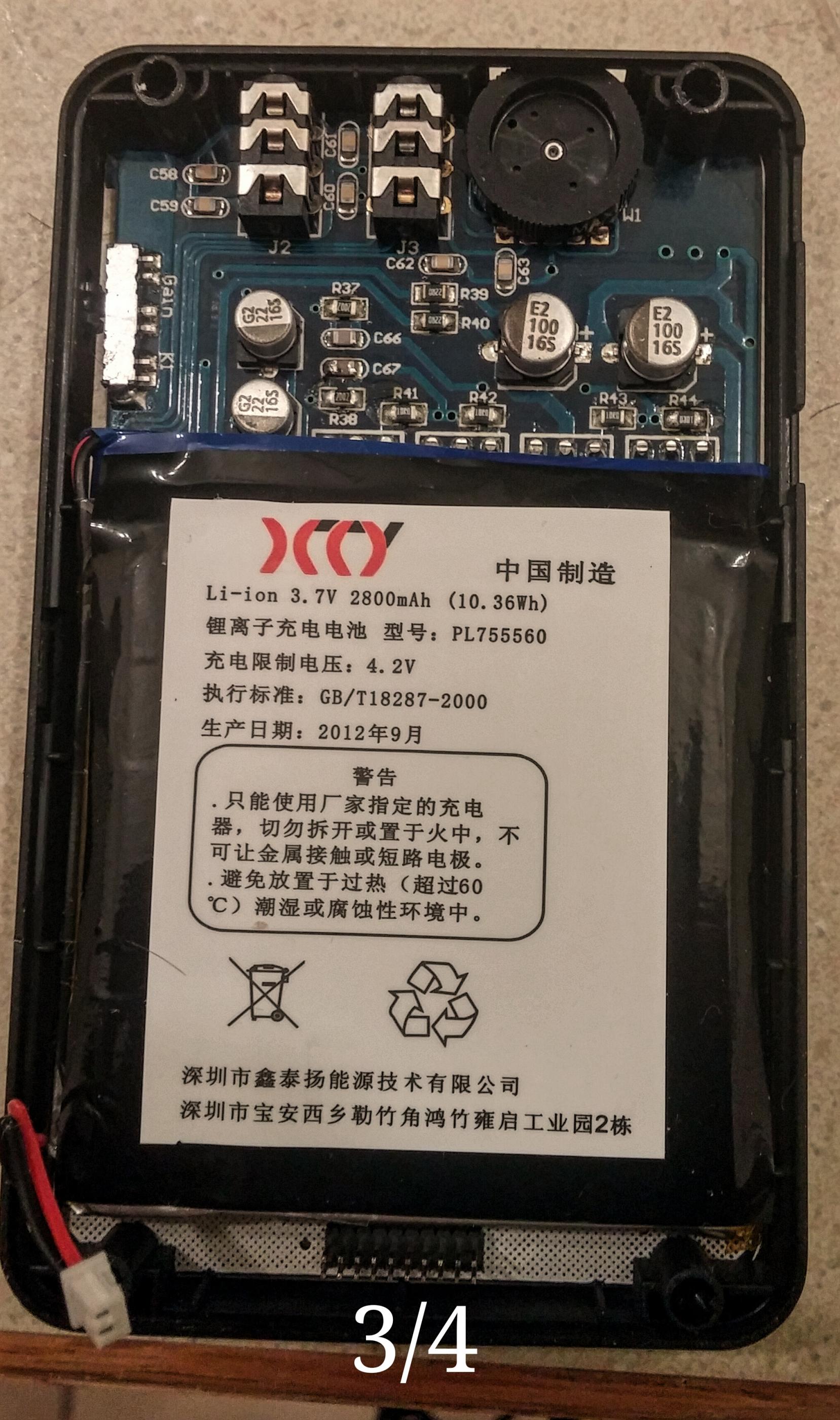

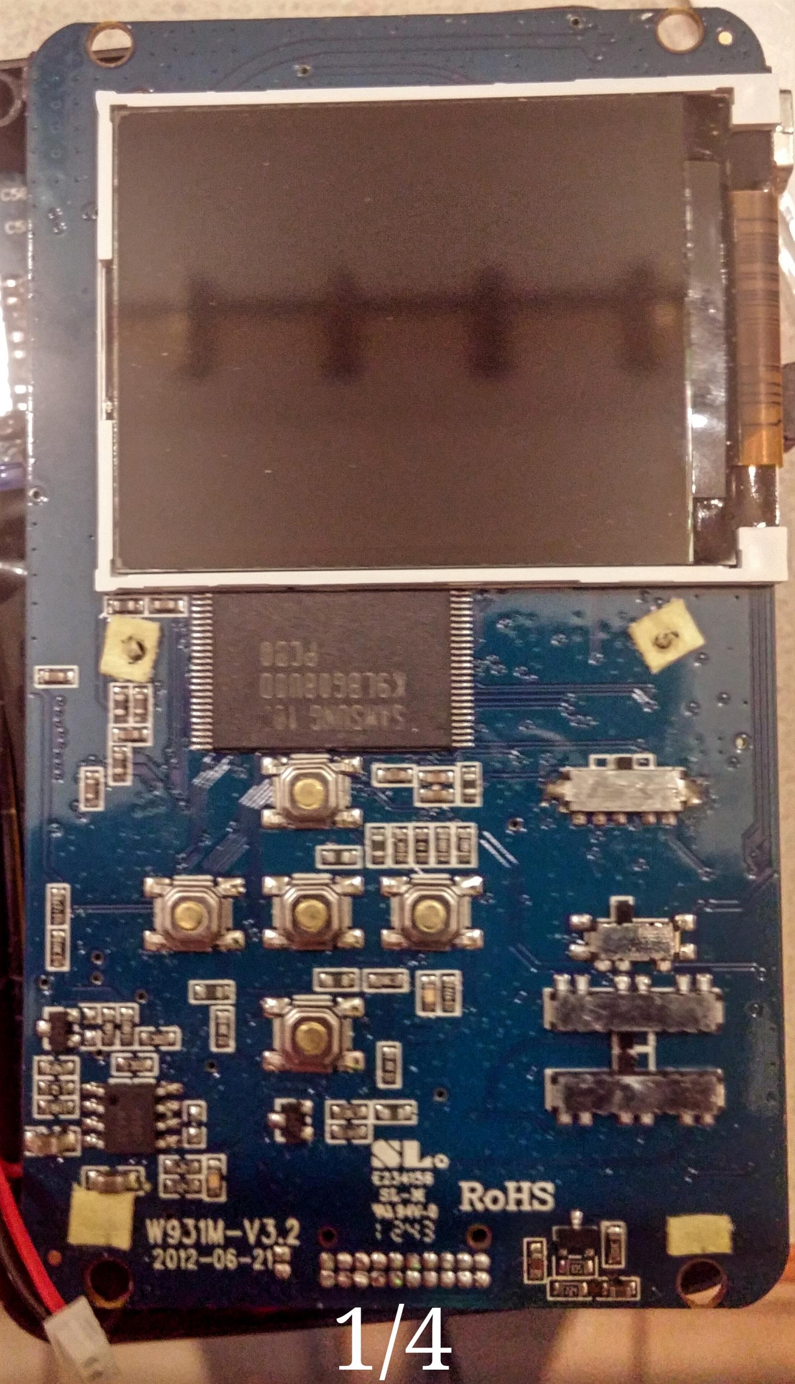

What components, if any, can I assume to be faulty? I'd think the battery would be a good place to start, and I'm sure I have another 3.7V one to try, and I'd only be a little surprised if that was all it took. But when it isn't, what then?
I don't know how helpful this will be, but here are photos of all relevant circuitry:

A quick scan of your pics shows up some discolouration to the north and east of the 8 pin IC in the switching regulator region on pic number 4. Down at the bottom just above the inter-board connector. It would make sense that there would be a boost reg there which could have been over-voltaged.
Thanks for taking a look abraxalito! Do you mean toward the bottom of the pic towards the center, just left of the C9 rectangle?
I'm looking at C9 and that component looks like it might have overheated. Surrounding components are suspect as well.
Try to identify whether there is a picofuse or similar somewhere on one of the boards that may have opened.
