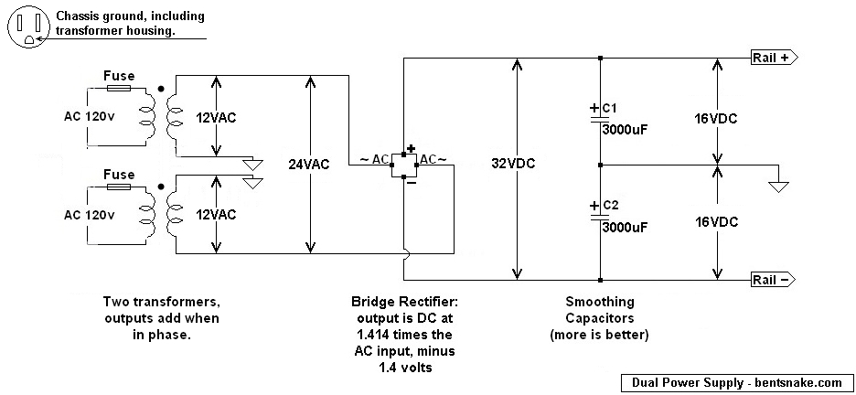

I'm trying to save not spend a lot on this project, and I have two 12-0-12 transformers (one from a dead guitar amplifier, one from a dead boom box). Can I use them in series to get 24-0-24? My only problem is I'm not entirely sure of their power ratings, as they aren't marked other than the 12v. If it helps, both were fused for 6A in their original devices, so if I go with a 6A fuse in my power supply, will that be fine?

The circuit below is possibly of interest for using your two power transformers. The power available is the rating of the smallest transformer. If one or both transformers heat up, turn down the amp volume--or unplug, of course.
<< both were fused for 6A in their original devices, so if I go with a 6A fuse in my power supply, will that be fine? >>
Yes. The way it works is:
Transformers in series (as shown): secondary voltage doubles, amperage remains the same.
Transformers in parallel (not shown): secondary voltage remains the same, amperage doubles.
IMPORTANT: Do not wire transformers in parallel. Small phase and voltage errors can add up and cause unpleasantness. Wired in series is OK.
Additional information: watts = volts x amps = VA
