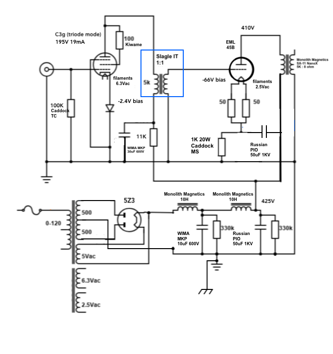

My DIY C3g drives 45B monoblock project started several months ago. With the help of several DIYAUDIO members, the idea turned into reality in July/August of this year. See schematic below.

A 11k driver load resistor and RC coupling to the output tube grid?

You could try, oh, I don't know, maybe an 11K plate load resistor and a coupling cap...
Many of us have tried and given up in preference to transformers. Cannot see myself going back.
Otoh, comparing the sound properties of transformers on different cores is very hard. I have little doubt Slagle's transformers beat the NC20 but nickel is not for everyone. It is certainly not for me.
You mean to, oooh, give a wider and flatter response for oooh, a fraction of the cost???? Hilarious!
Topic starter might try direct coupling next, like Loftin White.
By the way what is the output power?

The C3g --> 45B monoblocks are putting out about 4-5w. I am driving Ilumnia Magister speakers (90db efficient) in a 23L x 12W x 9H room. Very pleased with the drive and sound pressure from these amps/speakers. I listen to chamber music 90% of the time, with the remainder going to classic rock. At this point, I can say that I will not be returning to solid state nor push-pull tube amps. I really enjoy the sound of SET DHT. Yes, nickel is not for everyone, but to my ears it is sublime. Everyone has their own tastes. Just thought I'd share what I was experiencing. Good stuff!
Could use trafo primary as plate choke, series R between plate choke and driver plate to de-couple winding capacitance and drop required bias for output tube, would also raise minimum load impedance and increase LF response. Output tube grid to filament across LR in plate circuit of driver, remove RC in 45 filament circuit, driver plate direct to output tube grid.
Series filter CCS in driver plate supply, shunt capacitor to close AC loop to lock in bias for output tube and remove driver tube variations on output tube current with time.

You stated that your C3g--> 45B puts out 4-5 Watts.
I am reminding people that a 45B is not a real 45.
It is a new design by EML, and it can stand more voltage, more current, and more plate dissipation than the real 45.
Also, the Monolith Magnetics output transformers you use have some of the lowest insertion losses, versus many other brands that are commonly used by those who can not afford the Monolith models.
Your amp is in Class A2, the EML 45B can safely draw some grid current.
For a real NOS 45, probably not a good idea to do that.
Some newbee (or others) might burn out their precious New Old Stock Real 45 tubes trying to get 4-5 Watts out of them.
