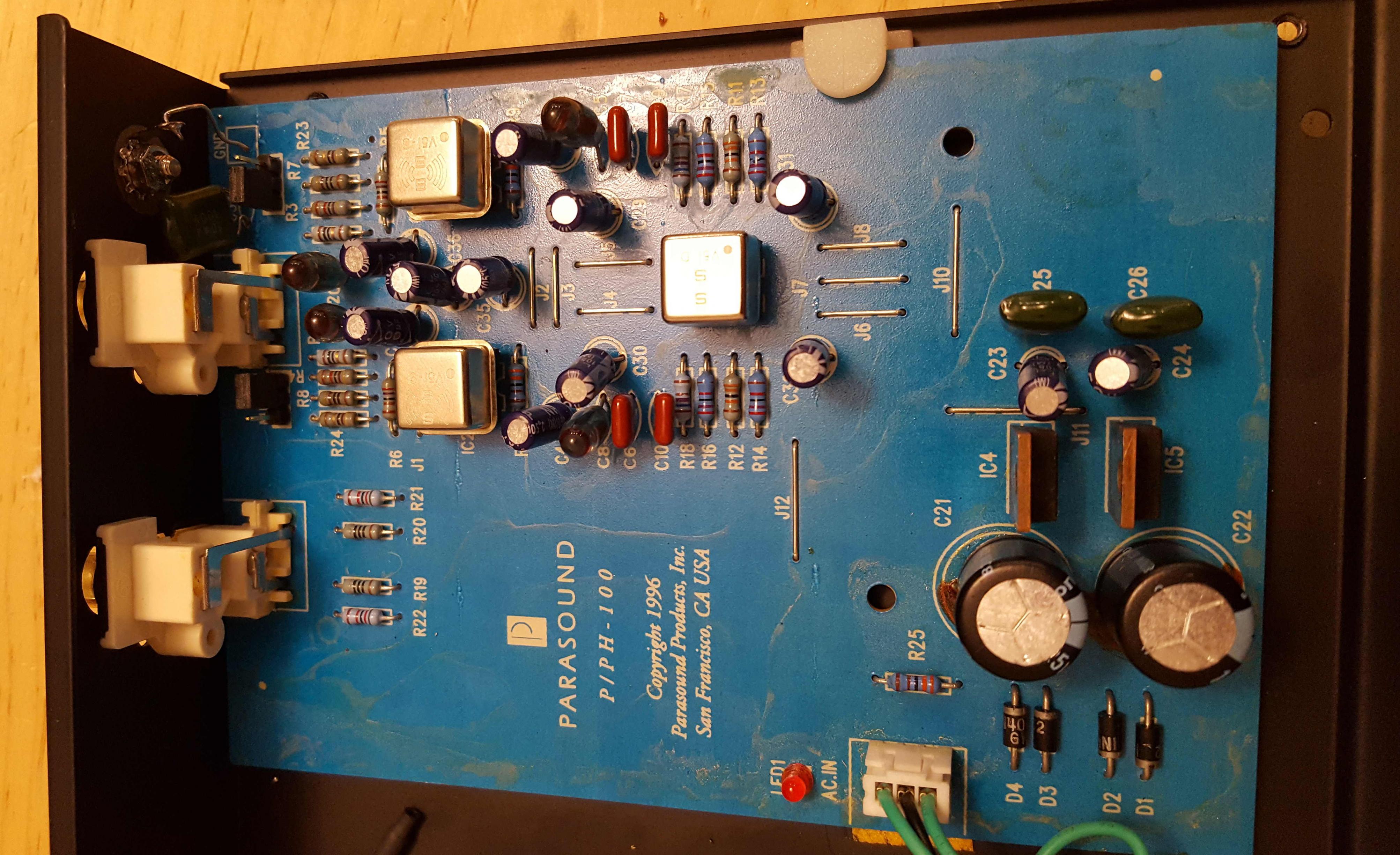

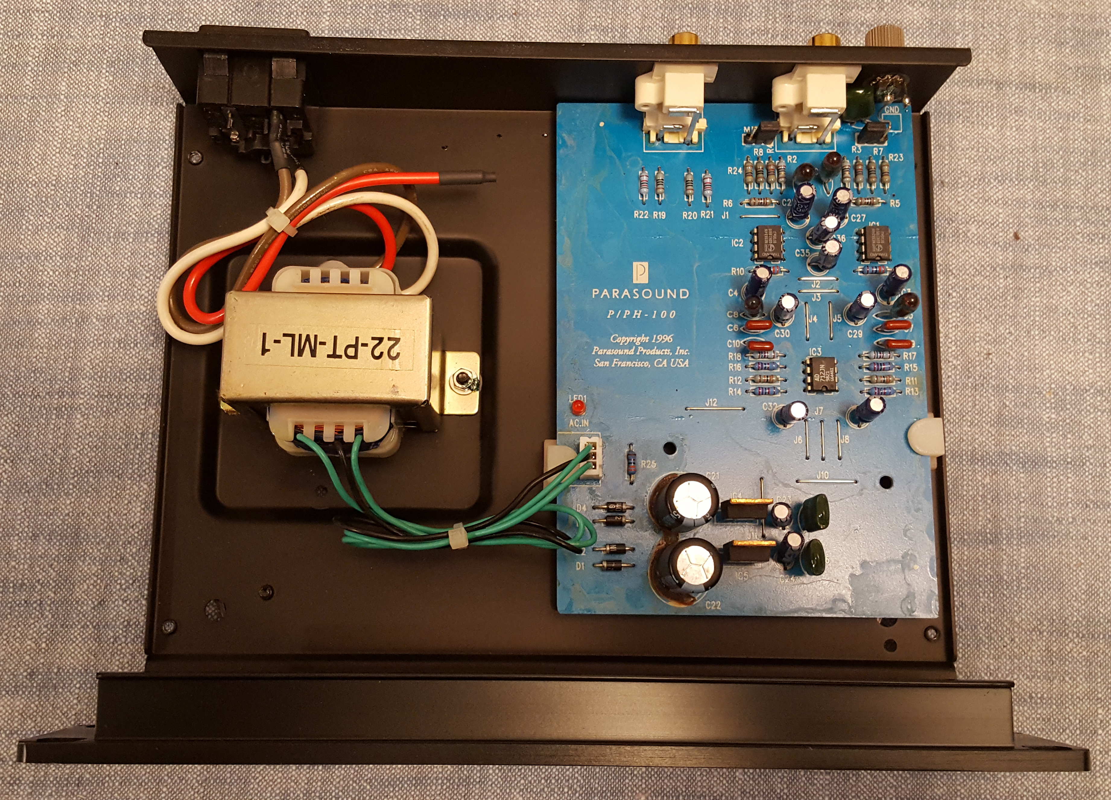

Background: I am setting out to purchase a new turntable and cartridge with something higher end than my current B&O 2400. As such, I will need a better phono stage. Eventually I will research and probably build something. In the meantime as a stop-gap I picked up a used Parasound PPH-100 which looks like has some capability for further DIY improvements (many laid out here Plexus Parasound PPH-100 Modifications). I wanted to start with the lowest-hanging fruit, being an op amp swap for something quieter and faster. This led me to discover Burson Audio and get curious about their discrete and “hybrid” discrete op amps. I decided to try out replacing stock integrated circuit NE553 op amps with Burson model v5i.
Primary test component: Parasound PPH-100 phono stage, replacing NE553 op amps with Burson V5i hybrid “discrete” op amps (2x single & 1x dual).
Testing system: Bang & Olufsen 2400 with MC20EN cartridge (moving iron, running at moving magnet gain), DIY 16 WPC tube amplifier, Monitor Audio Bronze II speakers.

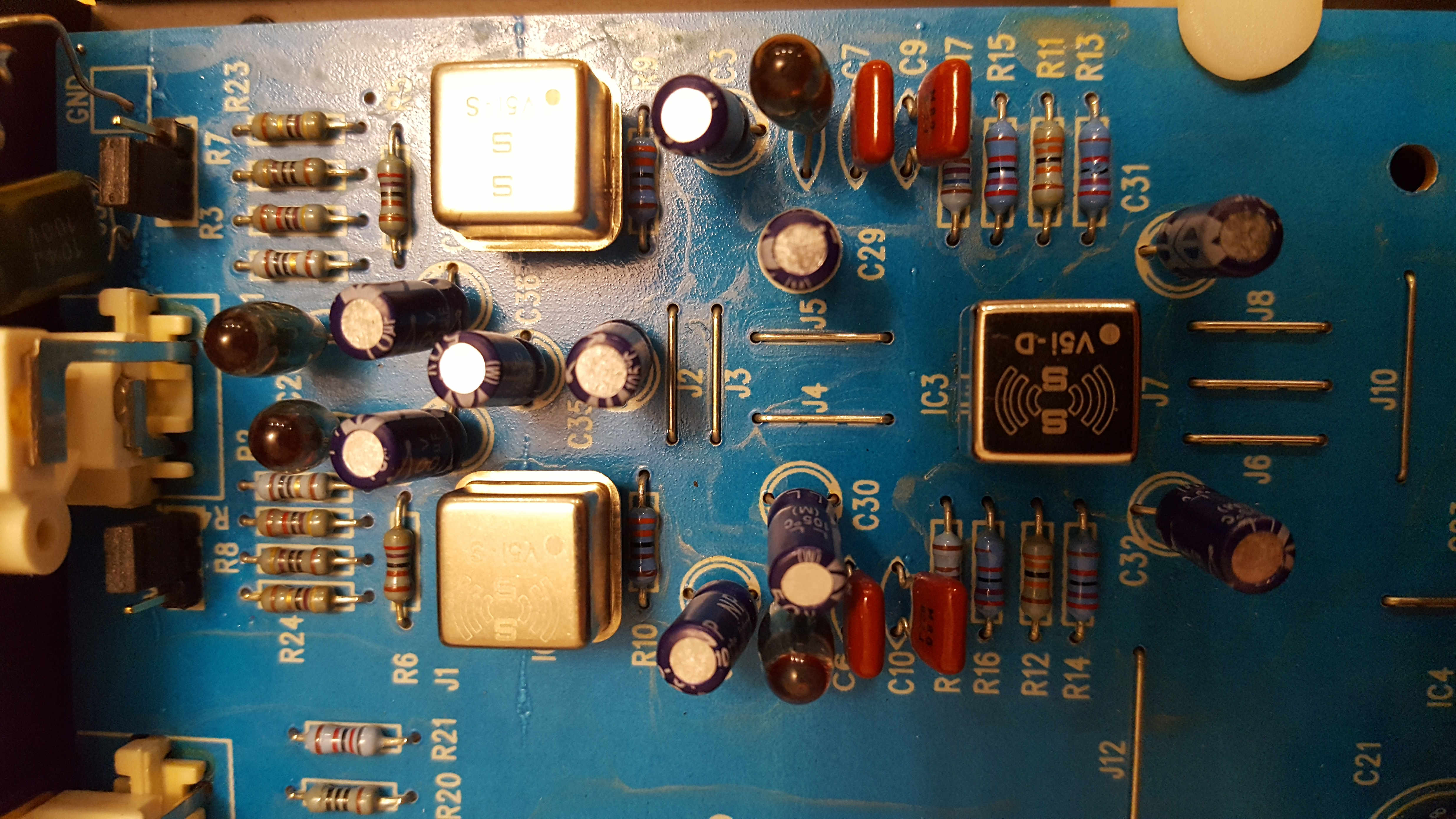

I received the op amps in sturdy packaging, soldered sockets into the PCB and placed the op amps. First impression after soldering and initial power-on is some audible hum. My tube amplifier has tone settings for bass and treble that are usually used near the top end of the potentiometers. I turned these down as well as the volume below the threshold where the hum disappeared. Turning on the source, the music plays at regular listening levels with my amplifier levels turned down significantly from where they previously were used. These op amps are putting out a hotter signal than what they replaced. It will require some readjustment to my standard amp volume and tone listening levels but has resulted in greater useful range there -- no longer do I need or wish to keep the tone levels way up. I can experiment with tuning them to my liking across the full potentiometer dials based on the source material.

Conclusion: The influence of the V5i op amps is similar through many different records and genres. Though not all reviewed in detail, I also listened to many albums across the genres and date ranges of vinyl. The characteristics of the V5i op amps are well generalized in description that they bring out lower level details that add realism and naturalism to sounds. The difference shines better in organic sounds like vocals, strings and reed instruments than in electronic music and synthesized bass (the electronic genres don’t sound any worse, just less changed by the op amp swap). There is greater space between all instruments but especially vocals. Sound volume runs hotter than other IC op amps (at least in this preamp circuit), so be prepared to potentially re-adjust volume and tone settings to adapt to new listening preferences, or perhaps even to change a resistor to readjust the preamp gain level. While the Parasound PPH-100 is one (older) example that I tested here, it is likely that other current market phono preamps in the entry-level price point also employ IC op-amps that could be improved with a substitution.
