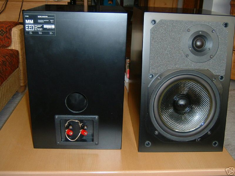

The speaker is from Reference 3a, a very early incarnation of the current model De Capo i:
Reference 3A Loudspeakers
The main driver is a hand made 8" carbon fibre midwoofer with stiff membrane and a large magnet, designed to not require any crossover at all. The tweeter in my early version is the Vifa D27TG-06-35 (I switched to the D27TG-06-46 because of a slightly softer sound), and it's crossed over just by a single 4,7uF cap and a zobel for impedance linearisation (22uF & 15R0). The enclosure is about 22l ported.

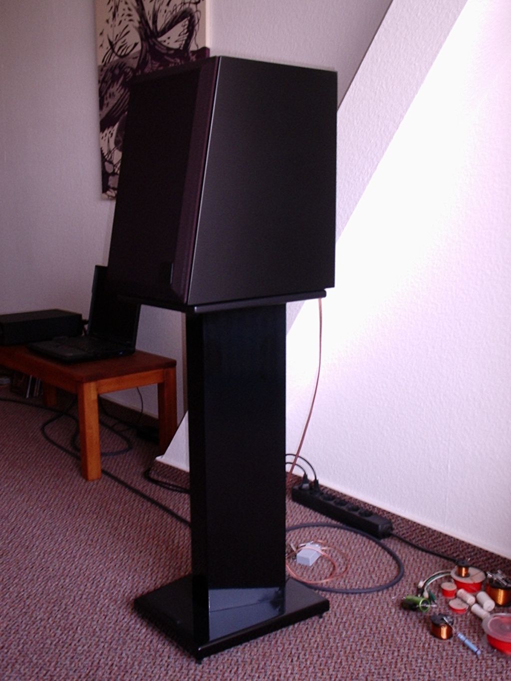

Here are some pics of my speakers. As you can see, the front baffle is slightly sloped to physically time align the drivers (at least to a certain degree).

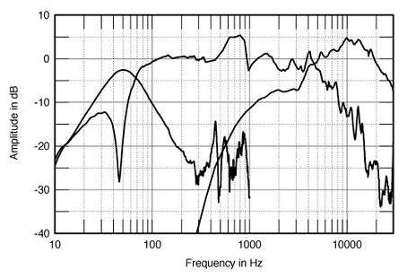

Here is a measuring plot of the direct successor (MM De Capo, no x-over on woofer, single 5uF cap on tweeter), tweeter and woofer measured separately:

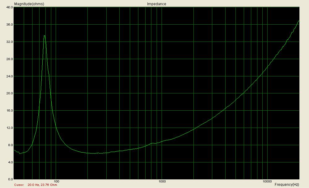

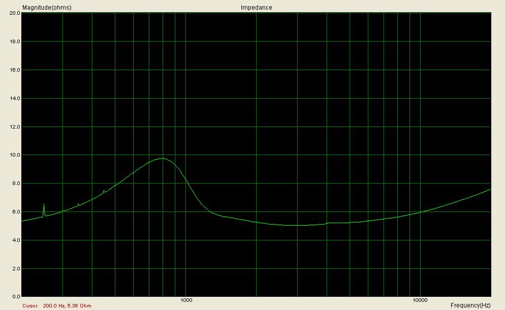

Pics of the impedance plots (measured with ARTA):
I wanted to just smooth out the upper mids a bit, so I went for a single 0,47mH inductor and the 4,7uF cap for the tweeter, without the zobel. While the result is quite good and listenable with most recordings, on some recordings I felt there could be done more. So I measured impedance plots of both drivers, calculated a bit and tried serveral reasonable crossover variants, 6dB/6dB, with and without zobel for tweeter/woofer, 6dB on woofer, 12dB on tweeter and finally 12dB/12dB, with reversed polarity on the tweeter. Due to the smooth and extended response of the woofer and because I really like the sound of higher crossed midwoofers better, the crossover frequency was always chosen within the range of 3,5kHz up to 5,5kHz.

- The oddly shaped peak around 800 to 1000Hz looks quite unusual, but it doesn't sound as bad as it looks. Somehow this peak gives the speaker its very own signature.
- As for the BSC, there is no need for that. The graph from the stereophile review is a measurement of the drivers in the box, not on an infinite baffle. There is no rise in output power towards mid or high frequencies with this woofer. Whenever I put a rather large coil in series, say, 1,2mH up to 1,8mH, the mids appear to be heavily dampend. As a result, the speaker sounds dull and very closed in. To cross the tweeter lower to fill that gap results in a typical, ordinary "2-way-bookshelf-sound", meaning that all of the openness and transparency of the midrange is gone, as well as the big image these speakers can produce.

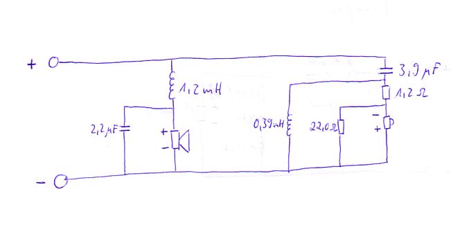

I know, this is an unusual speaker design. But the heart of this speaker really beats in the midrange. With this woofer the midrange sounds fast, clean, accurate, organic and open. Up to around 4kHz it really is usable. The problem is in the region from 4kHz to 7kHz, where the midwoofer has to pass out steep enough to prevent its cone breakup resonances from coming through too much, but at the same time flat enough to blend midwoofer and tweeter in smoothly.
Not an easy task, especially without measuring equipment. I had quite good results with the filter below: Midrange is clear and very open, resonances of cone breakup almost inaudible, tweeter blends in very nicely, the whole system sounds like one single fullrange driver, with just the right amount of "pling" in the highs and a nicely extended bottom end. It is supposed to be something like a 12dB/12dB Linkwitz-Riley, assuming 12R0 for woofer, 6R0 for tweeter and around 4000Hz as crossover frequency. Problem is, the tweeter polarity has to be reversed, otherwise there is a clear dip between woofer and tweeter. But with reversed polarity, I have this odd feeling of a less colorful presentation. The sound of this "pling" in the high end region just seems to be a bit "greyed out"...

funny you now start giving the circuit details.
my last post above yours and looking at the original design, should give you direction to proceed. ditch the 2nd order, BTW yes there is BSC built in the circuit shown.
Well, I wouldn't call this my "secret circuit". It's just one possibility. As for the BSC, I can also use 0,82mH and 3,9uF for the woofer, still good results, but phase integration seems to be not that good. With filters going towards Butterworth characteristic it doesn't matter that much how the tweeter is connected, the results are always inferior to the LR alignment.
