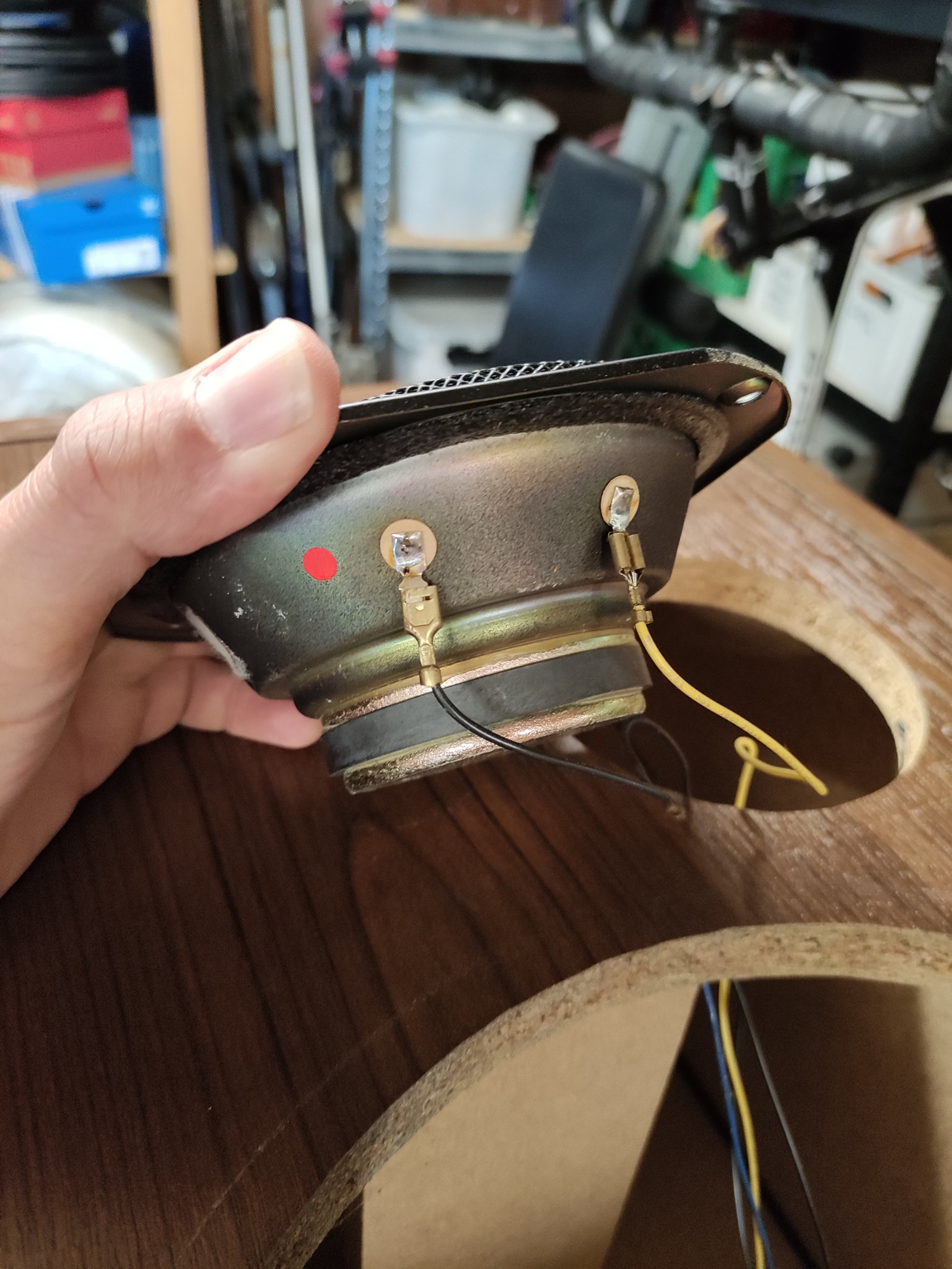

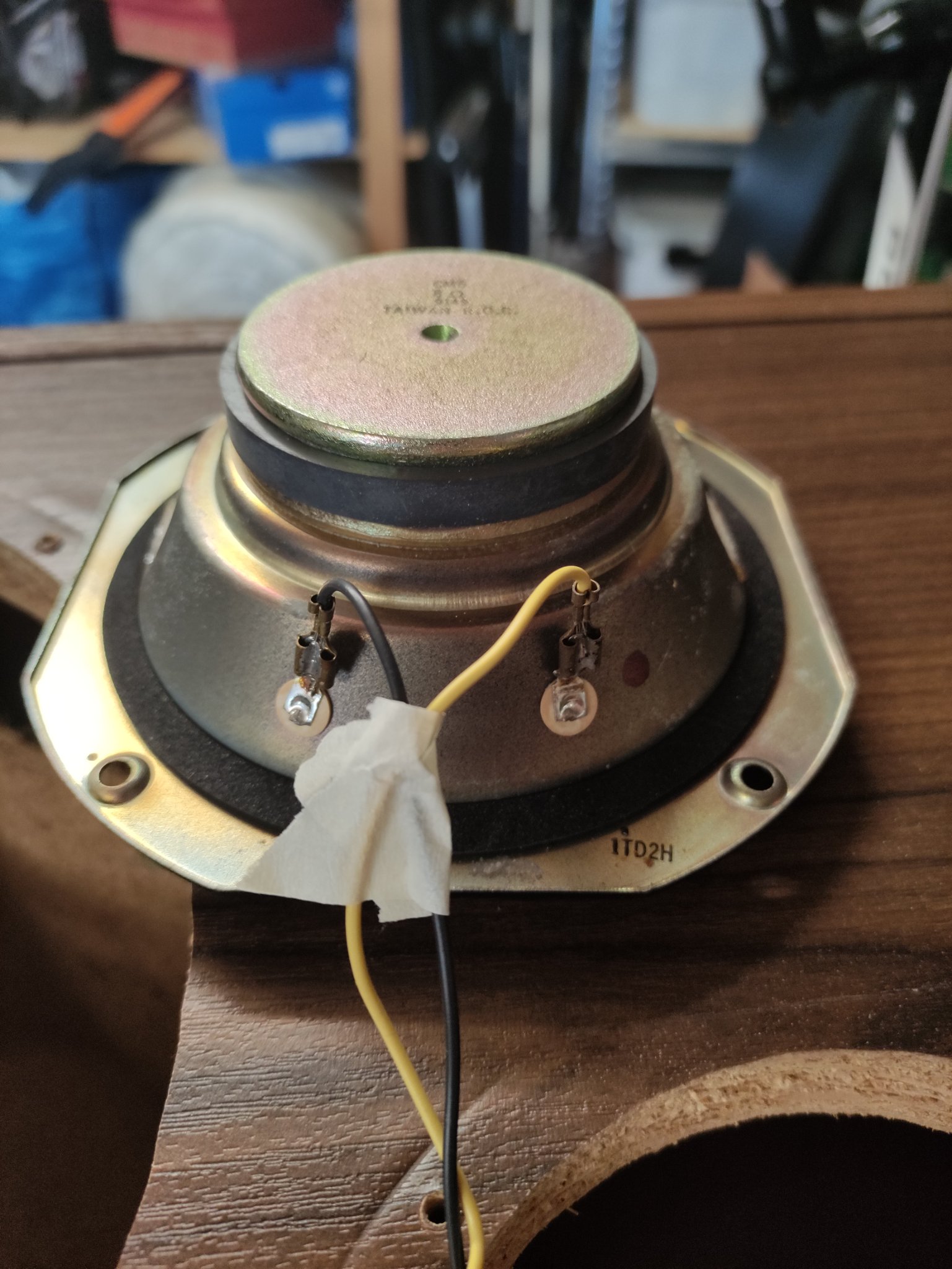

Found out that the midrange drivers polarity was reversed, meaning: not the same in each speaker.
Cant find any diagrams online. Does anyone know, wich is the correct wiring?

Not being able to see the complete picture, I can only suggest that the correct midrange driver polarity is the one that sounds best to your ears.
If I were choosing the colour coding, black wire would be my choice for connecting to the negative terminal - but that's just me!

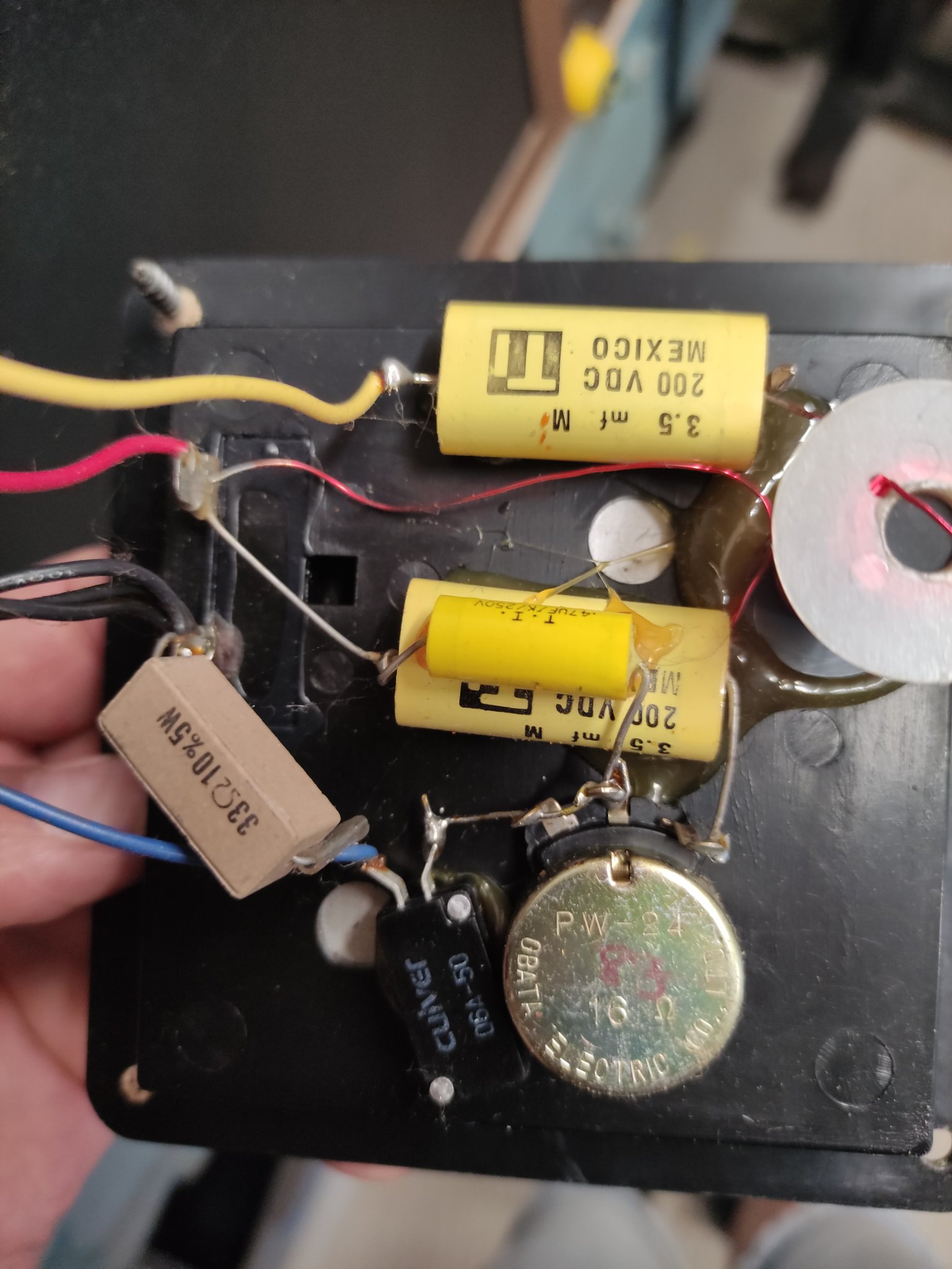

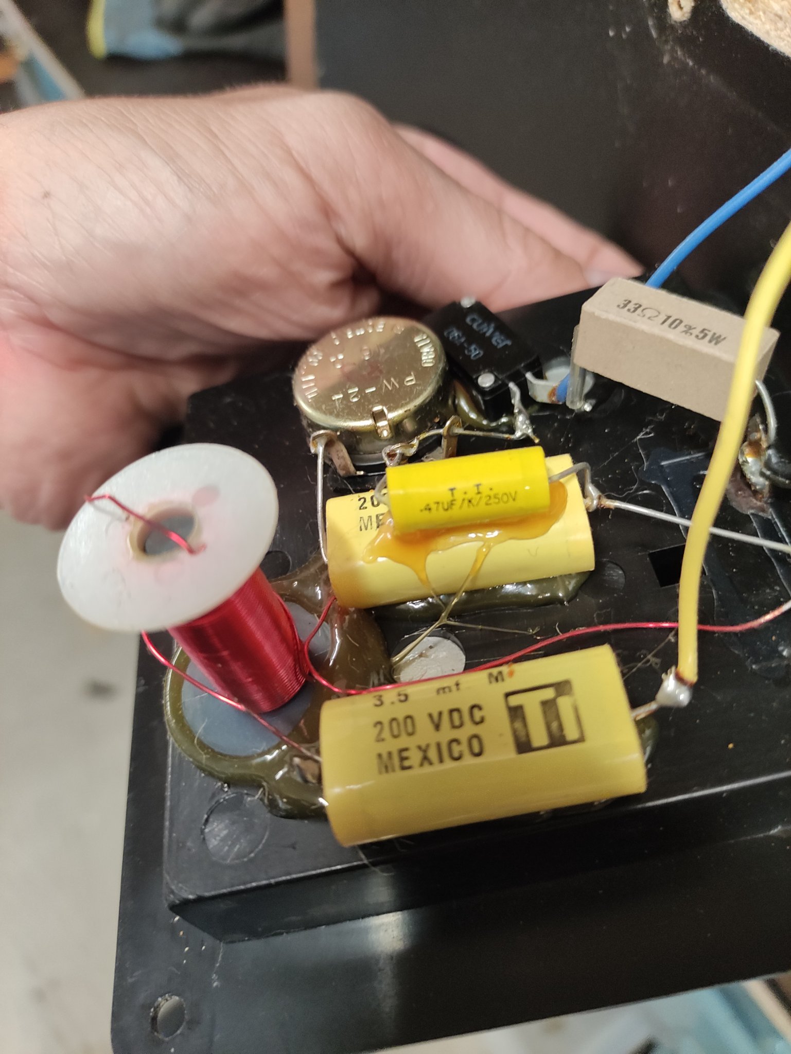

The Mid-Range is connected with reverse polarity on purpose. This avoids phase cancellation that would result in a big dip in the frequency response at crossover. I have the schematic for the D3 & D5 crossovers, but not the D6, which is quite rare.

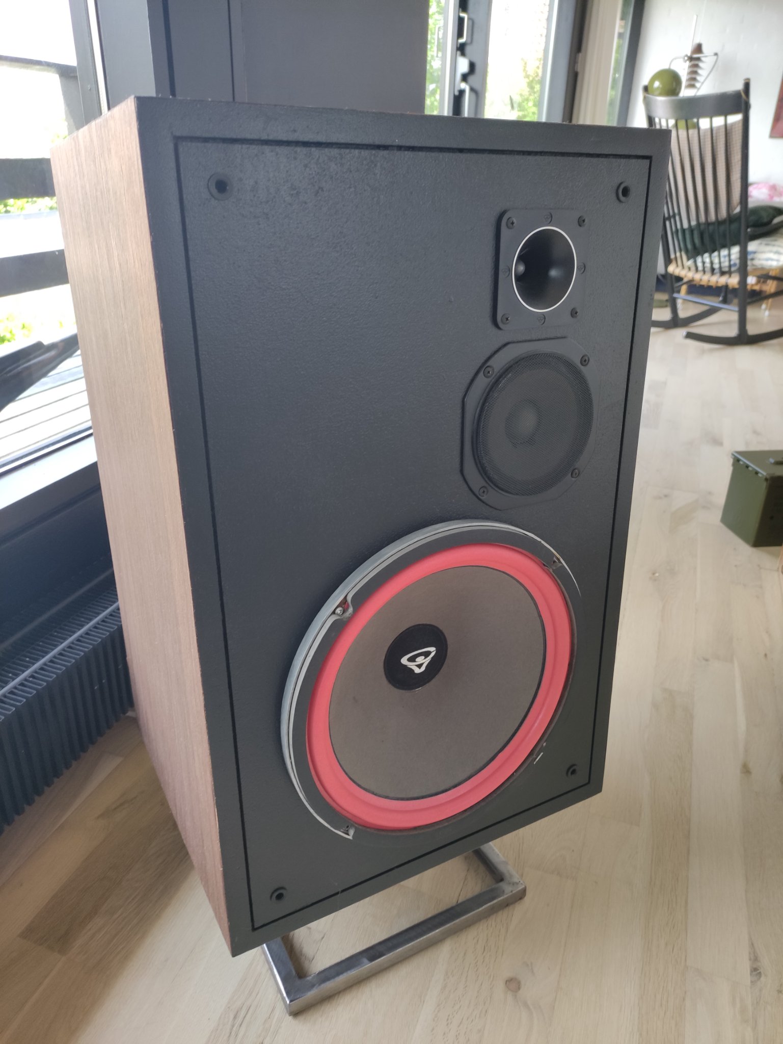

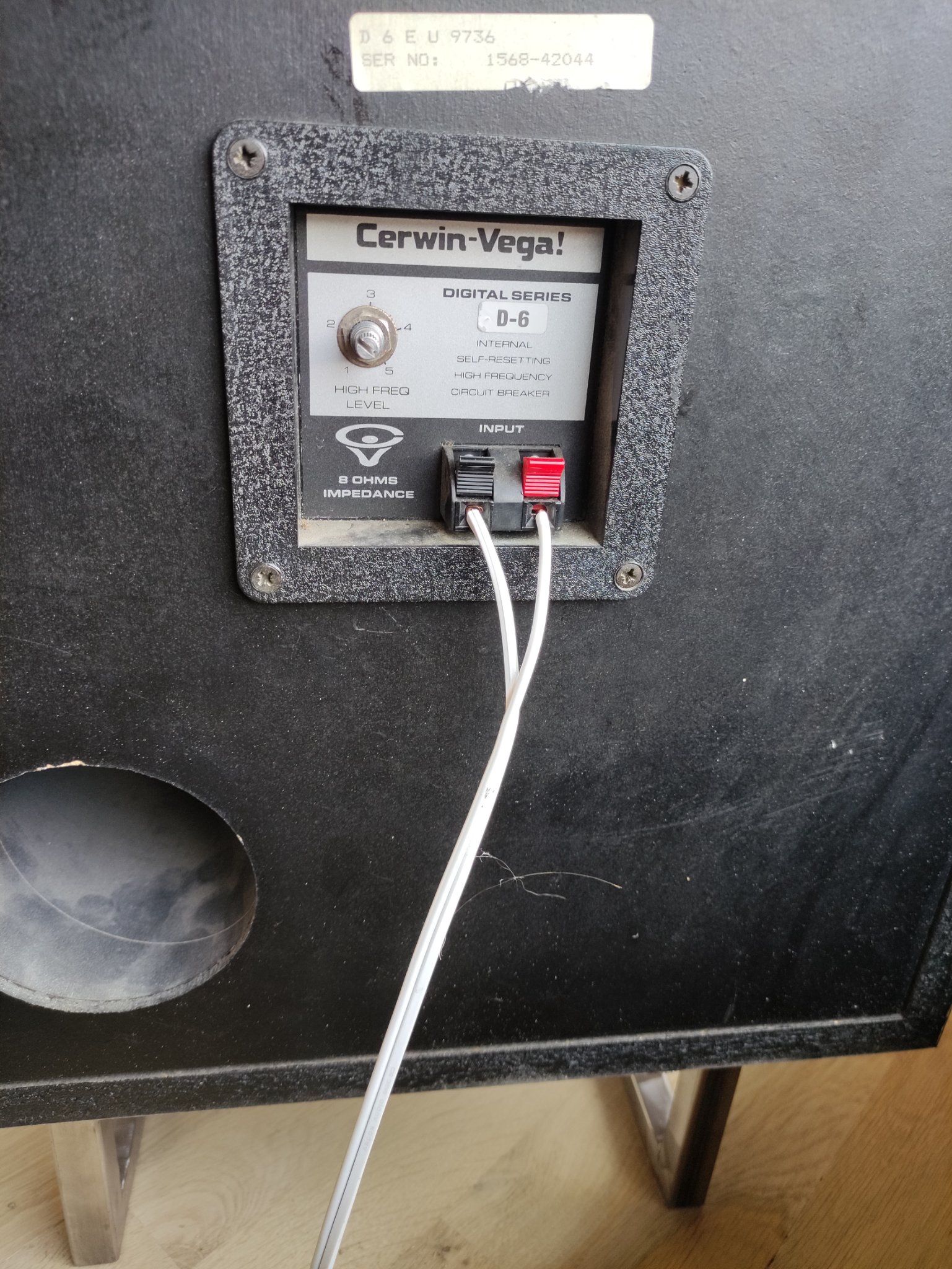

FWIW, here is the D3/D5 Crossover schematic. Note the straight wired woofer and reverse polarity on the midrange. Cerwin Vega speakers can thump pretty hard, but they were not known for their crossovers. Information on the D6 is scarce. Can you post pictures of the speaker, front and back, plus the crossover?
