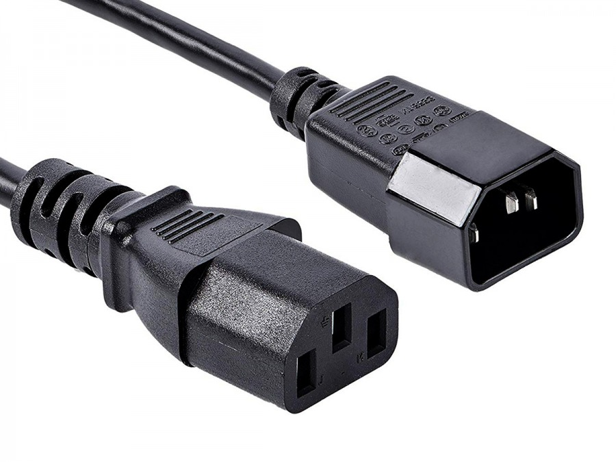

Reverse IEC connectors/cords?
Why are these available? Years ago I mistakingly ordered a couple of sets and can see no purpose other than offering up a chance to make a big mistake? That said, faston connectors fit the otherwise dangerous male pins on the cord which is coming in handy at the moment as I troubleshoot a piece of gear but is there a valid argument for their existence that I'm not aware of?
Obviously they are for mains outputs on equipment. For example, switched mains outputs for computer monitors on old-fashioned desktop computers.

As Marcel said, they were common on older desktop computers. I have some taken from older ATX PSU's when scrapping. The interconnecting cable had a 'normal' IEC plug on the other end to fit into the standard style IEC socket on the monitor, so really it wasn't so dangerous. AFAIK they weren't supposed to be used as an input, with a mains plug on the other end. I'm surprised you have such a cable!
These are used in rack mount PDU's. Mainly for rack mount servers. A 19" rack mount pdu will have a minimum of 8 of those sockets an RJ45 network connection and a breaker switch. Vertical ones can be 3-phase and support up to 60A distributed over 20 to 30 sockets or so. See companies like Eaton or Digital Loggers.
It's just a panel mount IEC power outlet.
Some equipment has convienence power outlets that use these instead of the standard outlet.
Although, their use doesn't seem to be very common.
Was definitely standard practice to have daisy chained switched mains outlets from an integrated amp, so the amp's switch turns off other equipment (often turntables which don't usually have mains switches of their own).
These IEC sockets must only be used as outlets, never inlets, you are expected to know this if handling electrical equipment. i.e. every mains lead must be plug one end and socket the other.
