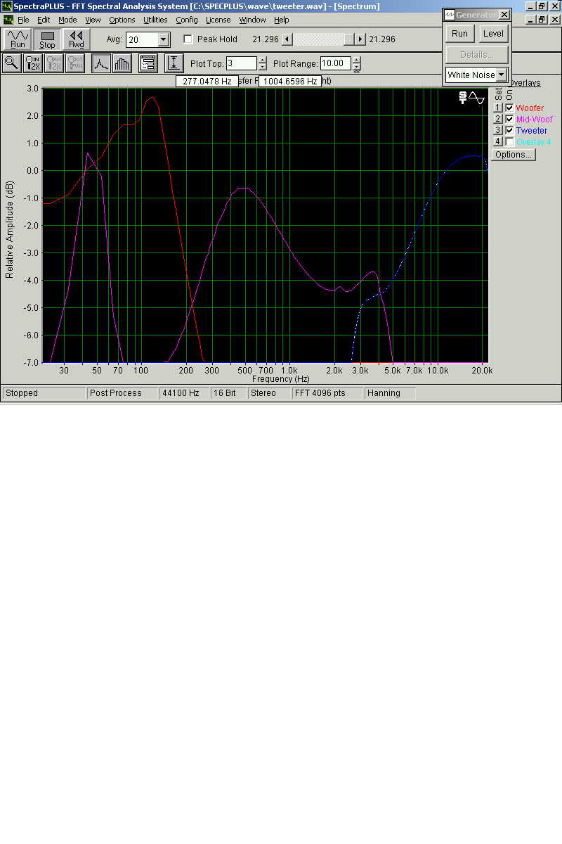

I have some results...
In the end, I went with the SpectraPlus software. It's an excellent tool, which I now recommend to anyone doing this..
It's just as well that I measured the crossover network's 3 separate responses individually. -- I would have been looking for a bandpass filter for the mid driver, when it actually only uses a low pass!! If I had been measuring acoustically it could have taken a long time to work that one out.
In case you're interested the filters seem to work out like this:
Two bass drivers: Low Pass, -3dB at 600Hz
Single Mid-Bass driver: Low Pass, -3dB at 6.5kHz
Singler Tweeter: High Pass, -3dB at 3.5kHz
Does that sound realistic?

Re: I have some results...
Doesn't make much sense but I'm not that familiar with the design and I've seen some strange designs, can you export and post the response curves? Have you traced out the schematic for the crossover, can you post that also?
They might be using overlap to make up for baffle diffraction loss, still there should at least be some high pass for the mid.

Oooops
I'm gonna have to re-run the tests!
I re-sized the Spectraplus window and now at the bottom of the window I notice that the my input signals were overdriving the measuring soundcard......I'll have to change the mixer settings and re-run the tests.....
Doh!
Doh!
Looks like you have a mid with rising response, so the higher frequencies are electrically rolled off. There may also be a notch around 2.2K for a resonance peak.
You now need to check the response with a measurement mic, as Bill suggested, to see how these electrical slopes correspond to driver slopes.

Steve,
I'm not sure why you're in the Post Processing mode looking at a wav file. You should be able to capture excellent curves in the realtime mode. Anyway, try expanding the vertical scale so you can see much more of the overall curve. You can also set FFT greater than 4096 which will give more resolution in the lower frequencies. You can let it average continuously if you want.
Davey.
