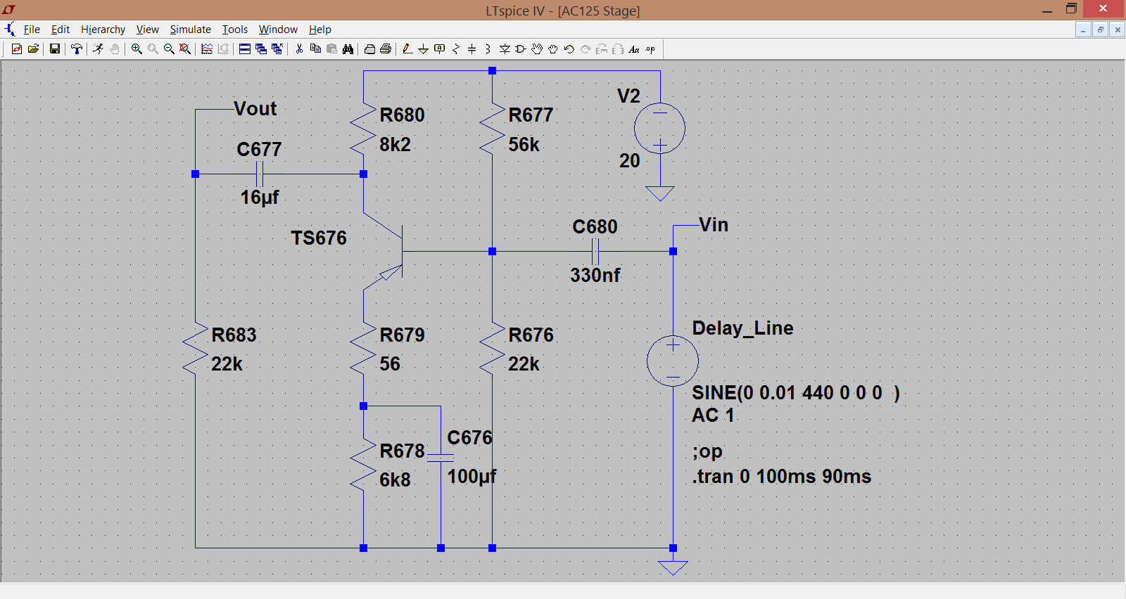

Hello all,
I have here an old Philicorda GM751 Philips organ of which the reverb is broken (it's not fully broken, it's just very very quiet), schematic of the amp section and reverb recovery is attatched. Now, when I touch the springs I can hear them rattling, but that rattling sound is much too quiet compared to when the reverb was still working. This makes me think the problem lies within the reverb recovery stage.
I've already replaced all electrolytics in the organ (and triple checked their polarity!) - by the way, already had this problem before I changed out all the electrolytics -, replaced C679, C680 and C681 (see schematic), measured all resistors in the reverb recovery stage (they measure out just fine) and replaced the AC125 germanium transistor as well. Also checked for cold solder joints (chop stick test) and broken wires, but no results.
Still no reverb, BUT... here's the strage thing and I discovered this by pure coincidence: when I connect a clip wire to ground (chassis) and touch the point where R678, R679 and C676 meet (so I actually short that point to ground) I hear a pop in the speakers and the reverb is back! Again, I didn't connect that point to ground, I simply touched it with the clip wire that is connected to ground. I replaced R678 and R679 just to sure, eventhough they measured out fine, but that didn't make any difference.

You have done all the right things so it looks like we need to dig a bit deeper. If the DC voltages around TS676 are correct in both faulty and working states then we need to look elsewhere.
Shorting the junction of R678/679 drastically alters DC conditions (abruptly) and that could just couple through to other stages and briefly correct a problem.
The switch SK10. Do you always get normal sound in the non reverb position ? Its not beyond the bounds of possibility that the switch could have a problem (tarnished contacts) and the abrupt change of DC conditions temporarily clears it.
The 87mv across B and E is a bit lower than I would have imagined for germanium... but not by much, so could well not be a problem. You've changed it anyway so we have to say its OK. Compare with the others for interest.

You could link the switch out to prove it conclusively, just link positive end of C677 to C651.
If you lift C680, then the base of the transistor will become very sensitive to hum and noise pickup... so you could 'buzz' that point with a screwdriver and see if you get lots of output.
If your DC conditions are correct around the transistor then its a fair bet its basically functional. If the collector is around -10 volts as shown then its going to be OK. I see there are AC125's in the power amp first stage. You could swap it for one of those if there was doubt.

We can use that to confirm what is happening at the AC125. This transistor is configured to give a voltage gain of around 80 (pretty high because the output of the spring line is very low).
There are two measurements to take, one looking at the output of the stage and the other looking at the input.
Here's what to do,
1/ Set the scope to AC coupling on its input.
2/ Set the sensitivity to a high setting such as 10mv per division initially.
3/ Set the timebase to a slow speed, somewhere around 1 to 5 ms per division.
4/ Connect the scope probe ground lead to any convenient ground point in the amp.
5/ Connect the probe tip to the collector of the AC125.

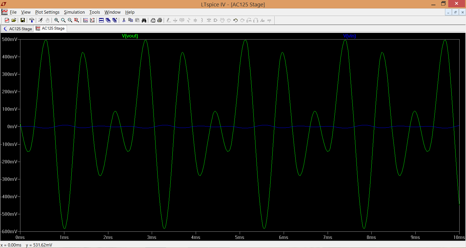

Now we test the scope by you playing a note around middle C and also by you using your 'shorting trick' to get it all to work. You should see the AC voltage displayed on the scope. Adjust the scopes sensitivity and the main organ volume control until you get a reasonably full display on the screen.
That gives us a working reference point.
When the fault appears you need to confirm that the AC voltage has disappeared. If it has then the fault is at or before this point. If it doesn't then its after.
Assuming its before then we do the same test but this time we try and look at the voltage on C680 direct from the spring line. This AC voltage will be around 80 or more times smaller, so turn the scope sensitivity up to see it and to gauge what its normal working level is. Again we compare faulty and non faulty states or operation.
Depending what this shows we can then move to the input of the delay line on R685. The voltage here will be much higher so turn the scope sensitivity down. Again compare working and non working states.
This shows you the kind of thing to expect. Notice the scale and how much gain the signal sees from input to output. The input voltage is in blue, the output in green.
