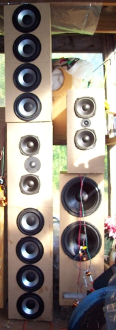

I finished testing the Dr. K's and found them too revealing. About 70% of my CD collection sound like trash on them, but the good Cd's sound most excellent on them. They have very low distortion motors on them for one thing. So now it's on to my Rock&Roll speaker design (project) so I can play the rest of my CD's....
