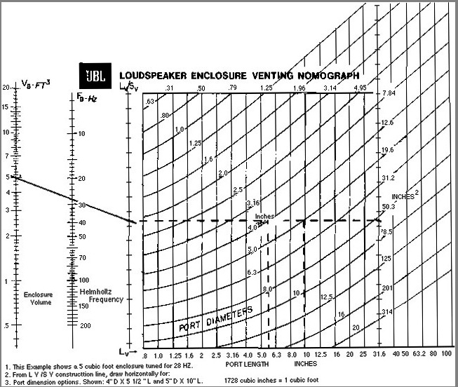

What kind (round, oval,rectangular) of ports are in the "not wood" boxes now? Can they be extended if need be to retune to the new 15" speakers T/S specs? What size are the boxes? What brand/model are the 15's and do you have measured or manufacturer T/S specs?
Can someone explain how to "Tune the box" to 20Hz or 25Hz?
What do you mean by small enough?
You can make a box tuning (Fb) of 20 or 25 Hz or any frequency you want using the JBL nomograph below.
Any port shape may be used, though keeping the port close to circular or square will result in results closer to the nomograph predictions.
After installing the ports, it is always a good idea to check Fb using a swept sine wave, the cone movement will be at minimum at Fb. Much easier to cut ports down than to make them longer, start a little long and cut them down till Fb is where you want it.
Lower Fb in the same size box comes with a reduction in SPL level, Hoffman's Iron Law.
Art Welter
Download a free box modeling software and learn to use it, like WinISD. You can enter the speaker parameters and find a driver that fits the box volume you have and add or mod the ports if present.
