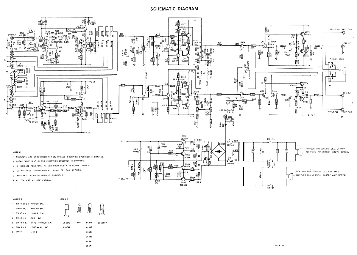

Hello, first post here. I can't seem to find on a thread on my exact topic, which seems fairly straightforward. As the title says, I want to update my old NAD 1020 with a motorized volume/remote. Installing the volume control itself seems straightforward but I'm stumped about how to get power to it. I want to tap into the preamp power supply and connect an LM317 for the 5 volts needed but am not sure what the best way to do this is (or even if this is the best option). I can post a schematic if that will help answer the question.

Service manual with Schematic for your pre-amp is available for free here; NAD 1020B Manual - Stereo Pre Amplifier - HiFi Engine

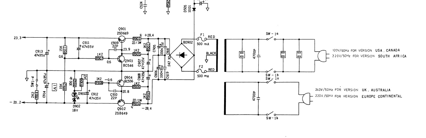

There isn't any 5v power in there right now, only +23.3v and -20.2v. I'd suggest if there is room in the amp housing to solder in and piggy back on the 120VAC switched output a small USB type power supply for your required 5v.
Cheapest solution is to pick off the AC output of the transformer secondary, after the fuses. Add a power resistor in series to drop the supply down to the required input range.
The MV02 requires Power supply : AC9-12V, 3Amp
